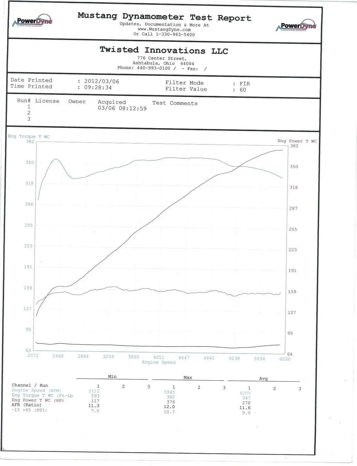

Update:
I took it to get tuned last night. It made 376RWHP / 362 RWTQ on a mustang dyno. That is right around 420 on a dynojet i think. I had them detune it. I ran out injector at 5960 rpm, it went from 11.5 af to 12.0 at 6k. Rev limiter is set at 6k, and I am comfortable pushing 60 rpm at 12.0
My tune idling at 700rpm doesnt cackle as much as sneaky's.
The overall sound of the car is nasty now though. When I lay in to it, it sounds sick. The SOP dyno feels great, although it's scary as hell when you lay into it in 4th at 75 mph and the car goes sorta sideways on an on ramp...
Video in the works; for now - dyno sheet.

Nice! I bet it feels good!
I'm gonna take a guess and say that you are a little disappointed in your numbers. I'm a great example showing that dynos are NOT accurate power measurement tools. They are TUNING tools. Don't get discouraged. Take it to the track, see how it does. I ran 11.94 @ 118.4 mph with "335" rwhp.....

I agree, dyno's are tuning tools and the track is the best place to gauge what it picked up. I am ok with the numbers, I figured it would make between 425 and 450, and after a 12% correction factor of a mustang dyno vs a dynojet, i am right around 425. Not to mention, that it did make more power with the a/f closer to 12 and timing @ 18*, I told him I wanted the a/f @ 11.5 and I wanted timing at 15*, i did not see the point in stressing my motor out for 15 more rwhp. Plus I already knew that I was going to get the magnapacks, and i figured that it would probably bring my a/f up to around 11.6 or 11.7 or so by going to a straight through design.
