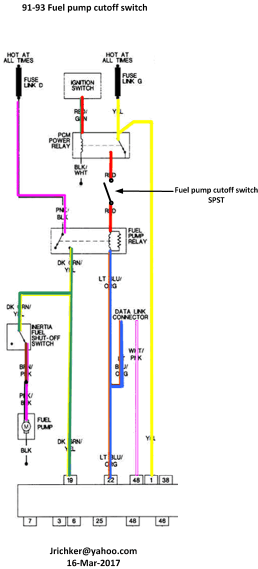

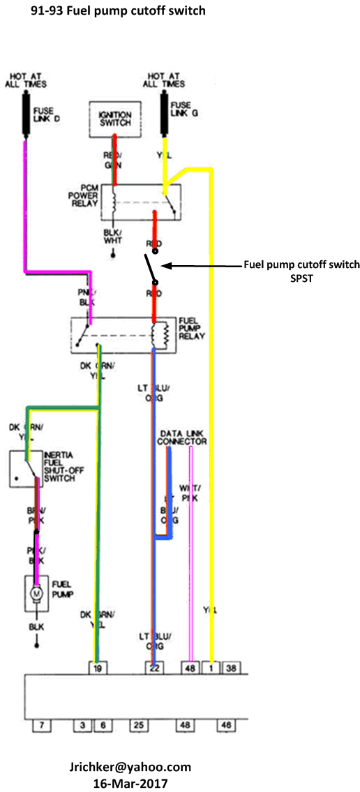

Follow this tech note for the best way to wire a fuel pump kill or anti-theft switch...
Note: this only works with full EFI systems. If you are doing carb equipped car, the wire colors and diagram will not work without modification.
Revised 16-Mar-2017 to change wire color and add 91-93 fuel pump wiring diagram.
Note: Use automotive gauge wiring that is rated for 105° C. The wire spool will be marked and the wire may also be marked. The higher temperatures that automotive wiring is exposed to makes this a necessity.
On 86- 91 cars the fuel pump relay is under the driver’s seat, 92 and later cars, the fuel pump relay is under the Mass air duct on the passenger fender well.
Note that the wire colors changed in 1991, so there are two different descriptions.
86-90 model cars:
Cut the Red/Black wire going to the fuel pump relay. Splice a 16 or 18 gauge wire into the wire and connect it to one side of the switch. Connect the other side of the switch to the other end of the red/black wire going to the fuel pump relay. When you are done the switch should be in the middle of the spliced Red/Black wire that goes to and comes from the fuel pump relay. Using the control side of the circuit allows you to use light gauge wire and light duty switches. There is less than 1 amp going through the circuit, so you don’t have to worry about voltage drop across the wiring depriving the fuel pump of electrical power.
attachment.php
91-93 model cars:
Cut the Red wire going to the fuel pump relay. Splice a 16 or 18 gauge wire into the wire and connect it to one side of the switch. Connect the other side of the switch to the other end of the Red wire going to the fuel pump relay. When you are done the switch should be in the middle of the spliced Red wire that goes to and comes from the fuel pump relay. Using the control side of the circuit allows you to use light gauge wire and light duty switches. There is less than 1 amp going through the circuit, so you don’t have to worry about voltage drop across the wiring depriving the fuel pump of electrical power.
The design of this plan doesn't require an expensive or heavy-duty switch. It just needs to be reliable and able to withstand being turned off and on frequently. When you turn it on, it needs to stay on and not turn off . This type of switch is labeled SPST (single pole, single throw). It is a NOT a momentary contact but a constant contact type switch.
Most push button switches and switches that spring the handle back when you let go of it are momentary contact switches. These will not work for a for a fuel pump kill switch.
More information about switches is available at https://learn.sparkfun.com/tutorials/switch-basics/poles-and-throws-open-and-closed

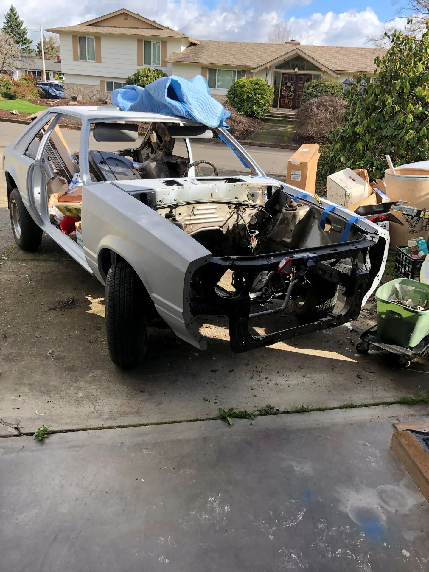

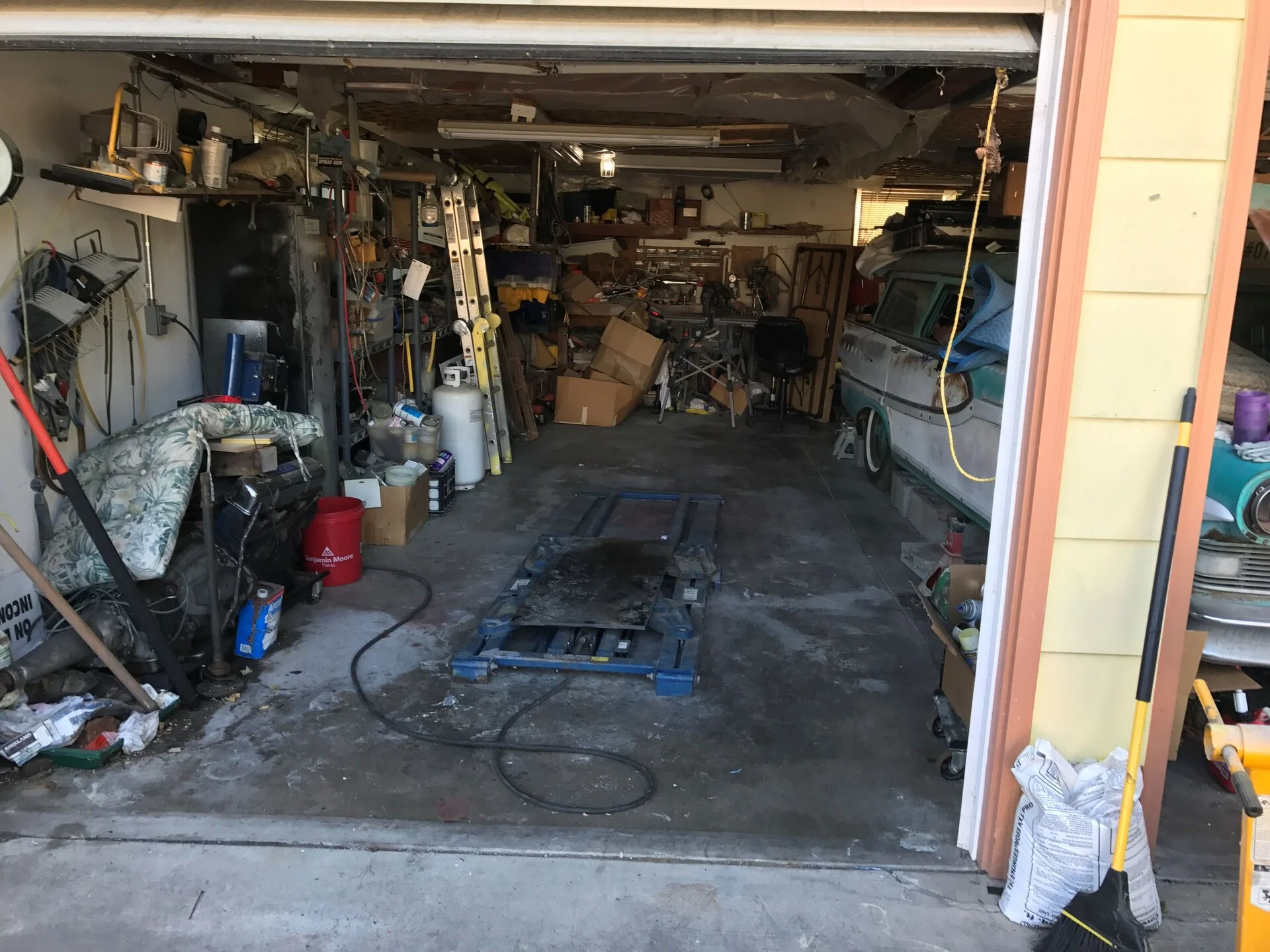

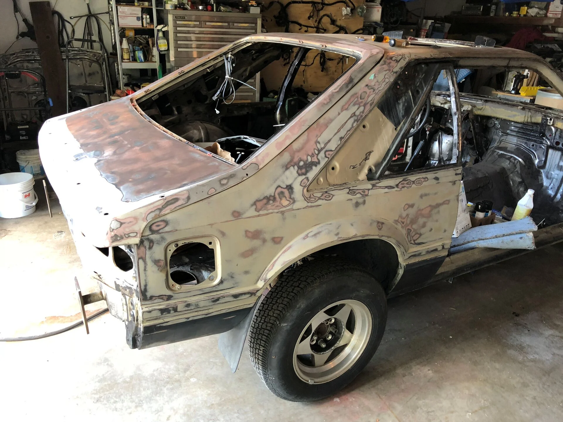

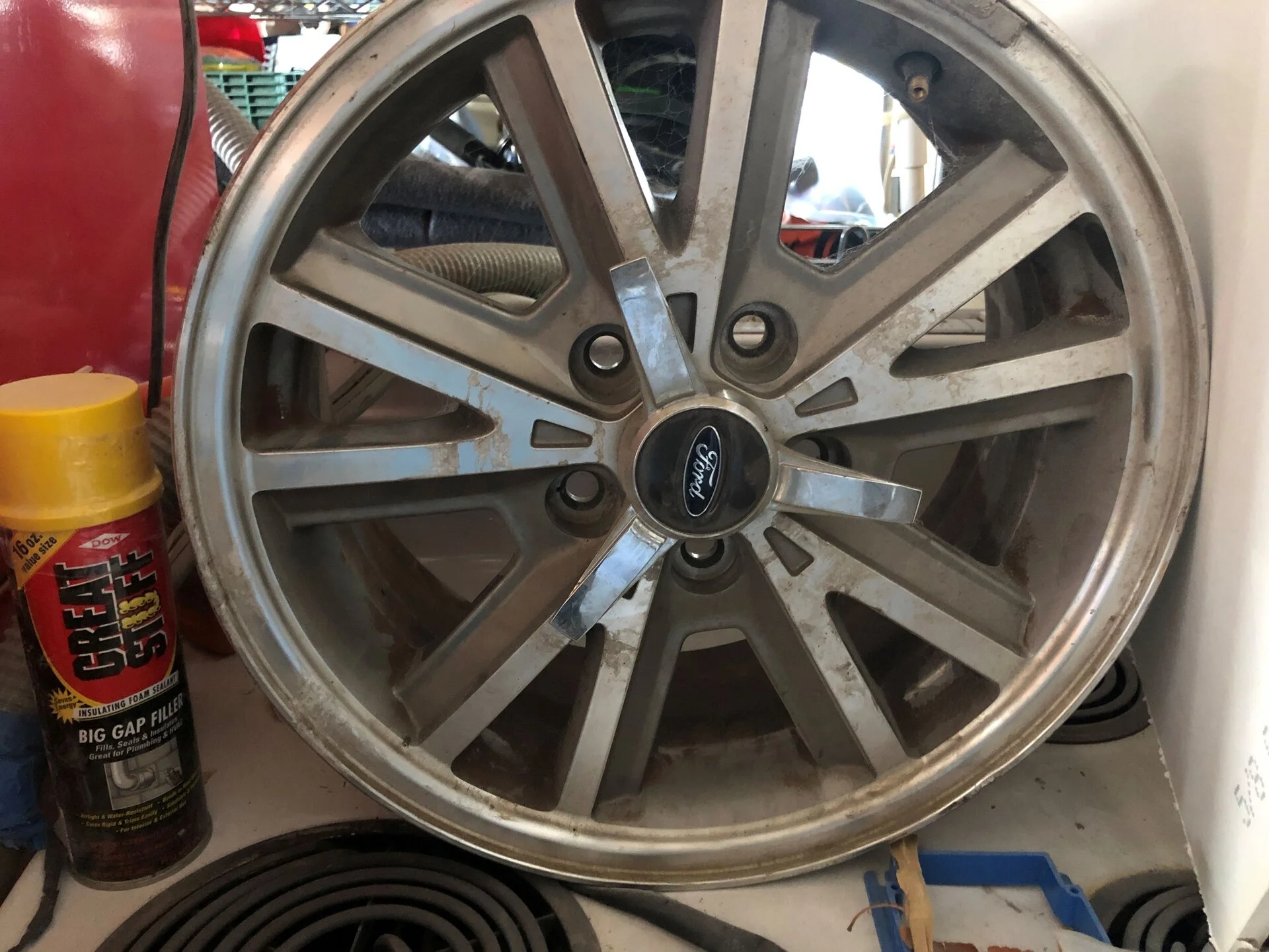

Here are some photos showing my Pace Car and the progress and parts so far. I did most of the body work last summer. Waiting for warm temperatures to begin paint. Also still thinking about color. OEM pewter or Ford Lazer Red....Any inputs feel free.........GREEN is not in the mix. Have a set of rims I was going to use on my Monroe Handler. Kept them for this. can not remember what year these came off. Got them at a local yard. Even found the centers. I do have a lift in my garage. Note the EDSEL. Moved lift to center space. Finishing engine this week. Then starting on interior parts then rewiring dash and custom instruments using VDO gauges.. So far so good. Larry
