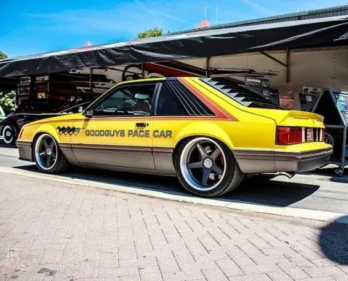

I vote for the stock pewter. It stands out in a way another color won't unless it's absolutely perfect. Also, you can go with a Holley Sniper for ~1000 that looks like a carburetor, but performs like fuel injection.
I wanna see it in light blue with bottom charcoal and factory sticker package
can someone do that 'computer stuff' and show it?
The pace car not Pugsly...

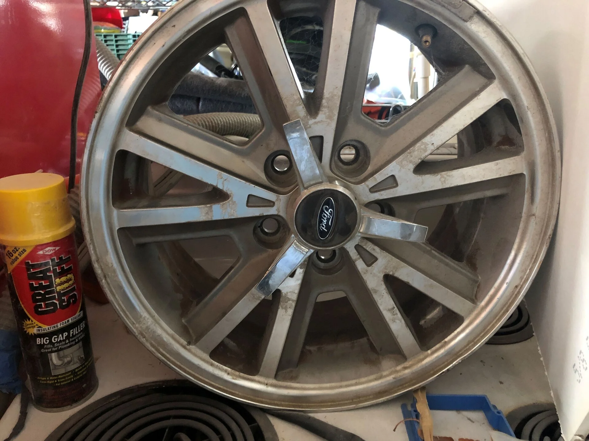

RIMS: I am starting on several projects before painting the body. Attache find the rims I purchased for my five bolt conversion. 16 Inch OEM Mustang rims. I really do like these. Have OEM Mustang spinners. I also have the OEM 79 rims that came with the Pace Car. Both sets need to be restored. So, as I have been convinced to use the stock color, should I stay with the stock rims? I like the stock rims, but with changing the color though I should change the rims. Lots or work redoing either, so the answer is??? Larry

Planning ahead: How do I know how much paint is required? I have a sun roof. I figure 3 quarts which ends up at 1.5 gallons should do it. Complete body; engine compartment, door jams, inside the body etc. Since I am asking. What color engine would look good? Basic Ford blue? I am cleaning the engine compartment up, filling unused holes, making panels smooth, that sort of thing. Oh one more thing. I have a set of Edelbrock Alum valve covers. Have had them for years in a box. Finally opened the box and.......I find the hole around the oil cap has some broken bits. IS there something that would repair this without worrying about it melting and have the bits fall off into the head? When I put the parts into the head, the cracks do not show. Hate to throw them away. Thanks muchly, Larry. Getting very warm here. Pugsly has found a new place out of the sun to sleep all day outside..
