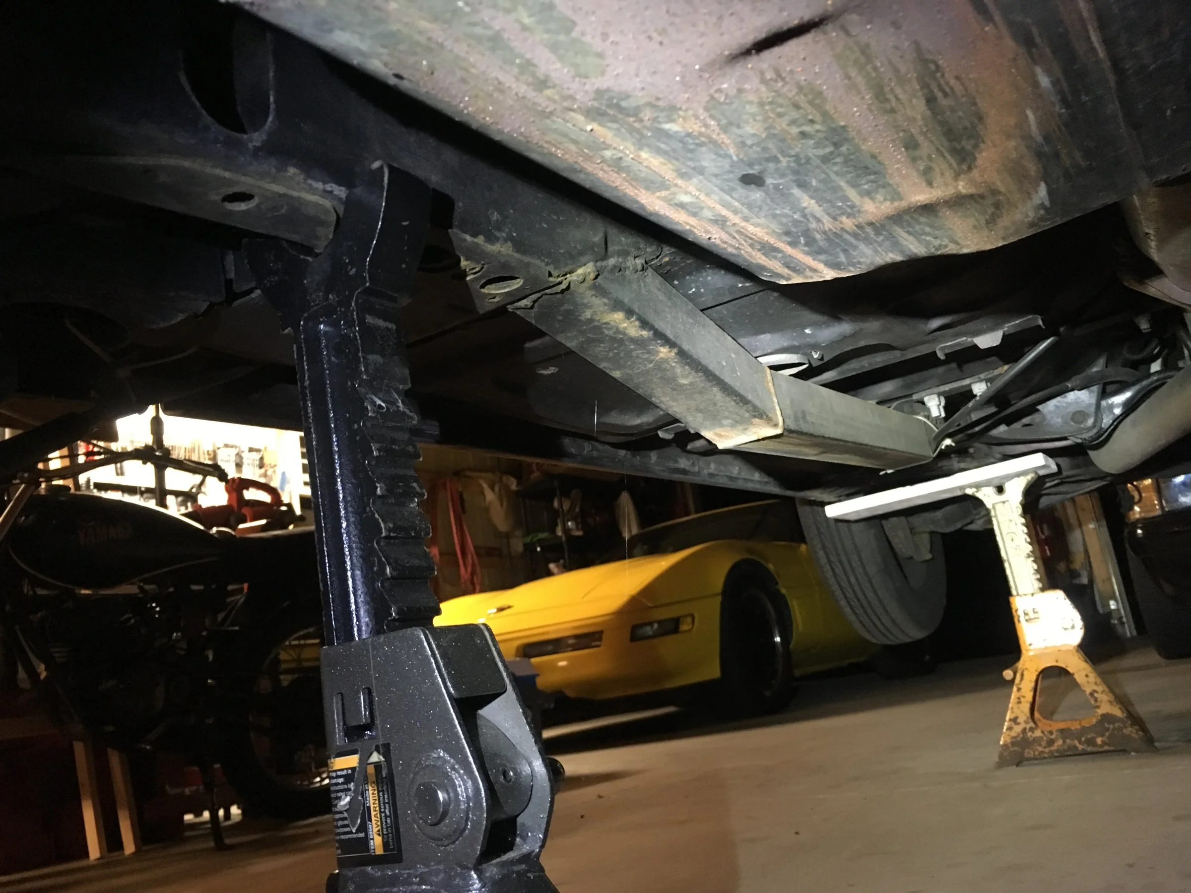

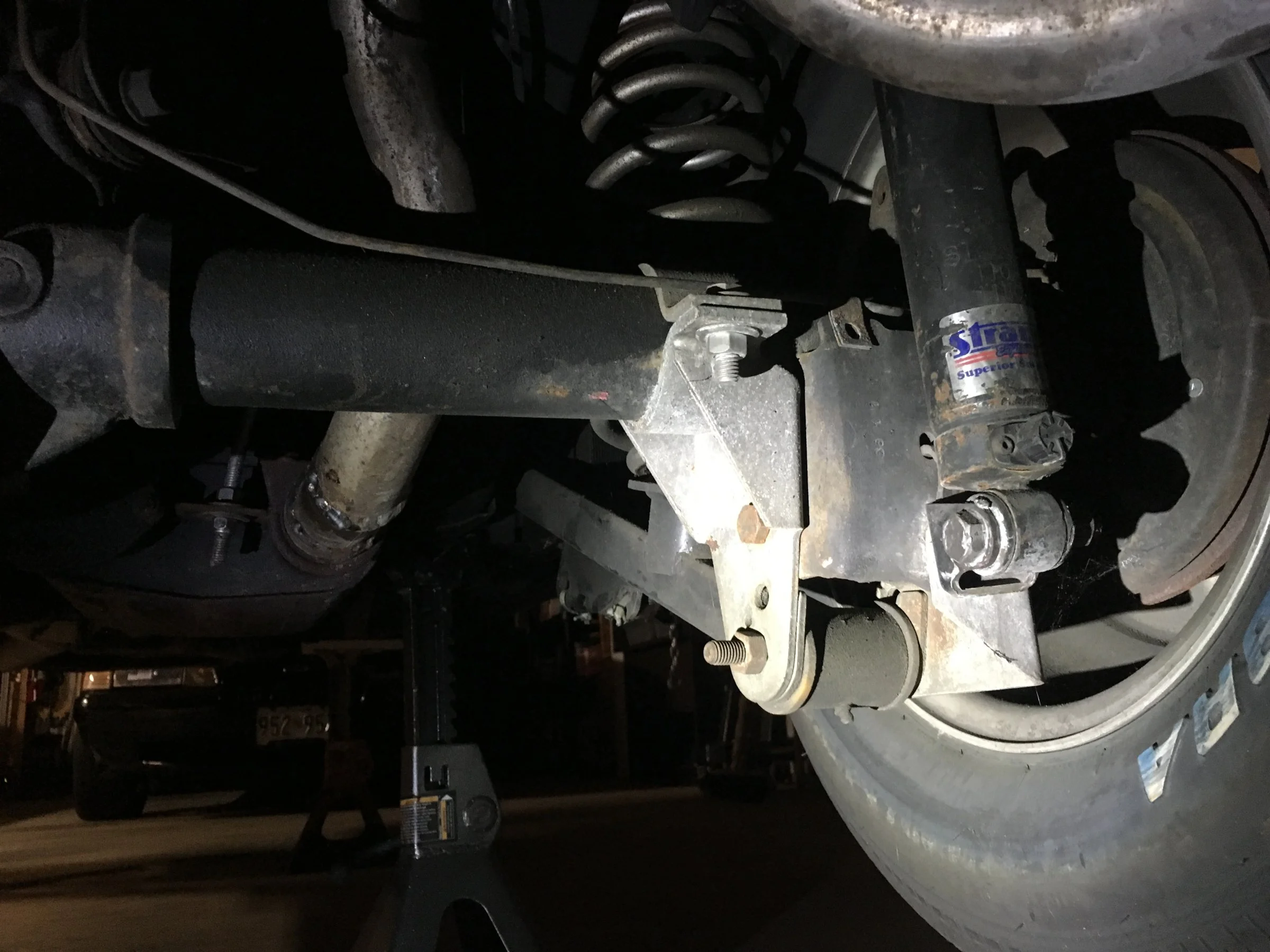

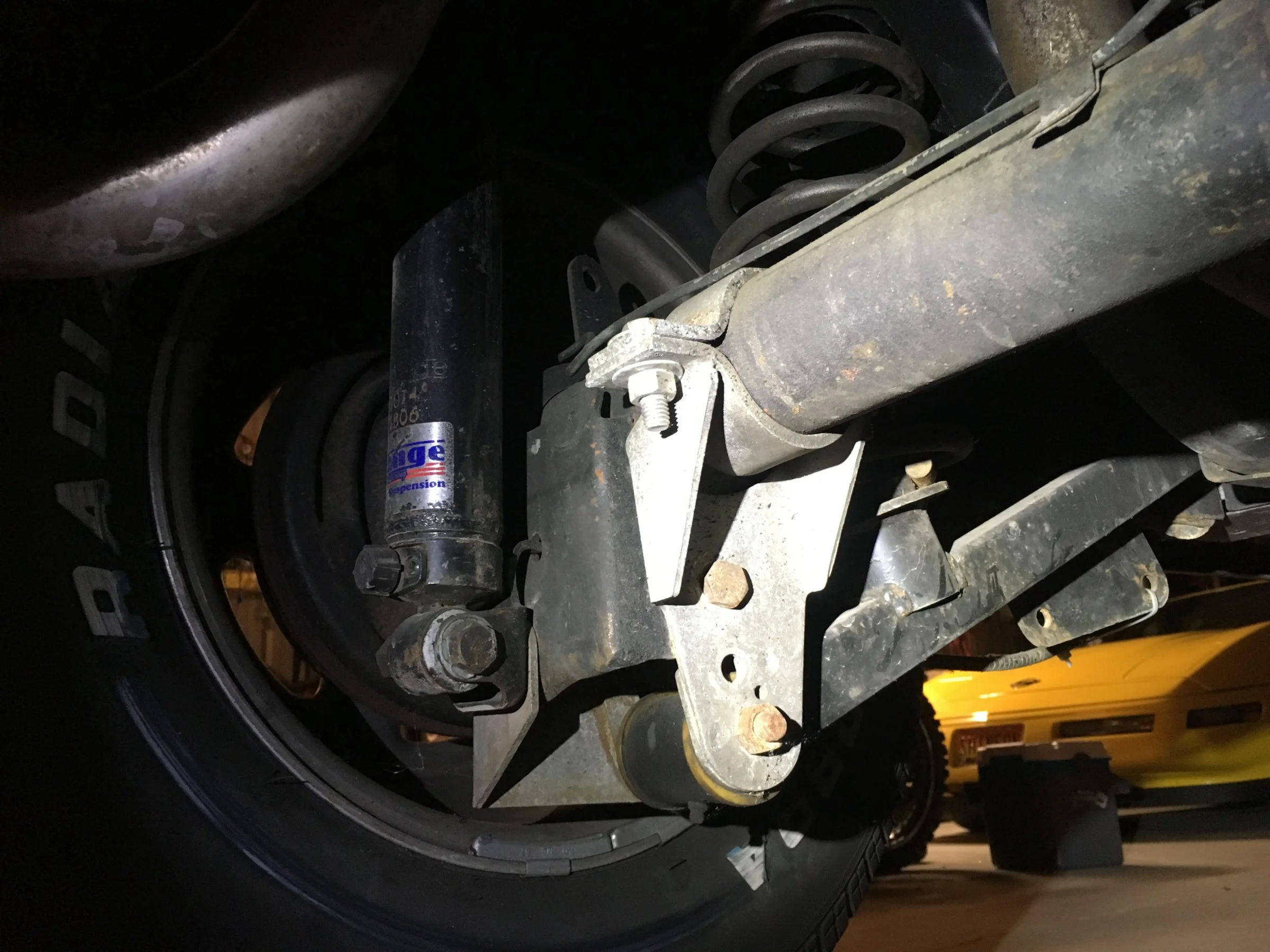

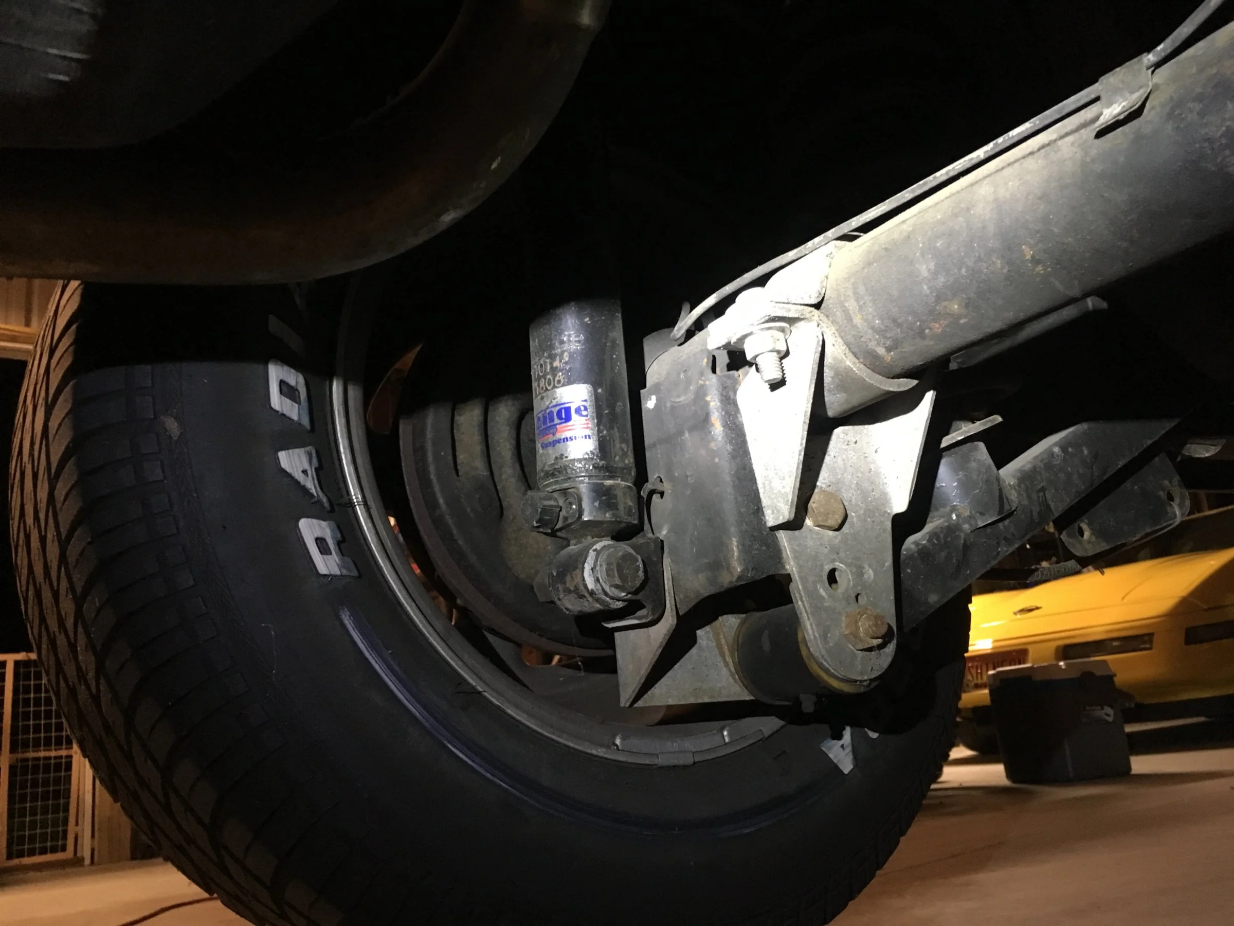

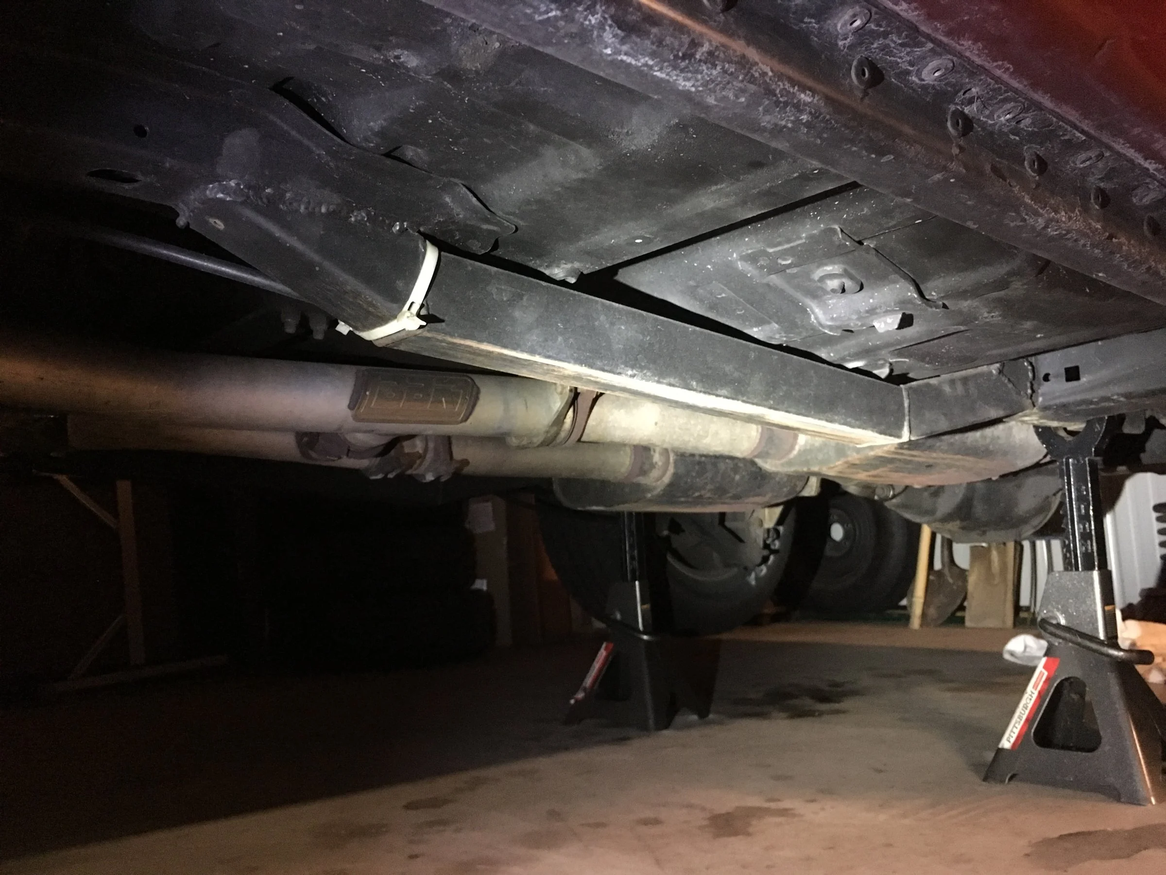

I'm looking for id on aftermarket suspension parts on a 93 convertible. The pictures show. These are aftermarket subframes correct? What kind?
Also, rear control arms are obviously dropped with brackets. Any idea what brand they are or what they're worthy of?
The Tq boxes look good.
I may be returning this suspension back to stock form. Or at least stock ride height and ride quality. Right now it's low and rough. Way too stiff in the front especially

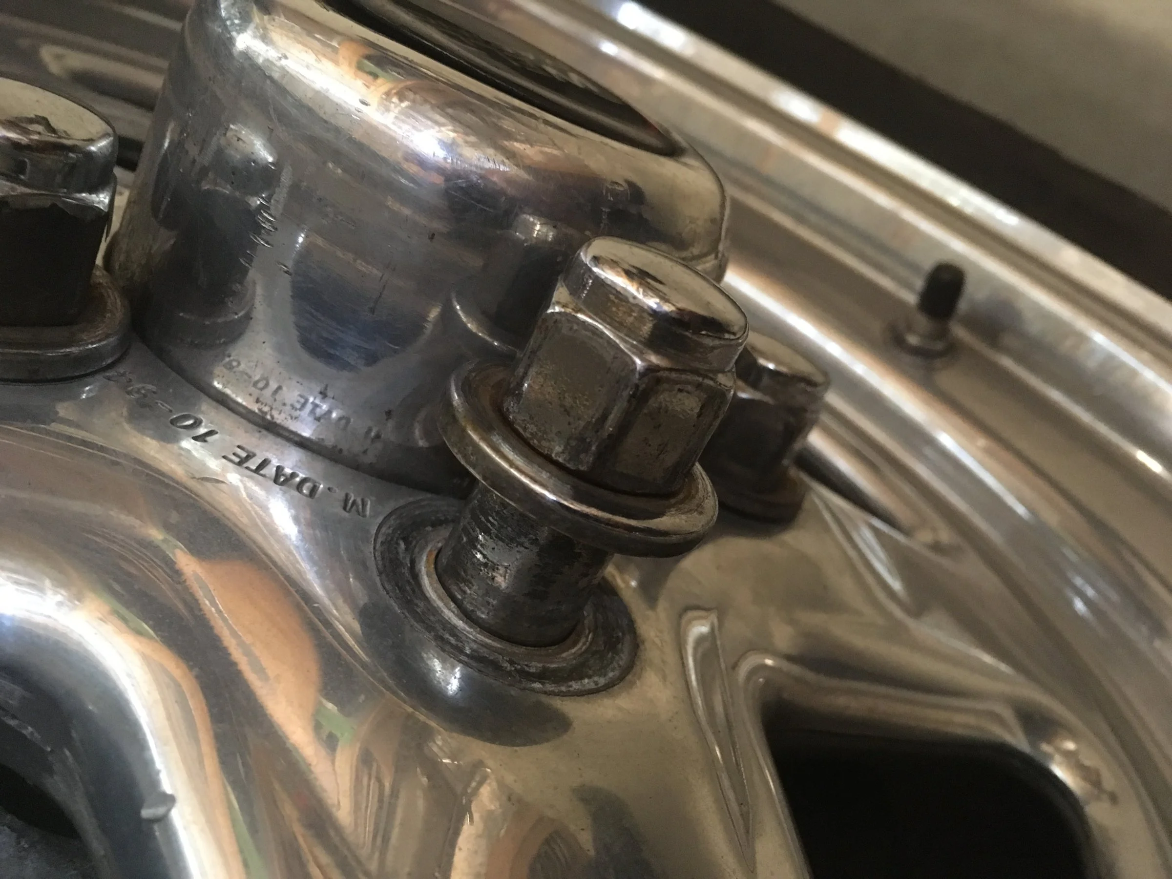

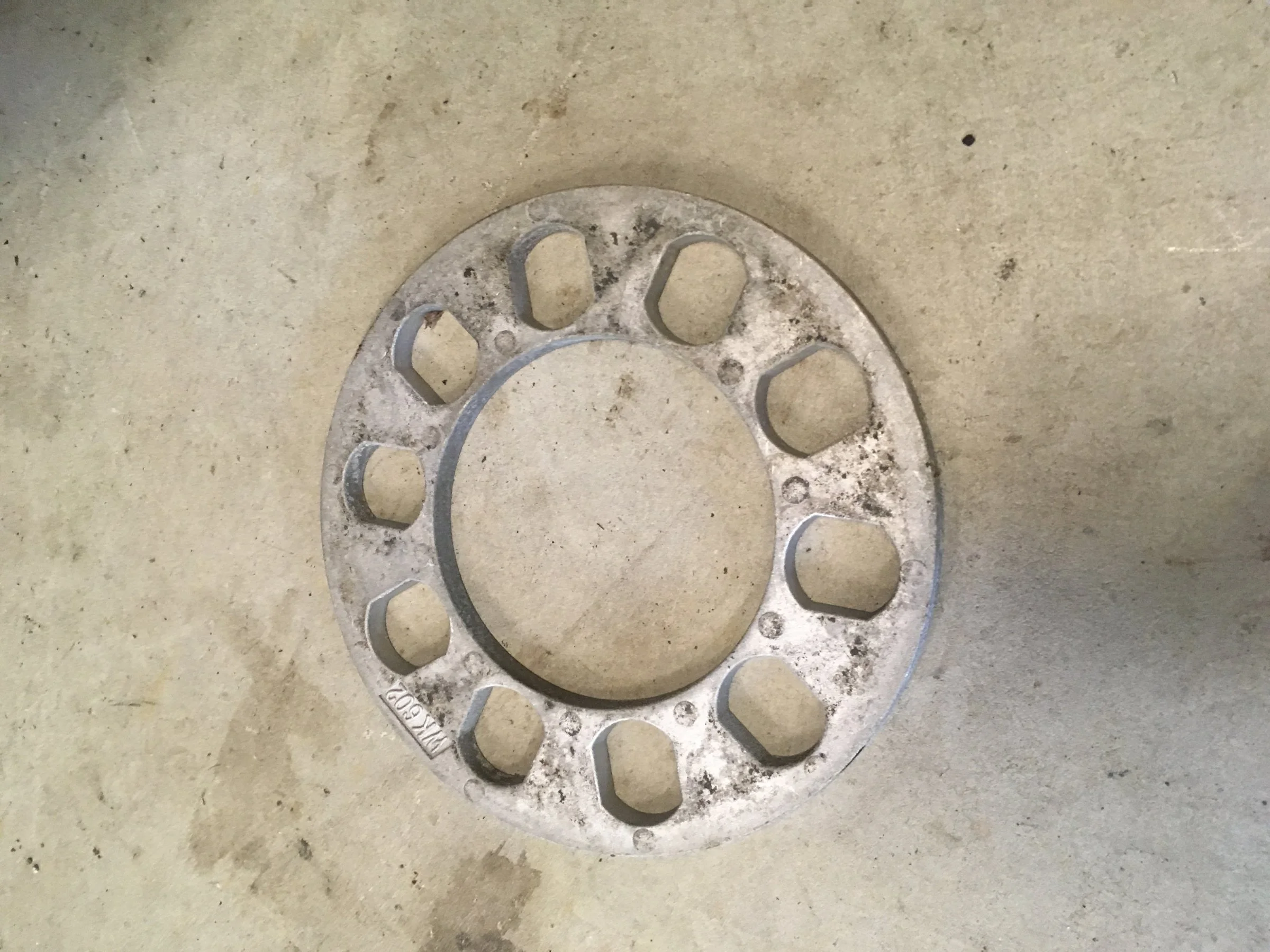

With my rear weld prostars i need to run 1/4" spacers to clear the quad shocks, even with the quads flipped around. I have lugs with 1.367" shank length. At least 5/8" of the shank will engage the hole when tight and I will have at least 14 full revolutions of thread.
Am I safe? Just double checking since I've never run spacers before. It's for a street driven normal use only. No extreme racing or stick slicks.
Deleting the quads is not an option by my choice.

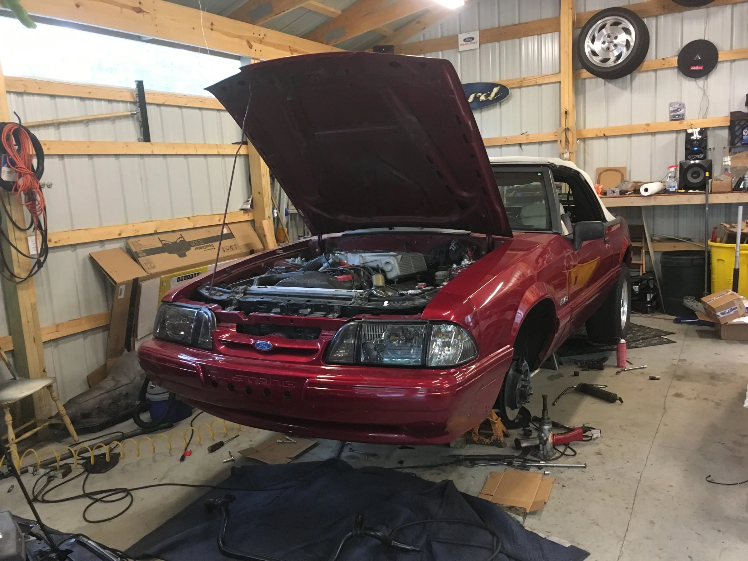

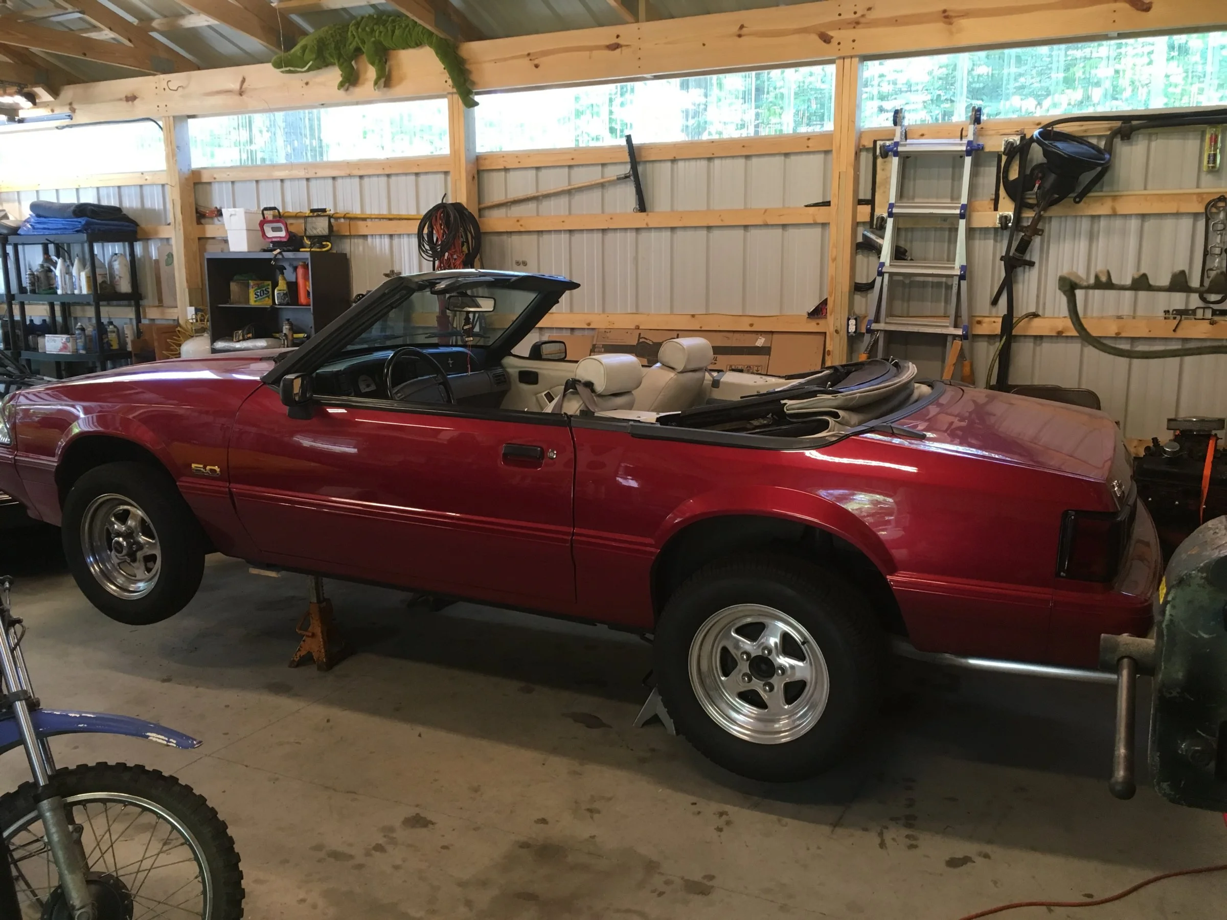

I've removed Lakewood traction bars, installed stock springs front and back, added missing sway bars and quad shocks, replaced leaking rack with new 2.25 turn unit, new tie rod ends, new rear wheel cylinders, new rear brake cables, rebuilt front calipers, replaced incorrect caliper pins, replaced missing front dust cover, replacing missing front bumper support, replaced door hinge pins, will be replacing x303 with stock HO cam and reverting ECU back to stock with o2's back online (currently missing).,
I need to undo a hack engine harness tuck job and fix various other electrical stuff too. AOD is having overdrive holding issues so thats on the list too.
I'm keeping it for now but when I'm done, I'll feel confident if I do sell it, somebody will be getting a decent car.
