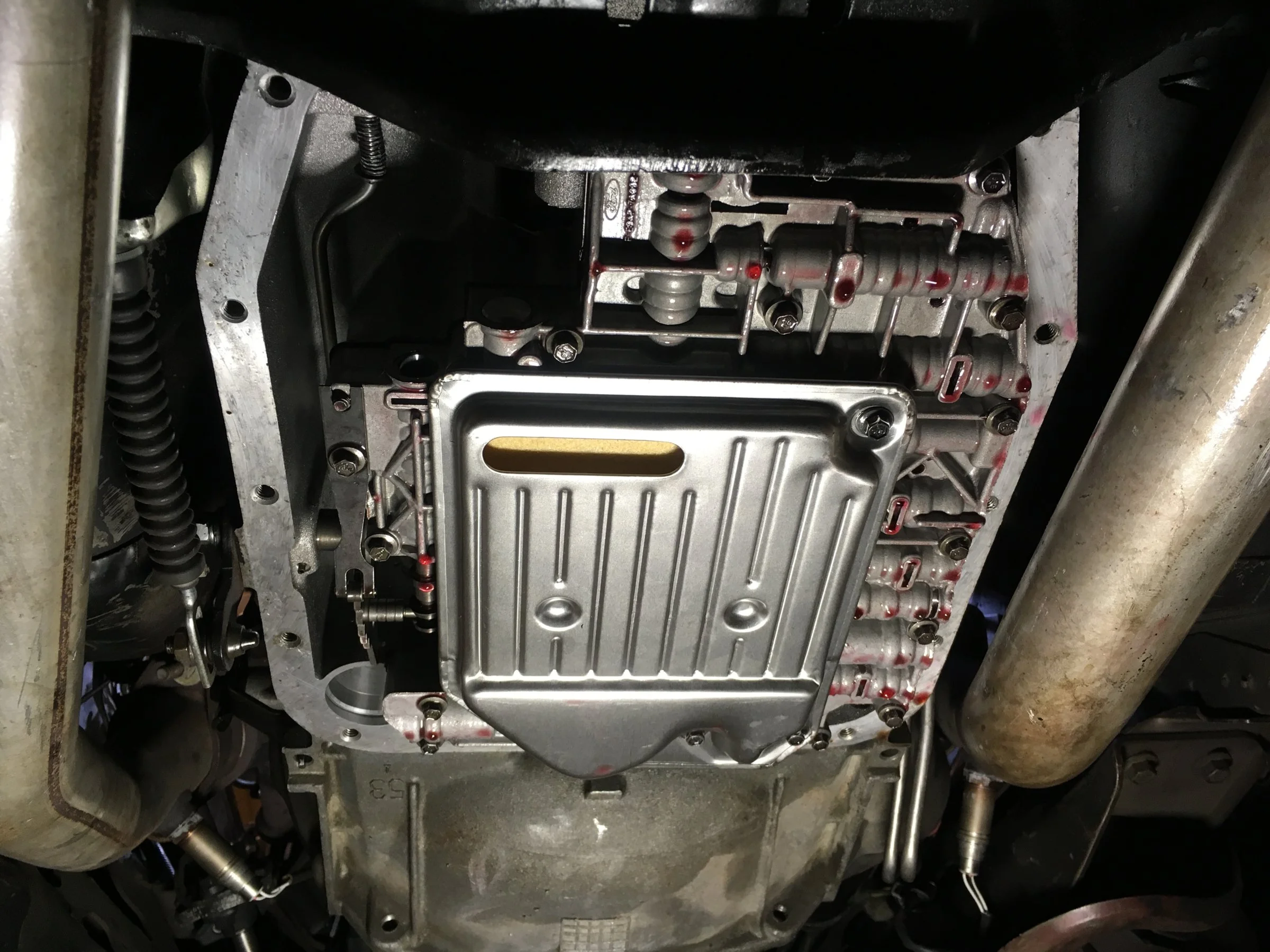

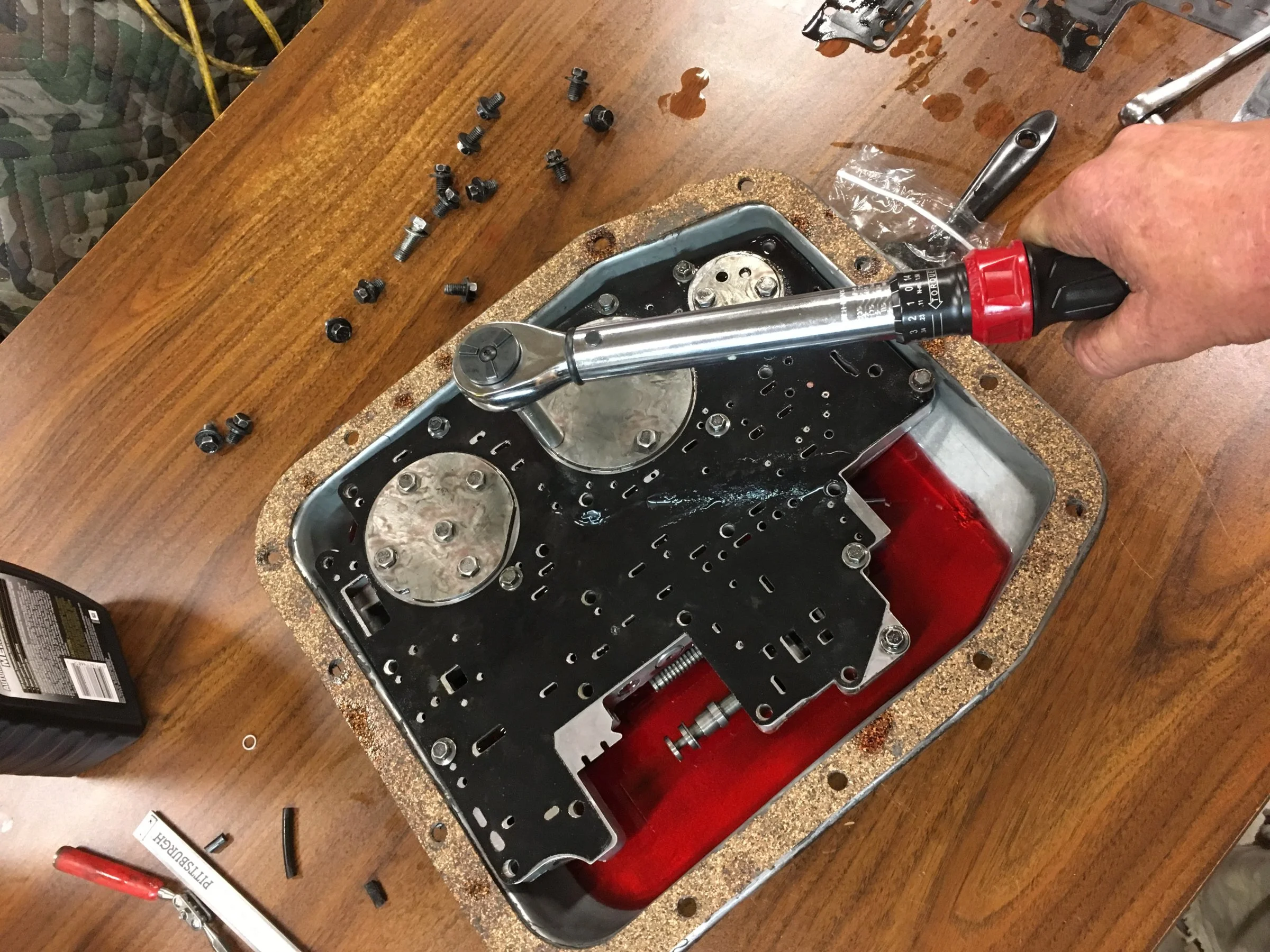

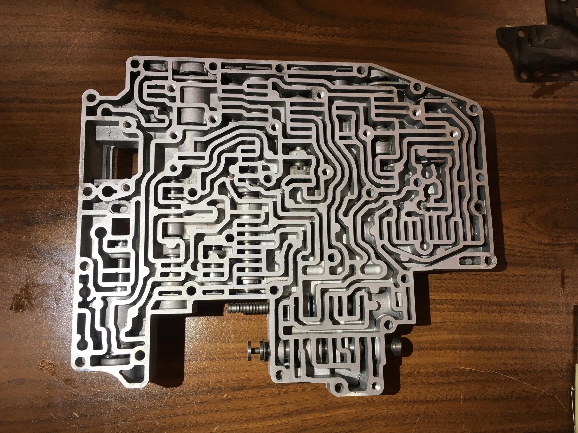

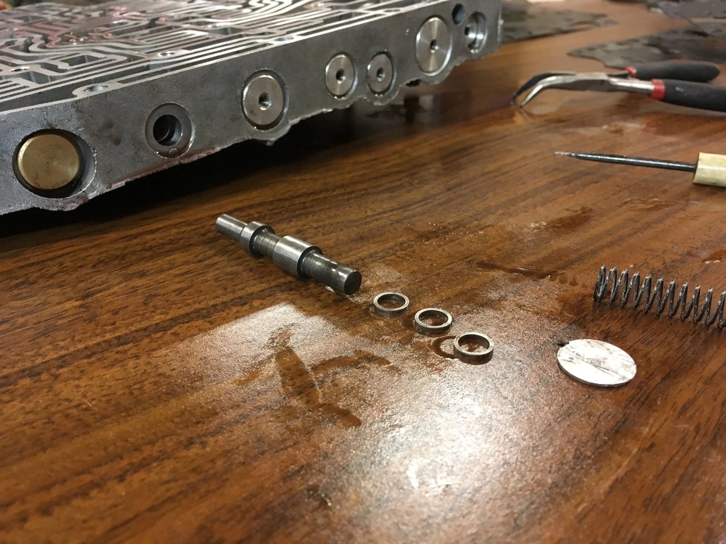

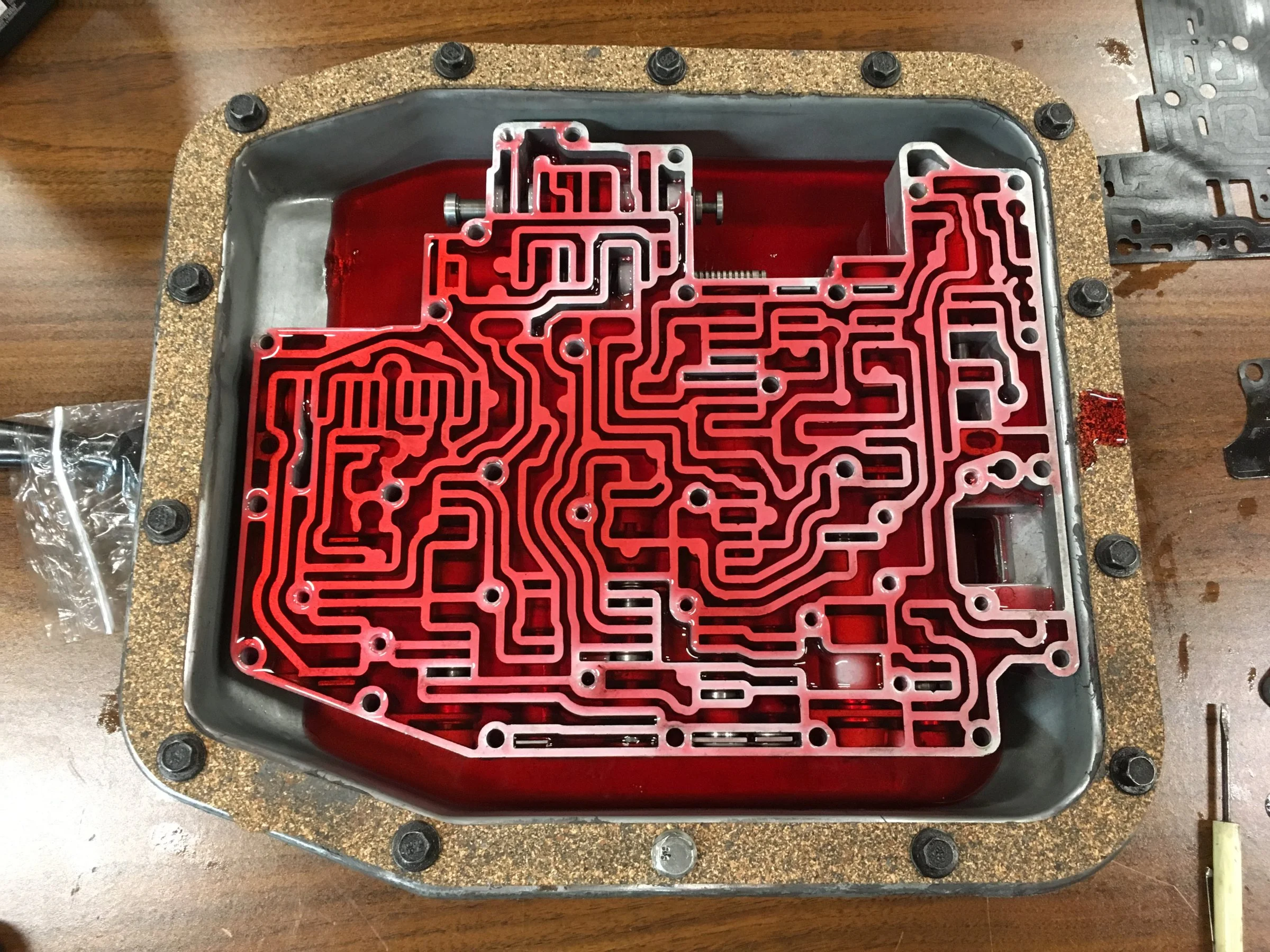

Pic 1). Removed one of the three spacers to drop WOT up shifts by approx 500 rpm. Pic 2). VB assembled and clean. Pic 3). Poured fluid on and let it soak. Pic 4). Tourqued plate bolts to spec 90 in/lbs. Pic 5). VB and filter in and torqued to spec 90 in/lbs.
