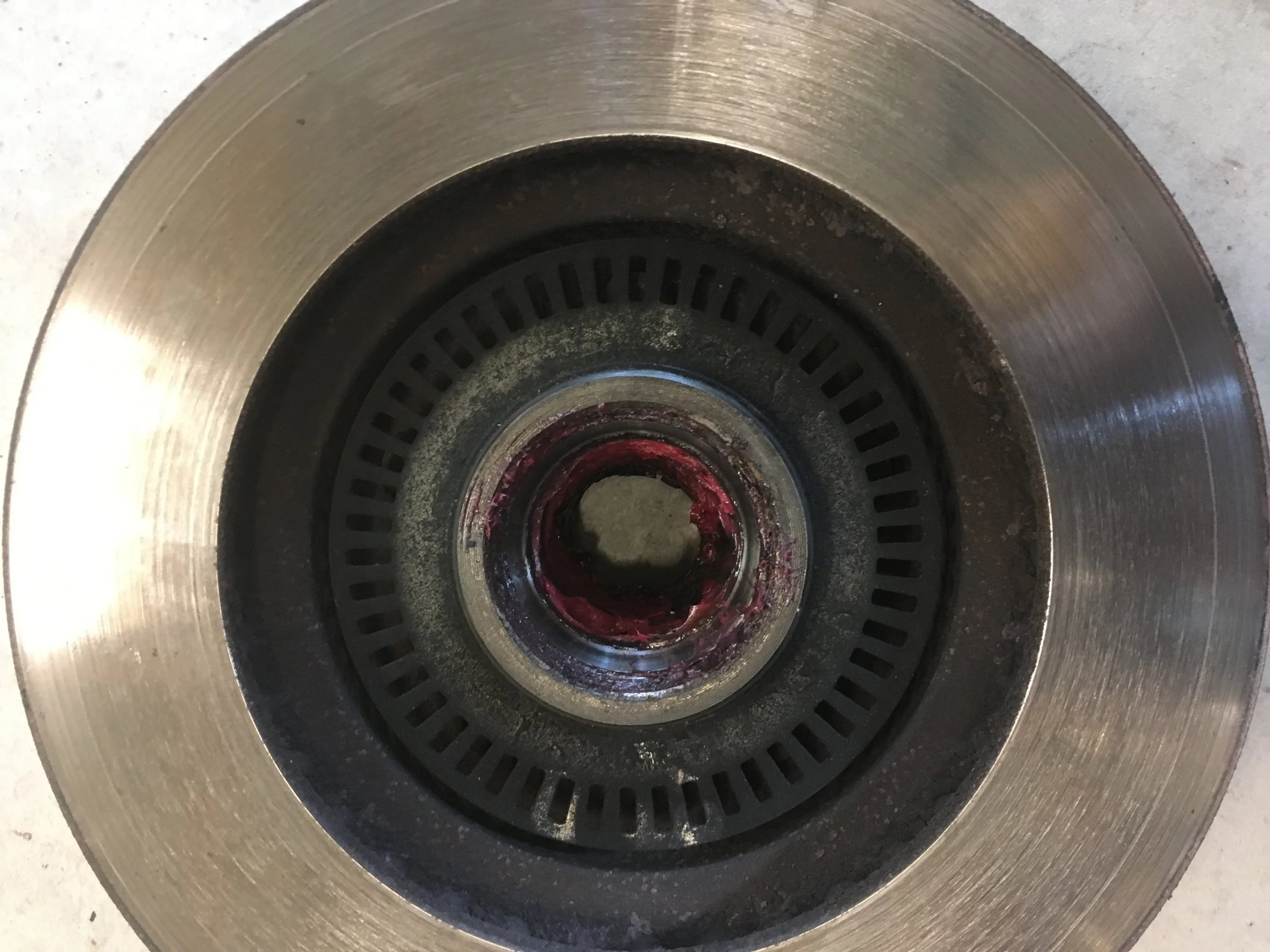

Right front rotor must have come from something post 93. What say you?

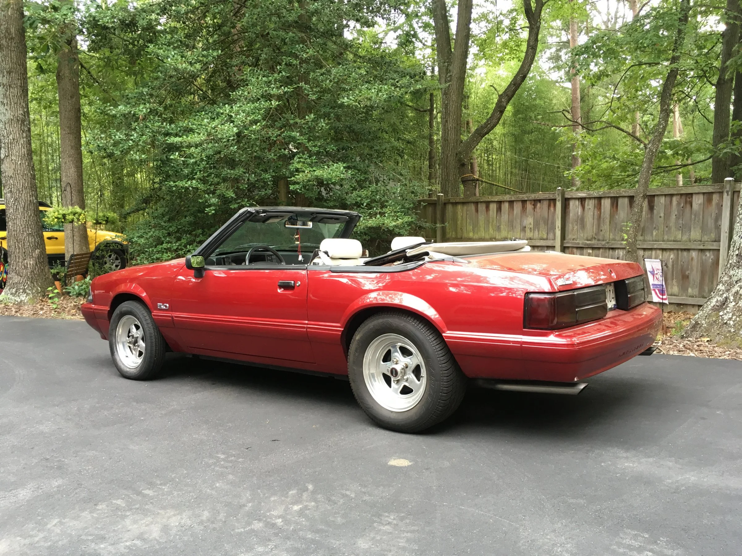

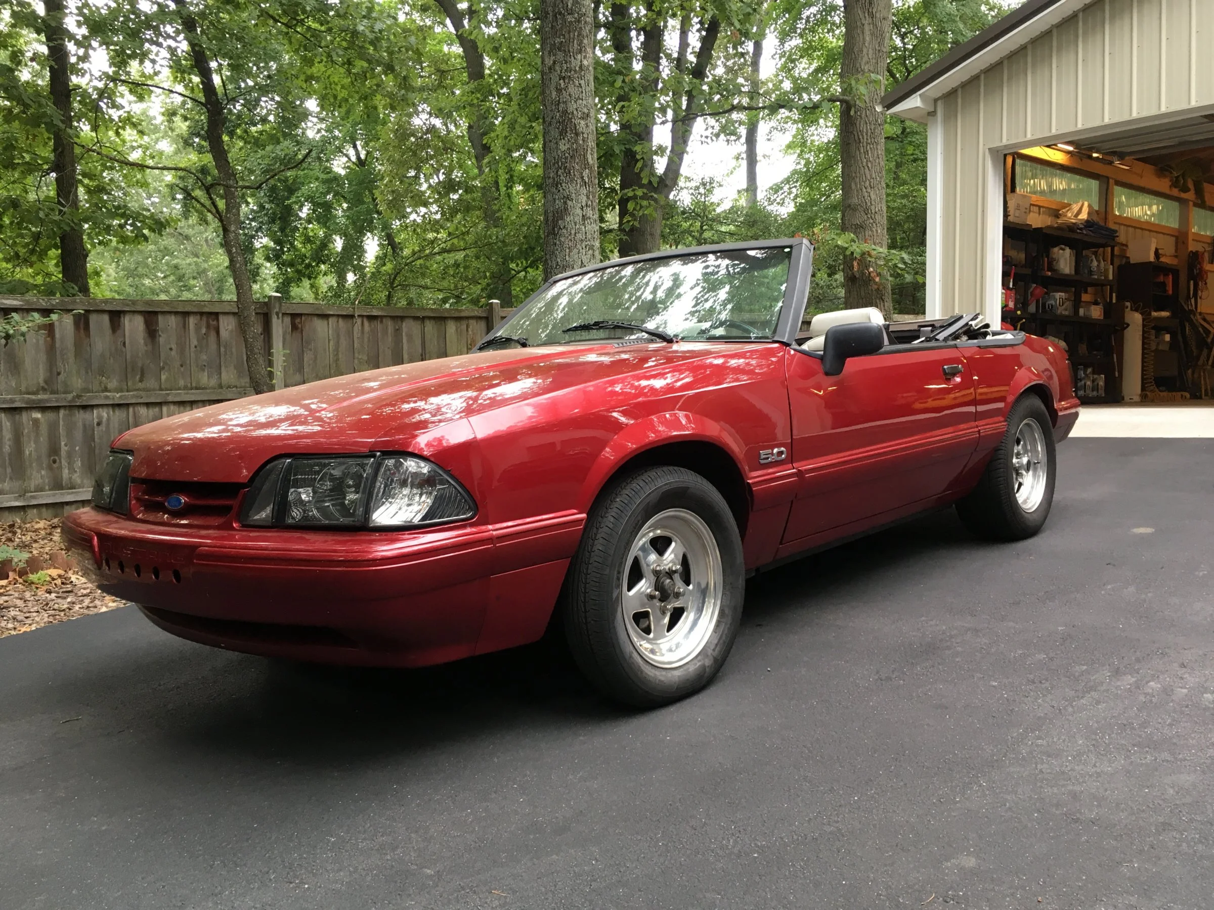

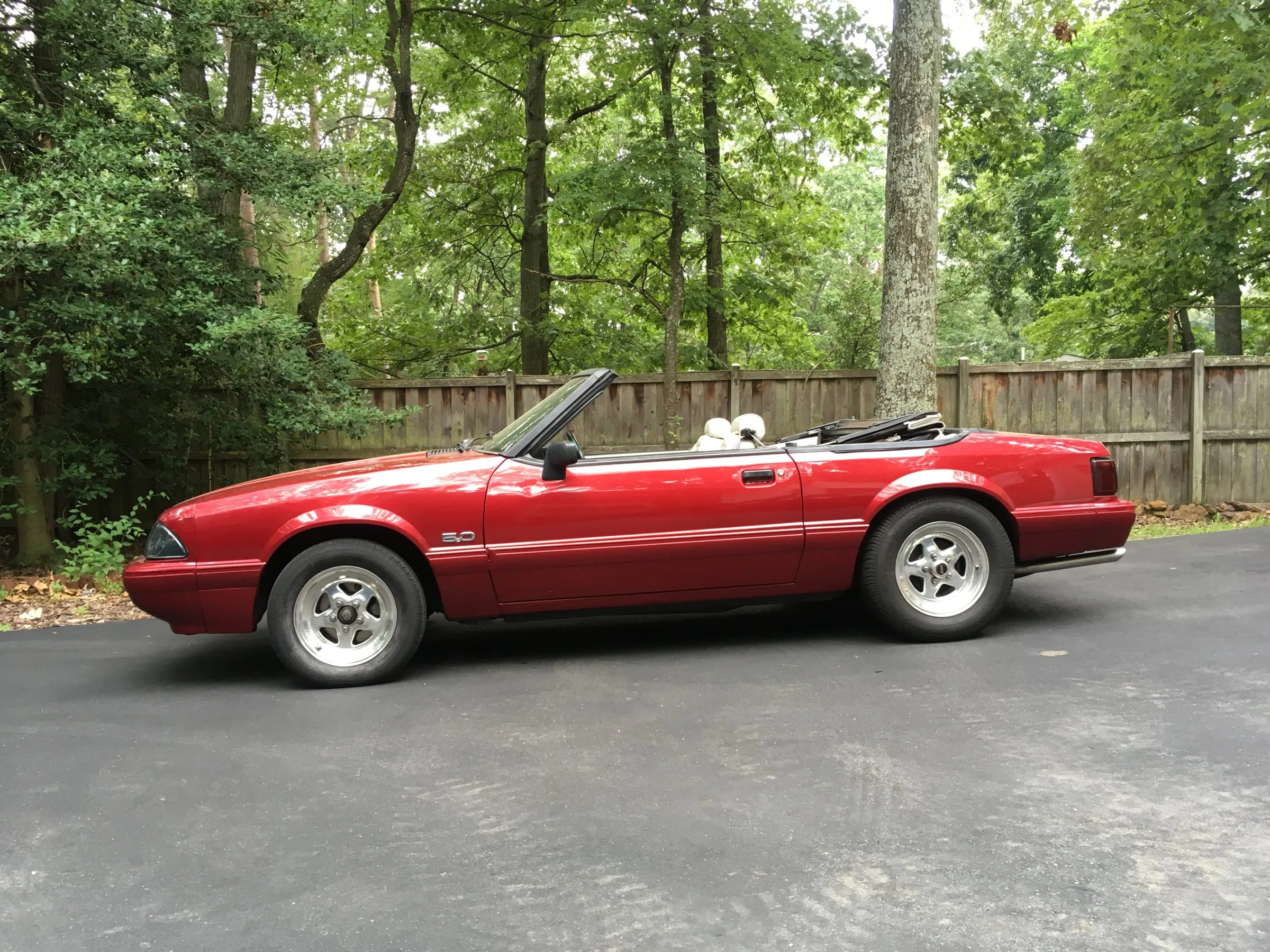

Have not driven it yet so I'm sure it will settle a tad. Here's how she stands after suspension work. The skinny fronts are going as soon as I get 15x7 welds for the front. Or maybe even new wheels all around if I find a good trade.

Nice monster truck. The suspension will likely settle a bit. Still a very nice very IMO :nice:
I know right. But hey, all the crap I still need to add back like the deleted AC , bumper support and whatnot will load it up some more.

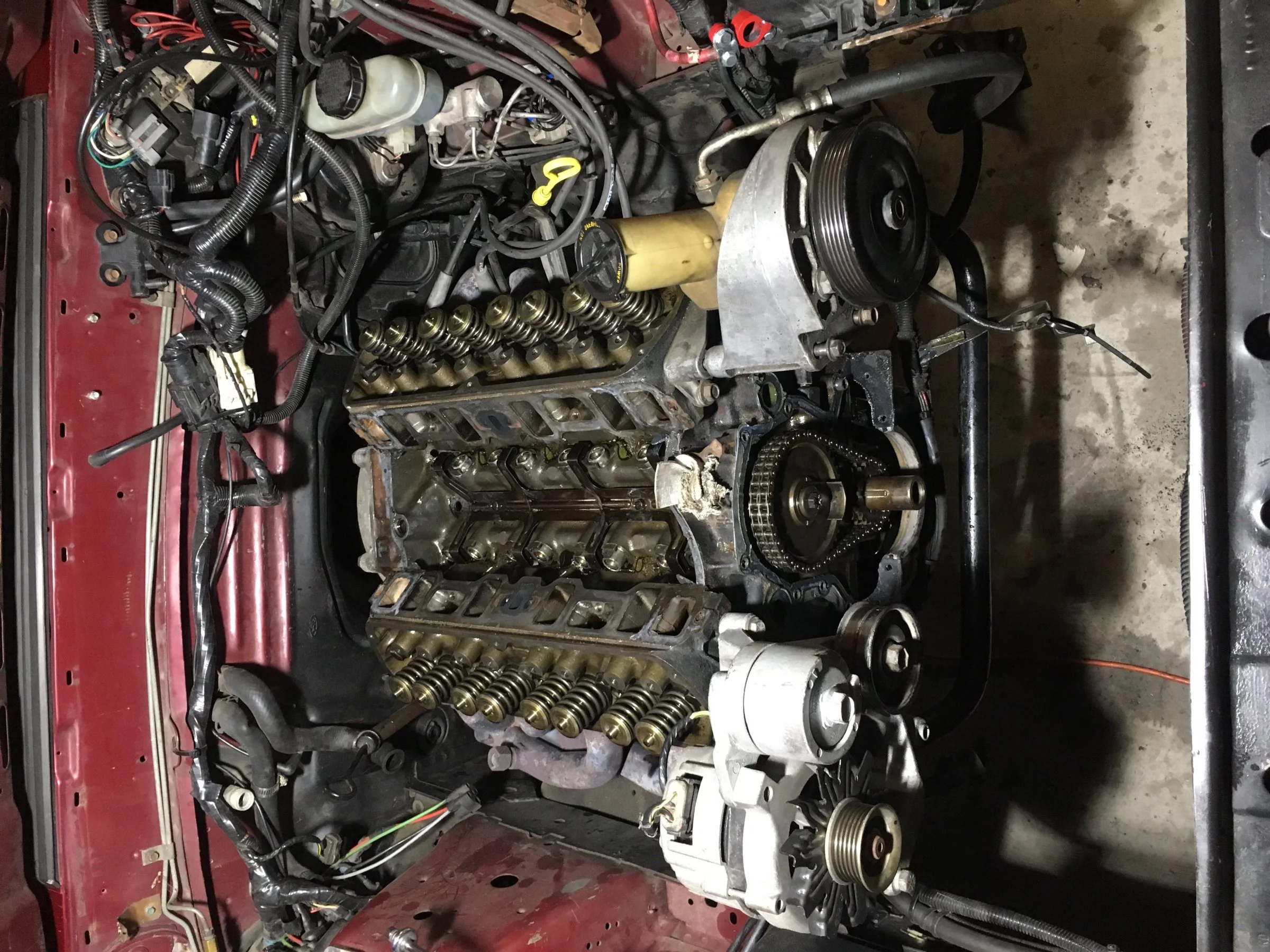

Bye bye x303. Hello stock HO cam. I need to get stock length pushrods. Different base circle on these two cams.
I think I'll pull the trans and fix the OD issue before putting intake back on. Looks a lot easier with bell-housing bolts exposed while the intake off.

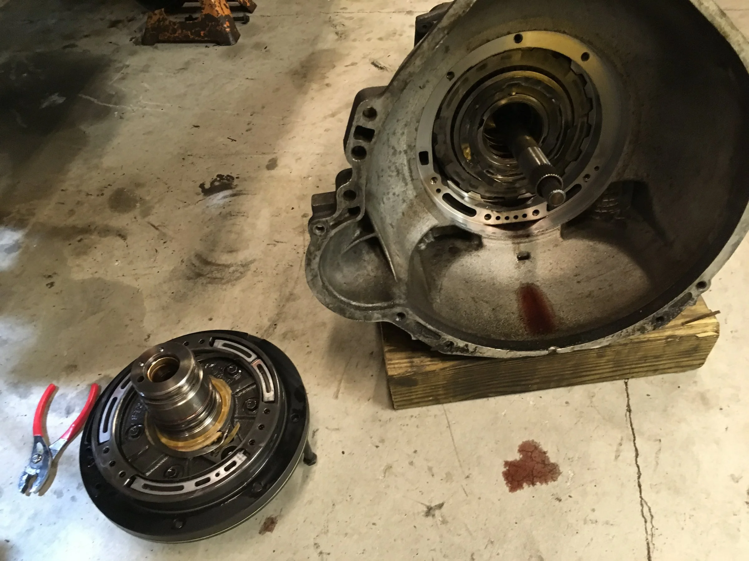

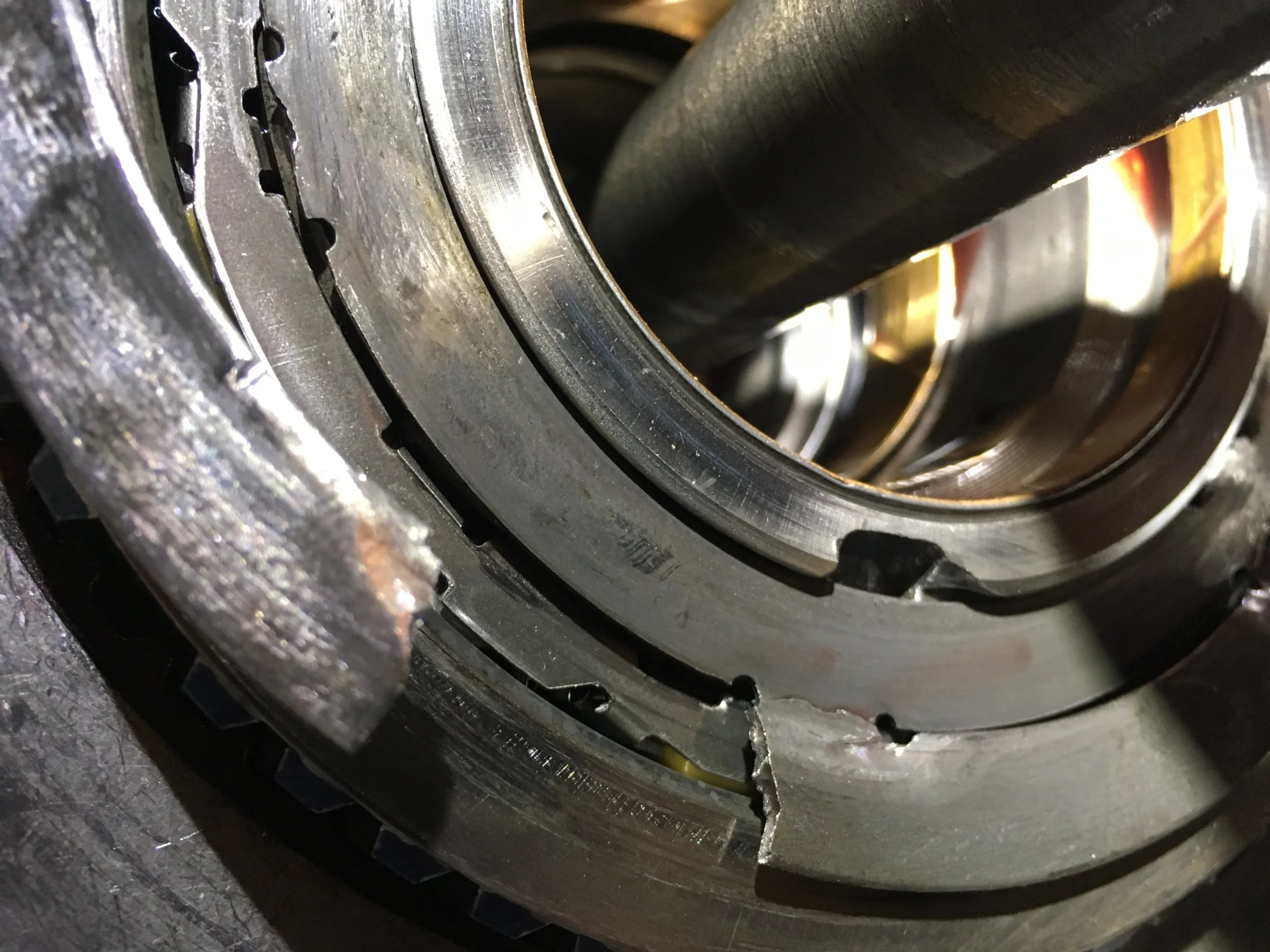

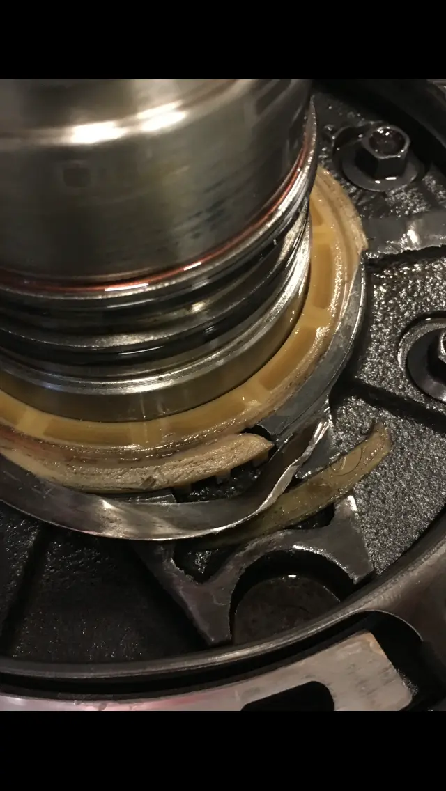

While I wait on pushrods and other goodies to get here for the cam swap, I'm pulling the AOD trans. Although this 1993 car was originally T5, the ID plate on the installed AOD says it came from a 1989 Mustang. Thats good news since its one of the better AOD versions. I've got something worth working with.
Reactions: General karthief

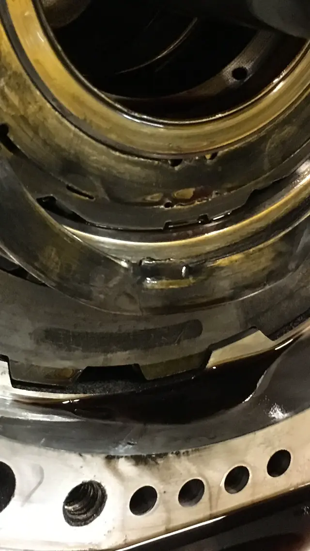

I can't fix this trans. Or at least I think it's reasonable to get another one or have a pro rebuild this one. I thought I might only need an od band and servo upgrade. However, after I pulled the pump I discovered torn up hard parts.
So what's the best place to get a good rebuilt aod? I don't need anything super heavy duty. Not a race car. Just a daily driver with some occasional sporty driving.
