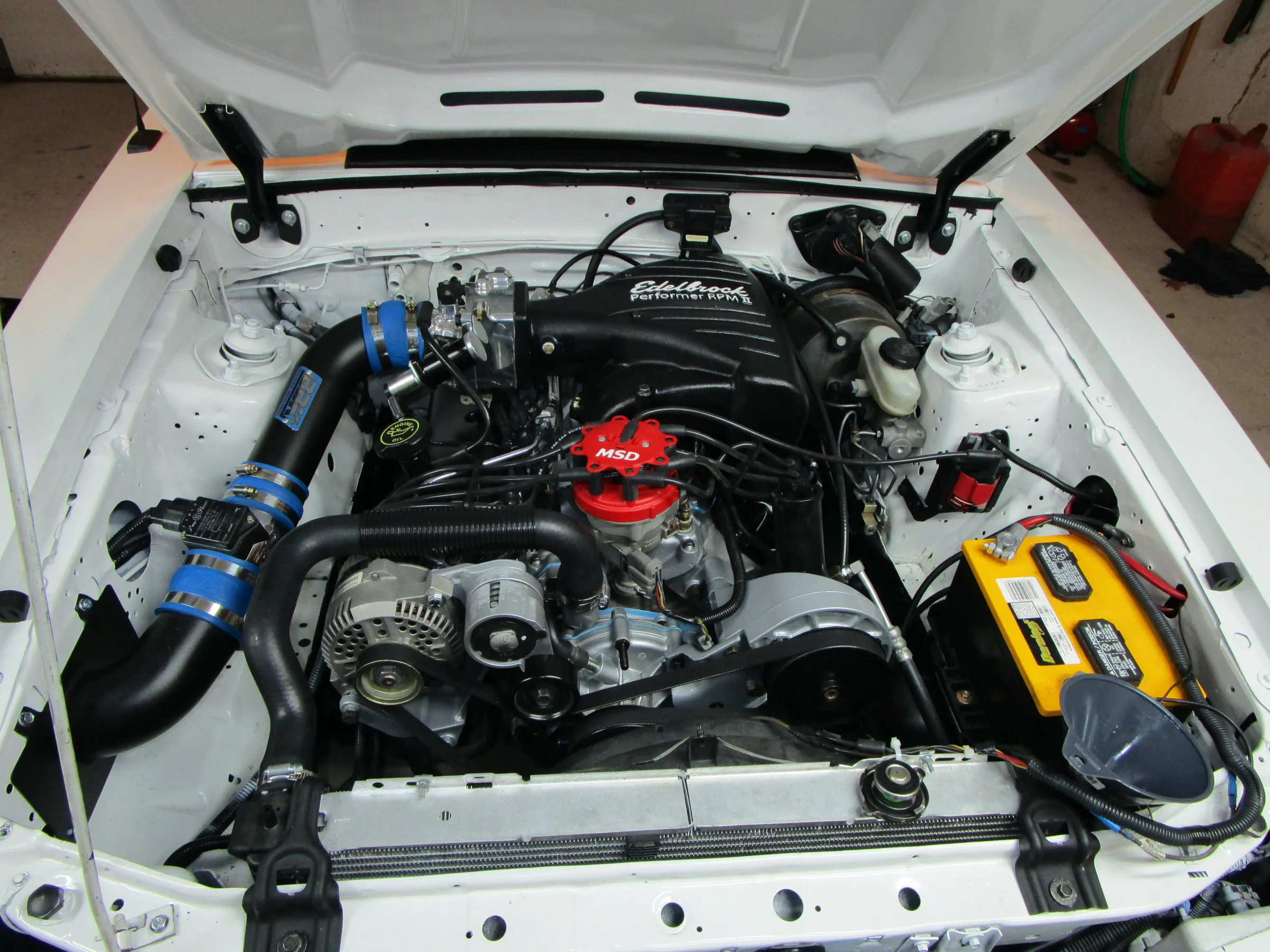

My '92 LX has been a tremendous help in getting the '93 vert straightened out. It's got mods but the harness and all related stuff is intact to refer to.

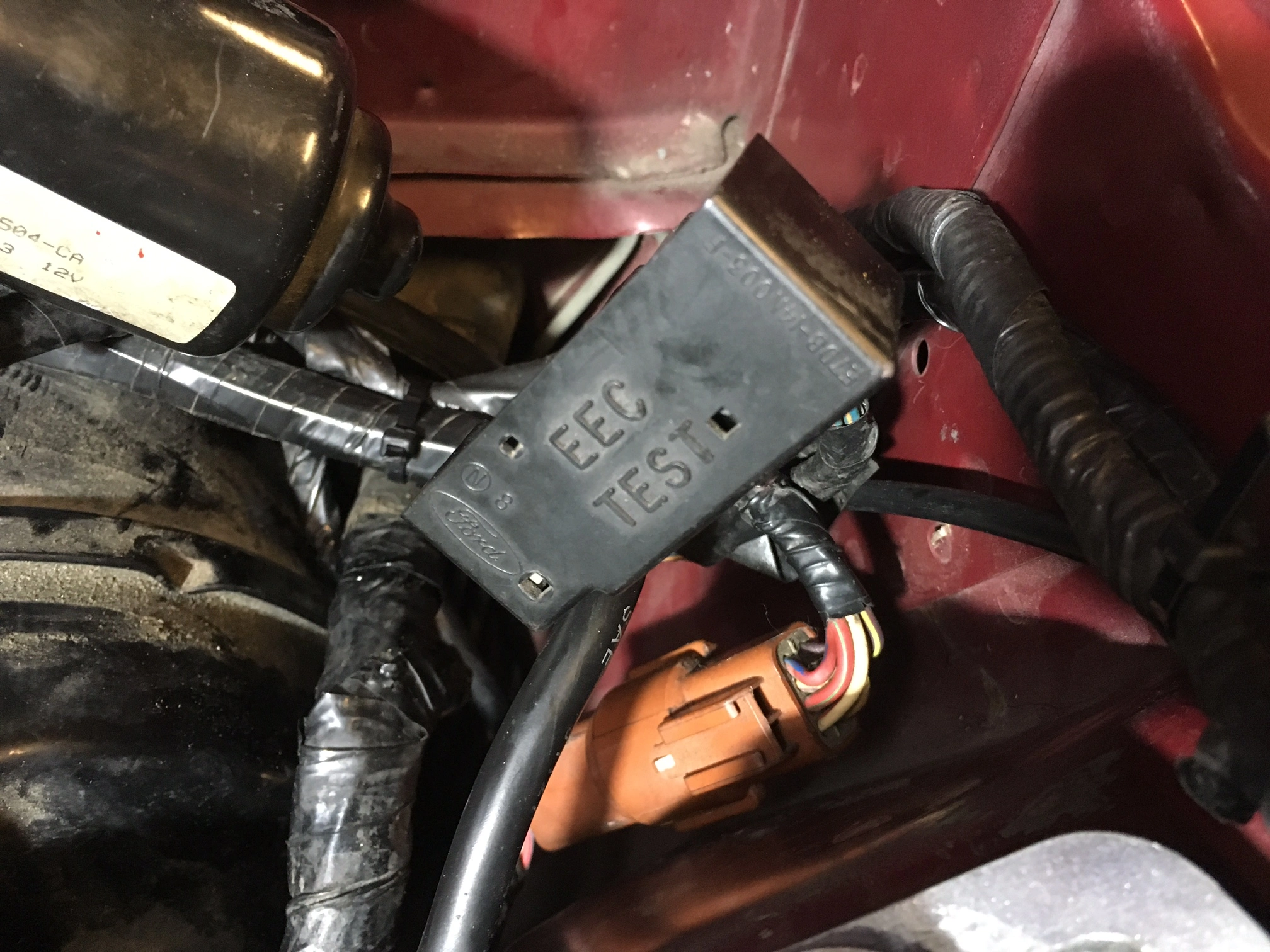

This is important! Got the EEC test port back where it belongs so it can be used. The tuck job I'm undoing had it inaccessible under the fender!

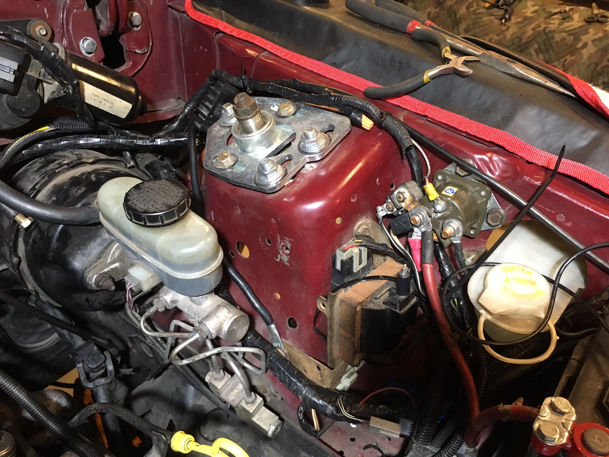

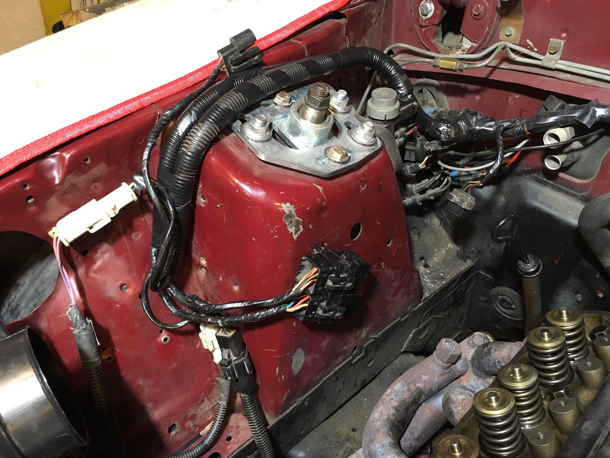

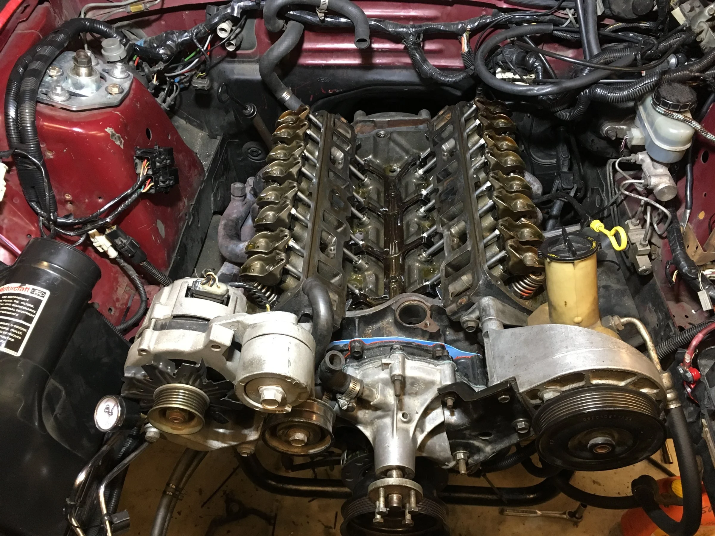

Right shock tower area after moving harness back. The seals for the relay plugs are missing. So, I elected to mount them higher up in the compartment in hopes of keeping water out. O2 and airbag plugs also visible. MAF connector waiting at the top of the picture. The AC compressor and lines are missing from this car so there will be a few unused connectors related to that.

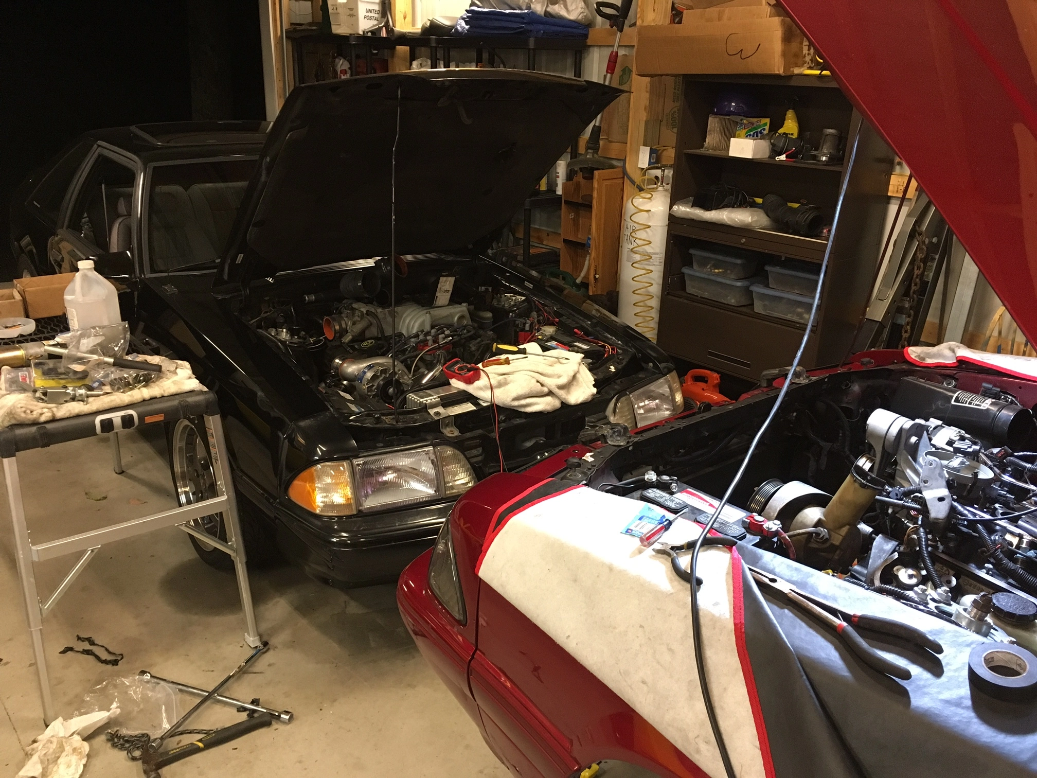

Looks like a rats nest, I know. But that's the way it was originally. I'm not looking to win beauty contests under this hood. I just want things accessible like they were meant to be.

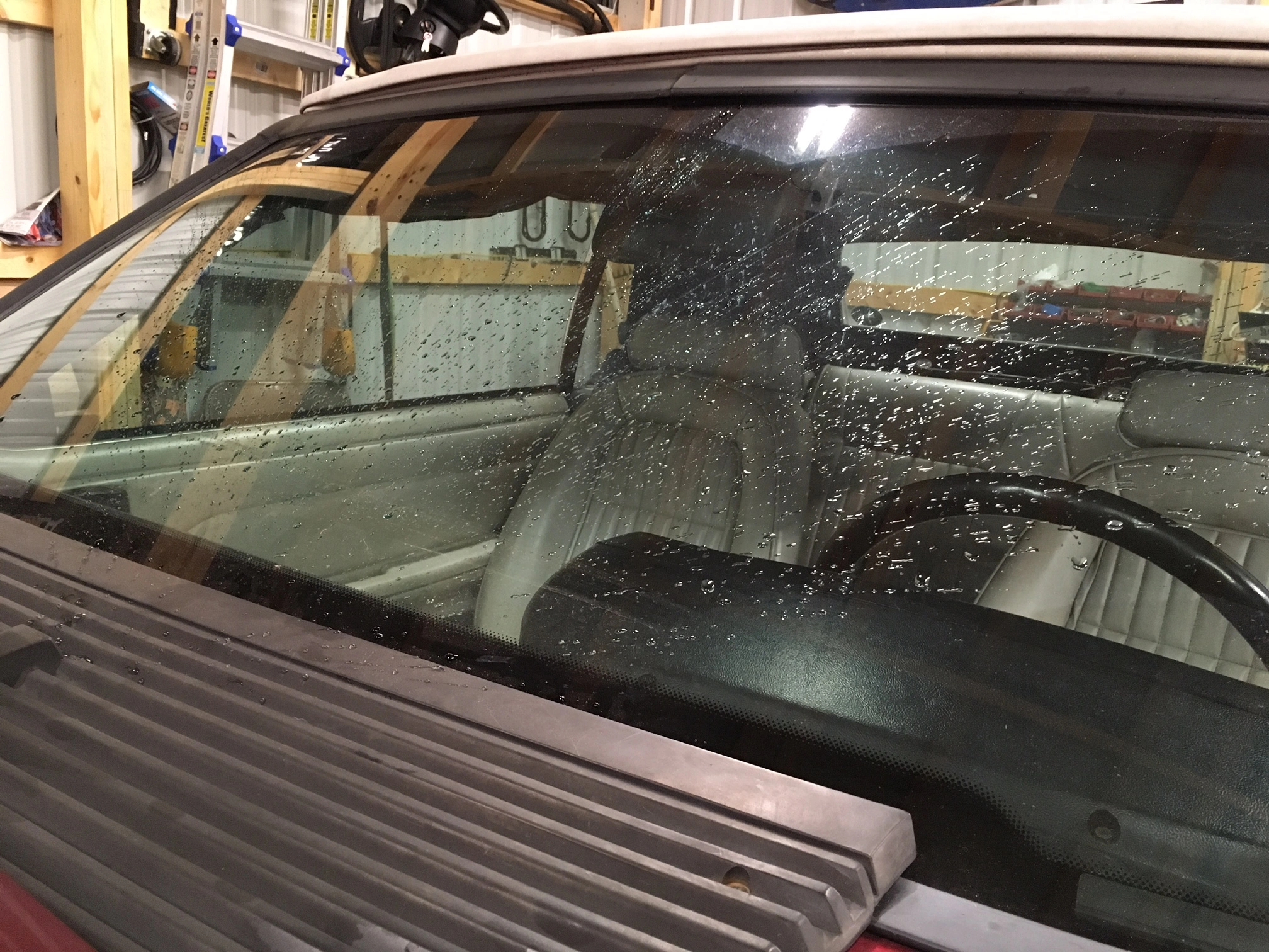

WooooooHoooooo....!!!! We have functional windshield washer! I've preliminary checked all other accessories and all good. I've even restored the check oil warning light and low coolant lights. Snagged that sensor at Crazy Rays off a 94 with 5.0. $9. Suppliers want $70 for that part.

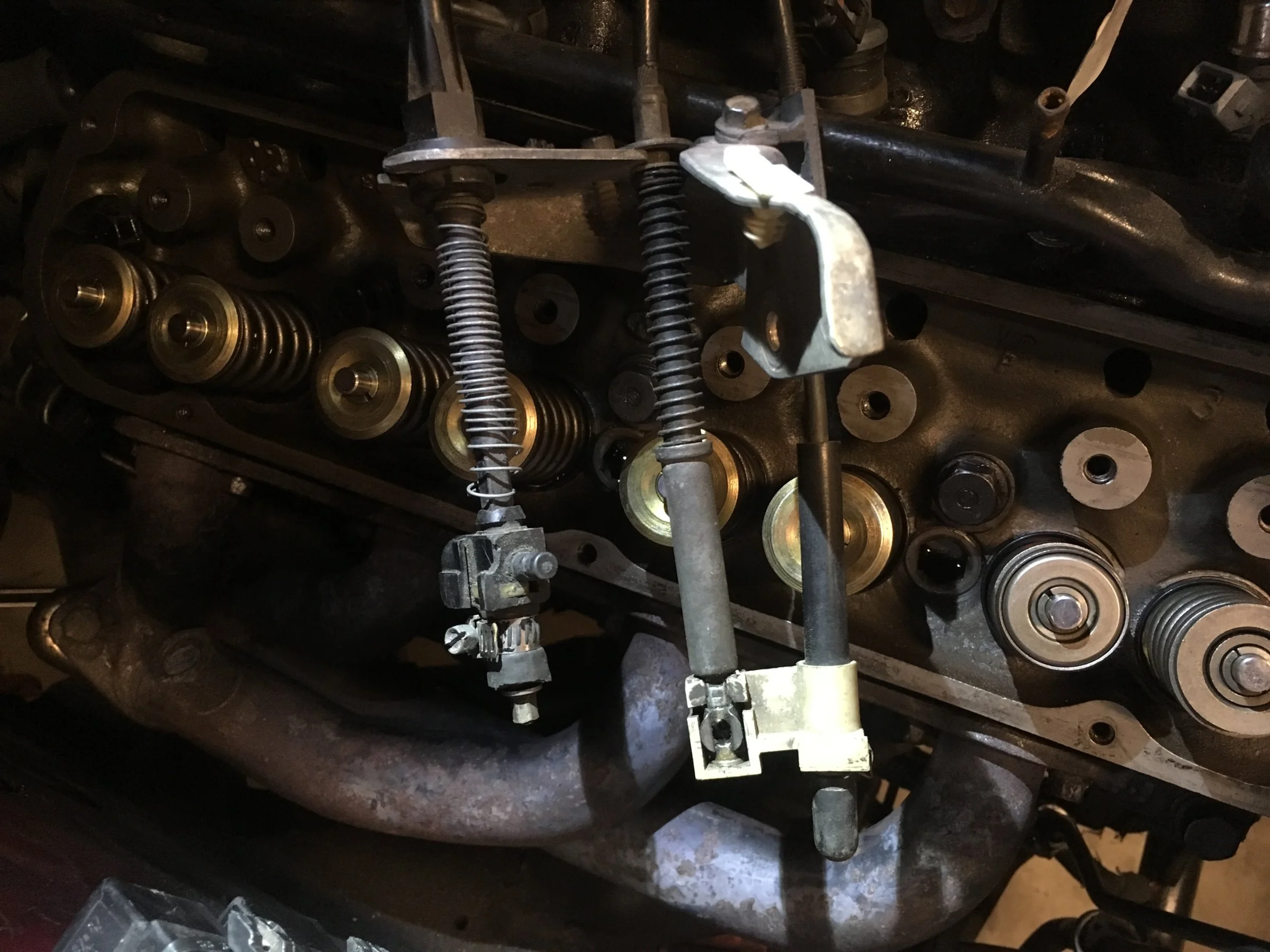

Shoot, I think I'll go for cruise control too. But I'm not sure I have the correct throttle cable. All the cruise components are there. It's an original cruise control car but I think the current throttle cable is from a non cruise car. Cruise cable from the diaphragm is there but I don't see how it will hook up to the linkage at the TB.
I had a cruise control cable assembly somewhere. I've got to check my stash after work tomorrow.
I was going to run cruise on my car but have since ditched that idea. I scrounged all the parts to do it though...:thinking:
I'll post some pictures of my current TB linkage, throttle cable and cruise cable. Maybe we can figure out what I need. I think what I need is a throttle cable setup intended for automatic transmission as this car was originally T5.
Reactions: 90sickfox
On the cruise control cable, everything is actually here. I just needed to snap it back together. The cruise cable and vacuum hose had been tucked under the fender with the harness.

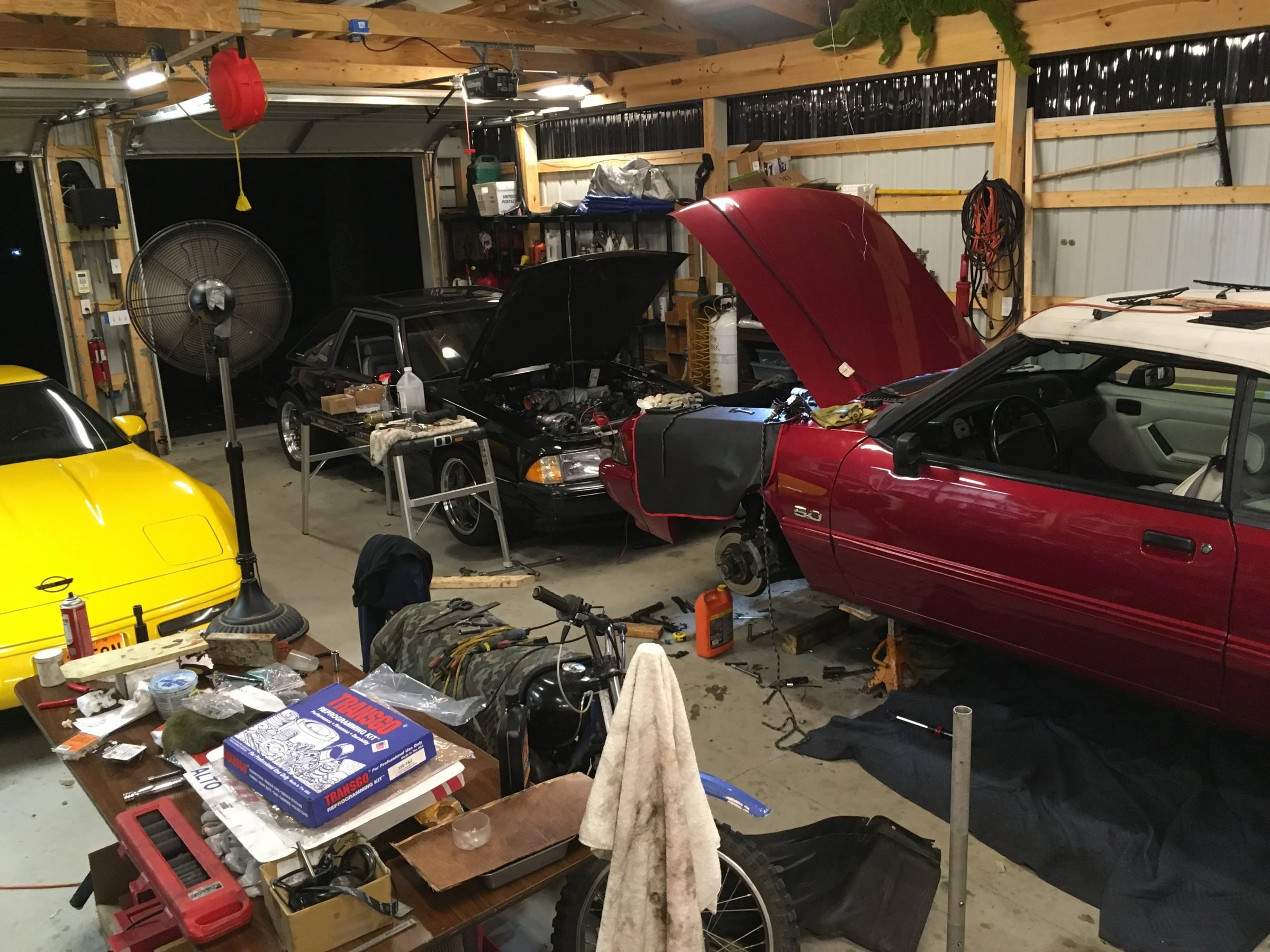

Still making progress but I've never had a car make such a mess in my garage before.

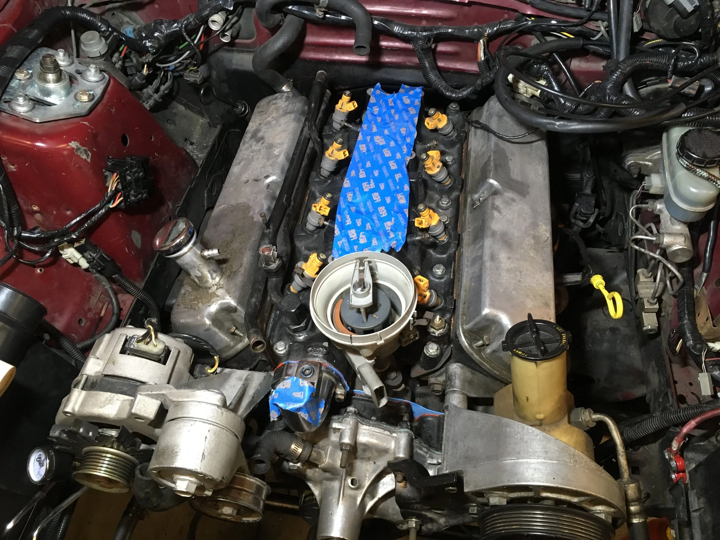

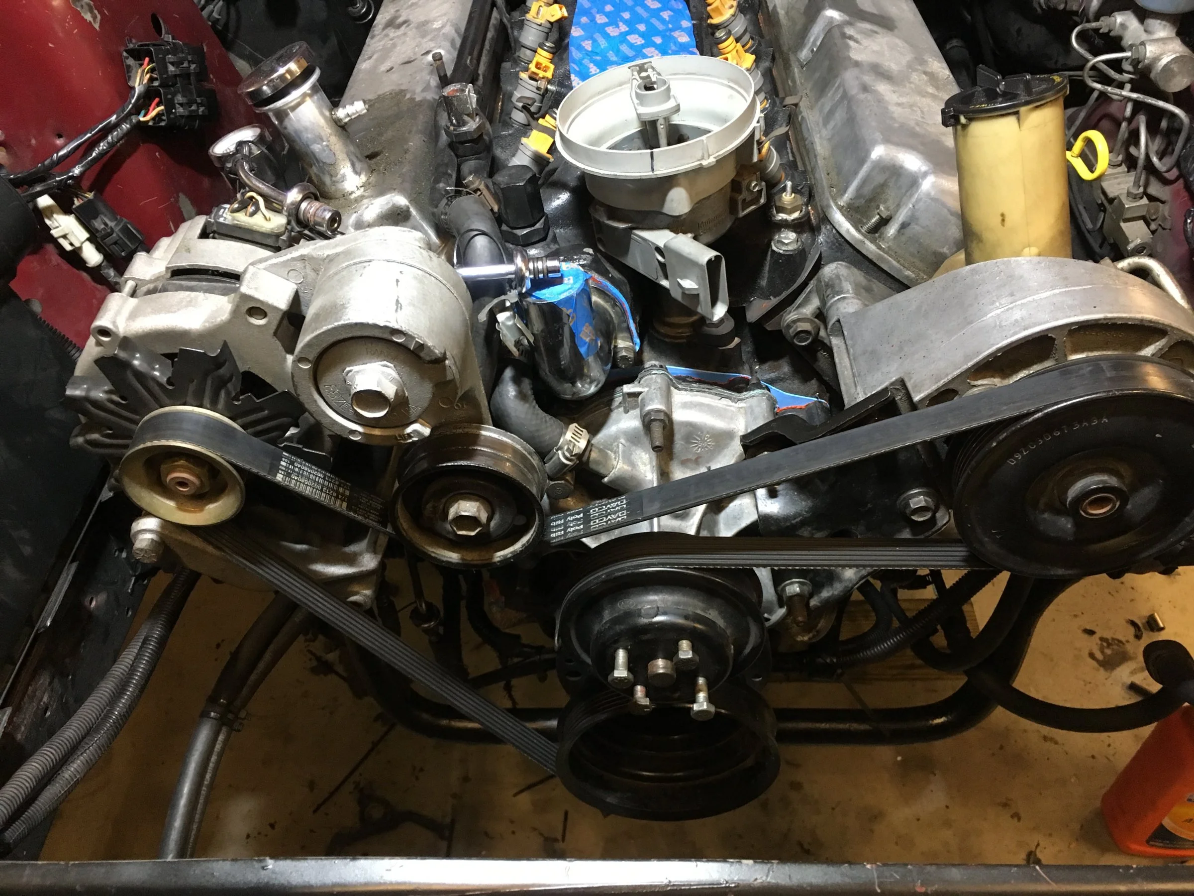

Have a look at this pulley arrangement. Not a normal AC equipped 93 fox. So what is here? Where do these brackets and accessories come from?
Reactions: RaggedGT
That would be me!
When I get this thing off the stands and moving under its own power, a major garage cleaning will be done. My struggle is that I'm working on this thing in short blips of time. If I had to alot time for cleanup, I wouldn't get as much done on the car. Although, I must admit it's getting to the point where tools are harder to find.
Reactions: Davedacarpainter
Very clean engine compartment there! So, are non AC cars rare?
Thanks, wish it still looked like that :(
Don't know on rarity, i would assume so but it was very possible to order a stripped down 5.0 lx coupe back in the day without power windows/locks, no ac, basic seats, basic radio, etc and it be basically a factory drag racer that weighed less than 3k lbs.
