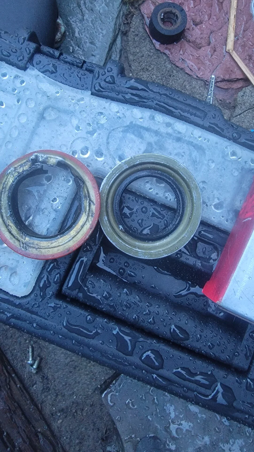

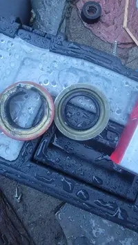

I have a leak from the seal that the driveshaft goes into the front of the car it's a aod 91 I got a seal today and I'm not sure if it's correct here's a picture of old and new

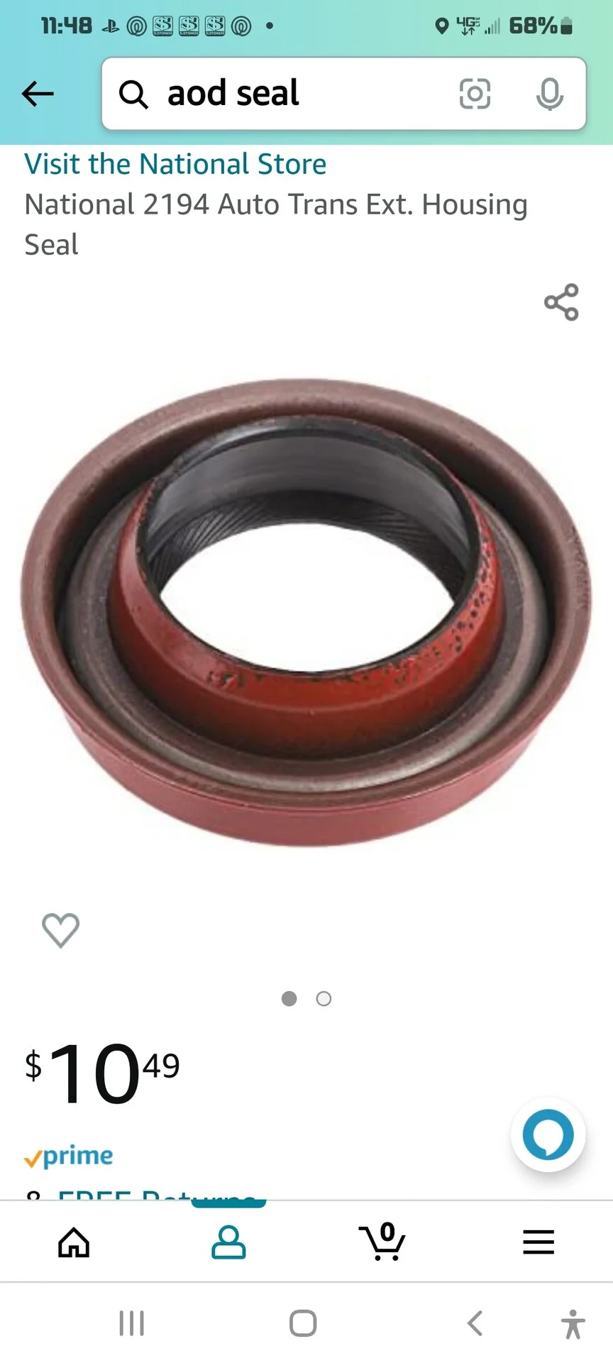

Is it a 5 speed or an automatic ? This is the seal I use for 5 speed and automatic cars.
They do make different ( universal ) ones that they say work but this national seal matches the factory design.

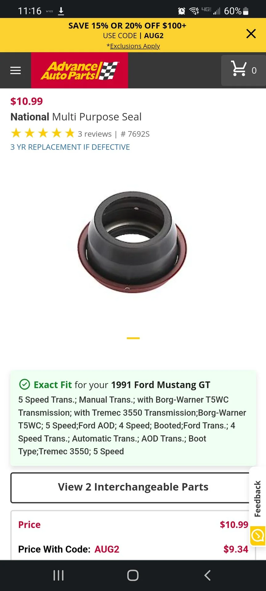

it's a aod transmission automatic and is this it I have a advance auto near me
That one will be easier to tap in. The one I posted is for 5 speed or AOD. The one you show looks better than the first one. I like the extra dirt boot length.
7692s is the part number for the National one.
I have all types of stuff to fit these seals. A piece of PVC pipe or straight cut metal pipe. I use adapters from my balljoint install kit.
I smear some rtv around the back metal part of the seal that seats in the back of the transmission. You can lightly tap one in with a small hammer keeping pressure on the opposite side with your hand. Just tap around evenly side to side.
Make sure to put some fresh transmission fluid on the end of the driveshaft when you put it back together.

now should the shaft have a little bit of a wiggle or do I have more issues inside? I need to take the inspection plate off and look around and I tried a piece of pipe from my exhaust kit but did we figure out if that's the wrong seal I have
There's a bushing inside that the yoke rides in. If that bushing is worn it'll cause the seal to leak. The only real way to check that is to slide the driveshaft yoke in and test for play. A little is ok but hard to mesure without a dial inicator. I've had nothing but bad luck with the shorter seals. That's why I use the ones I posted.
