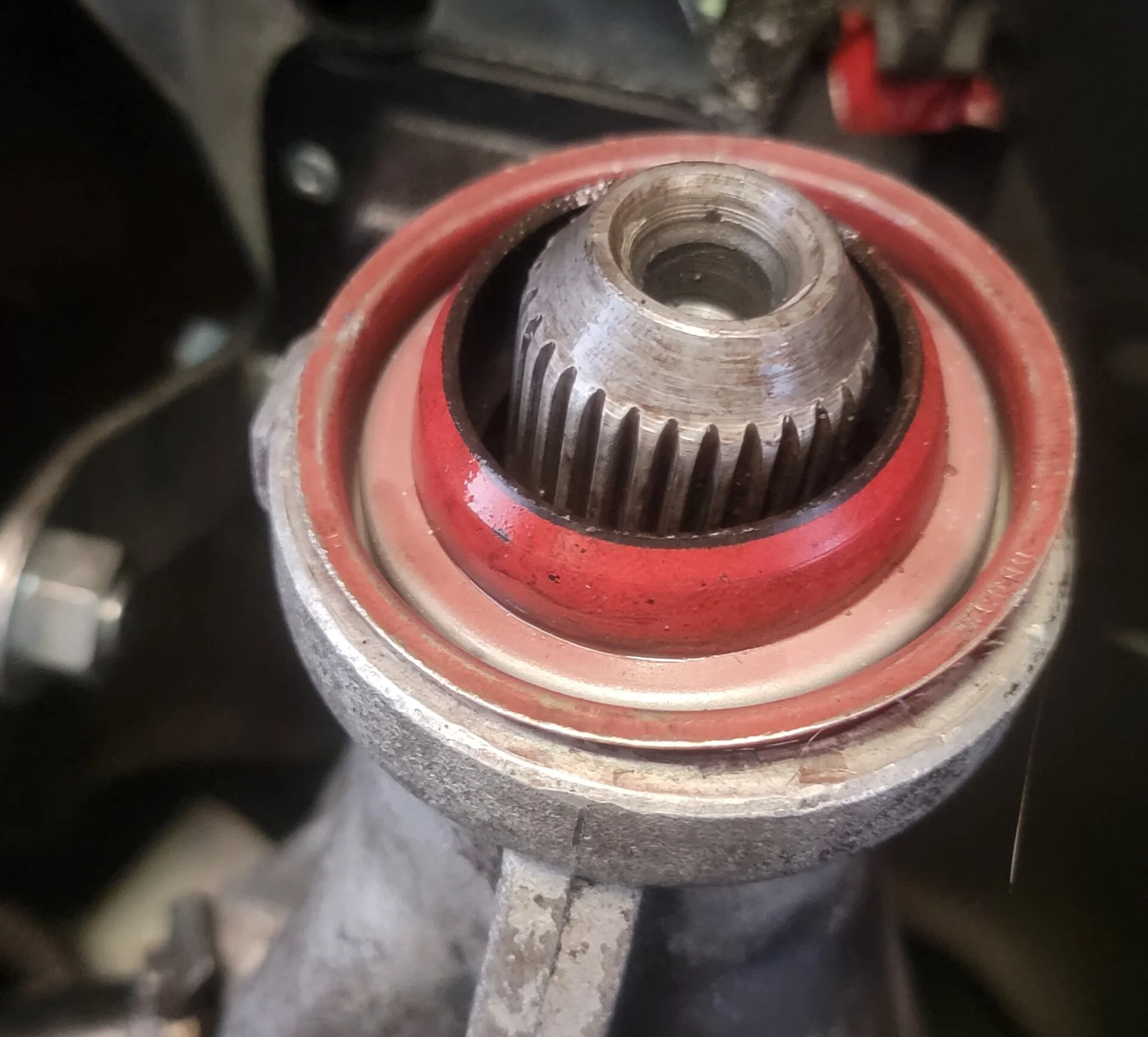

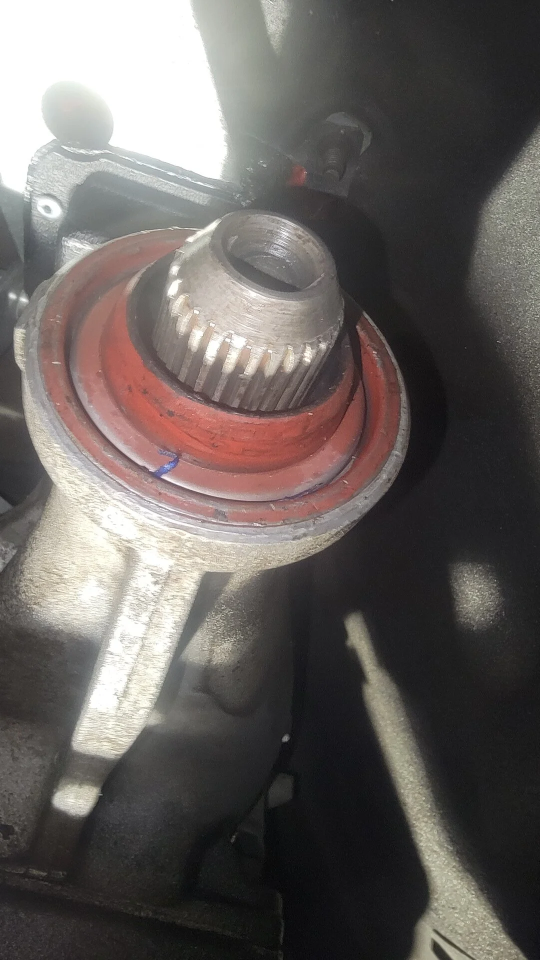

.Every time I hit it flush then start tapping a side of the seal comes out,even if I'm pushing on one side and tapping the other side it never wants to go in
yes, thats what they do.... Just keep at it and eventually it will finally start.... DO NOT force it if its crooked... Take it out and start over again....

So the 2 seals came in 1 was wrong but the other is correct and it's almost on just have to slow tap around the seal,I'm trying to find a small hammer to tap it with
And try number 1 fail. Since it has that little boot on the end the pipe I was using don't work now and a few other tools also won't work,going be digging for something to use

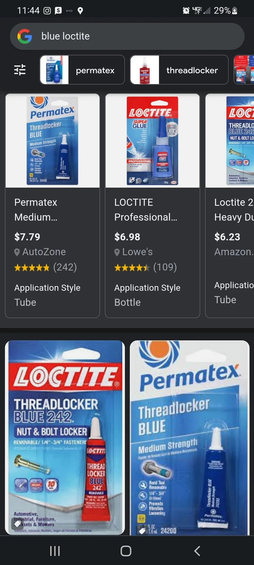

Get some blue loctite from the parts store. You just need a little to put on those little bolts at the rear of the driveshaft. The blue loctite will allow you to get them back off if you need to.
Tap top, bottom, side to side, light taps to get it started, takes some patients. Don't need a pipe, they make an installation tool but I've never used one.
I used a PVC fitting to tap mine in. I believe it was 2”. May be worth bringing the seal to local hardware store and match it up. I’m thinking it will be shorter than the exhaust pipe you’re using and may give you more from to maneuver.
