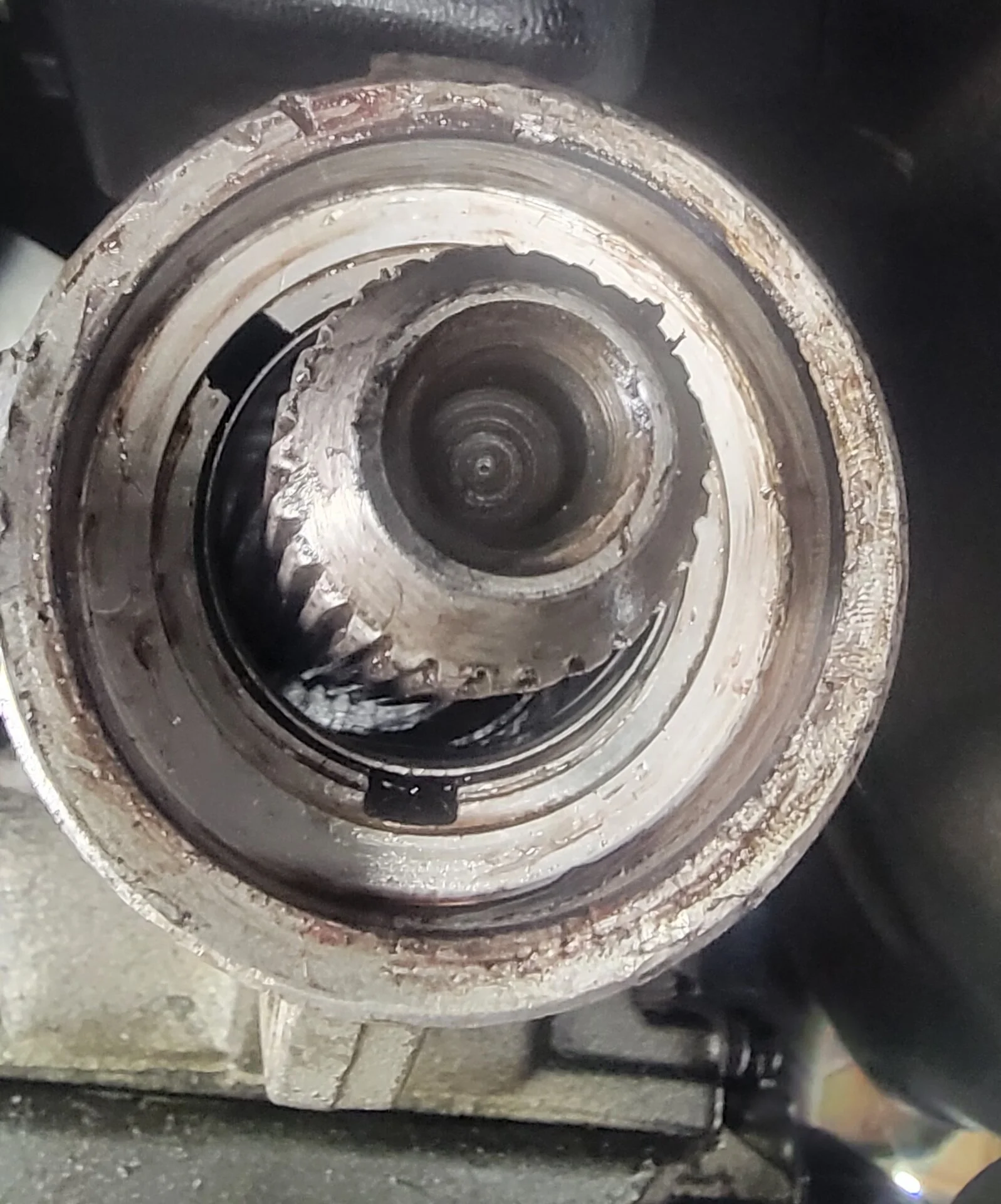

Ya I always forget to use a coma or period. I fixed the settings,now with the car I see parts going skyhigh and the car sitting for so long I think it's out of my car knowledge to fix,I still can't get this seal in,I even put the old seal in a exhaust pipe to hit it in but I have no swing room

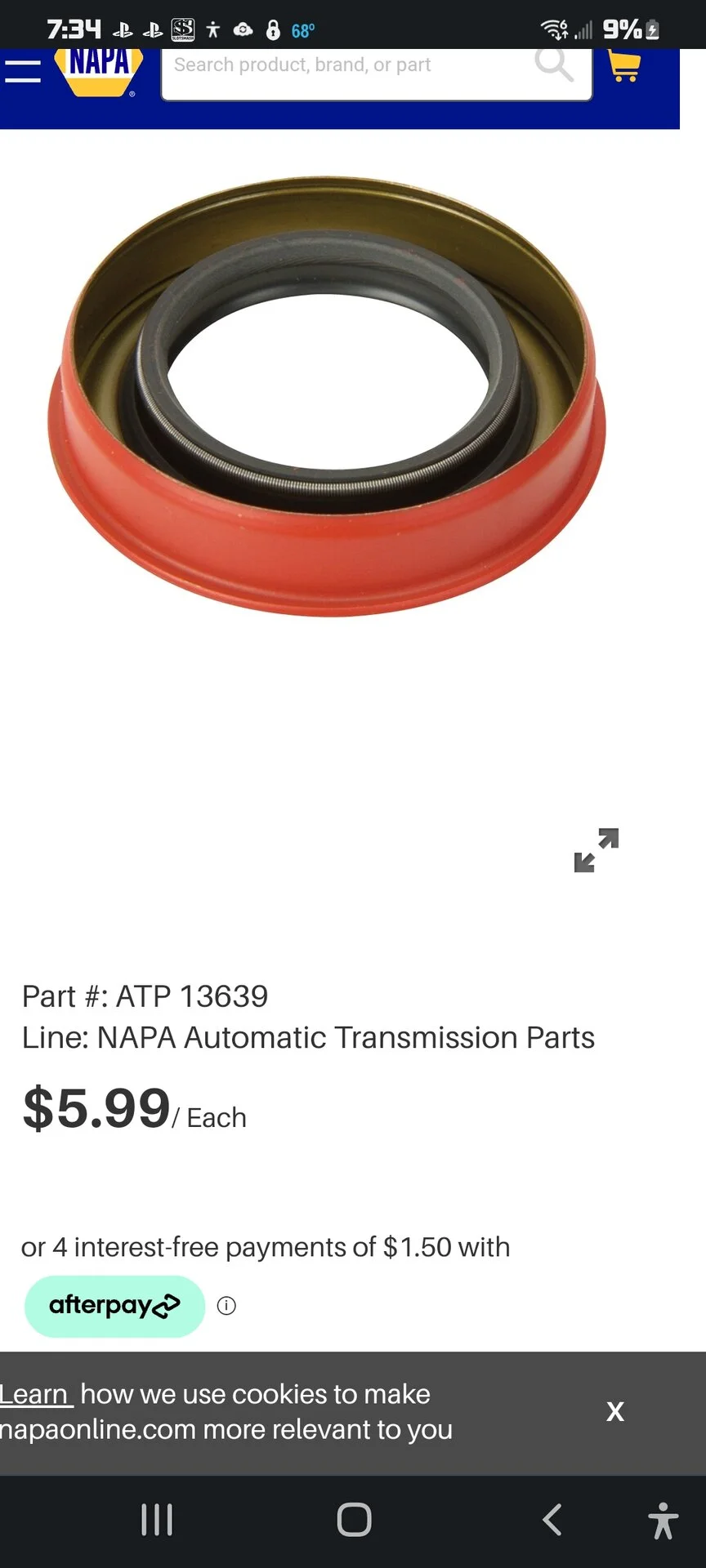

Ya the front and back get me confused. I have the Haynes book but it doesn't help like a video or someone there with you watching. I have to do axles and seals and no clue how to do that I'd love to keep it but it's going take time and money. Now with the seal what kind I use for lube just tranny fluid or gasket maker?

This is the seal I got
Now you've lost me. Post a pic of where your trying to install the seal.
Stick with us, once we get an idea of what/where your working we can help better.
That's the seal I have right now

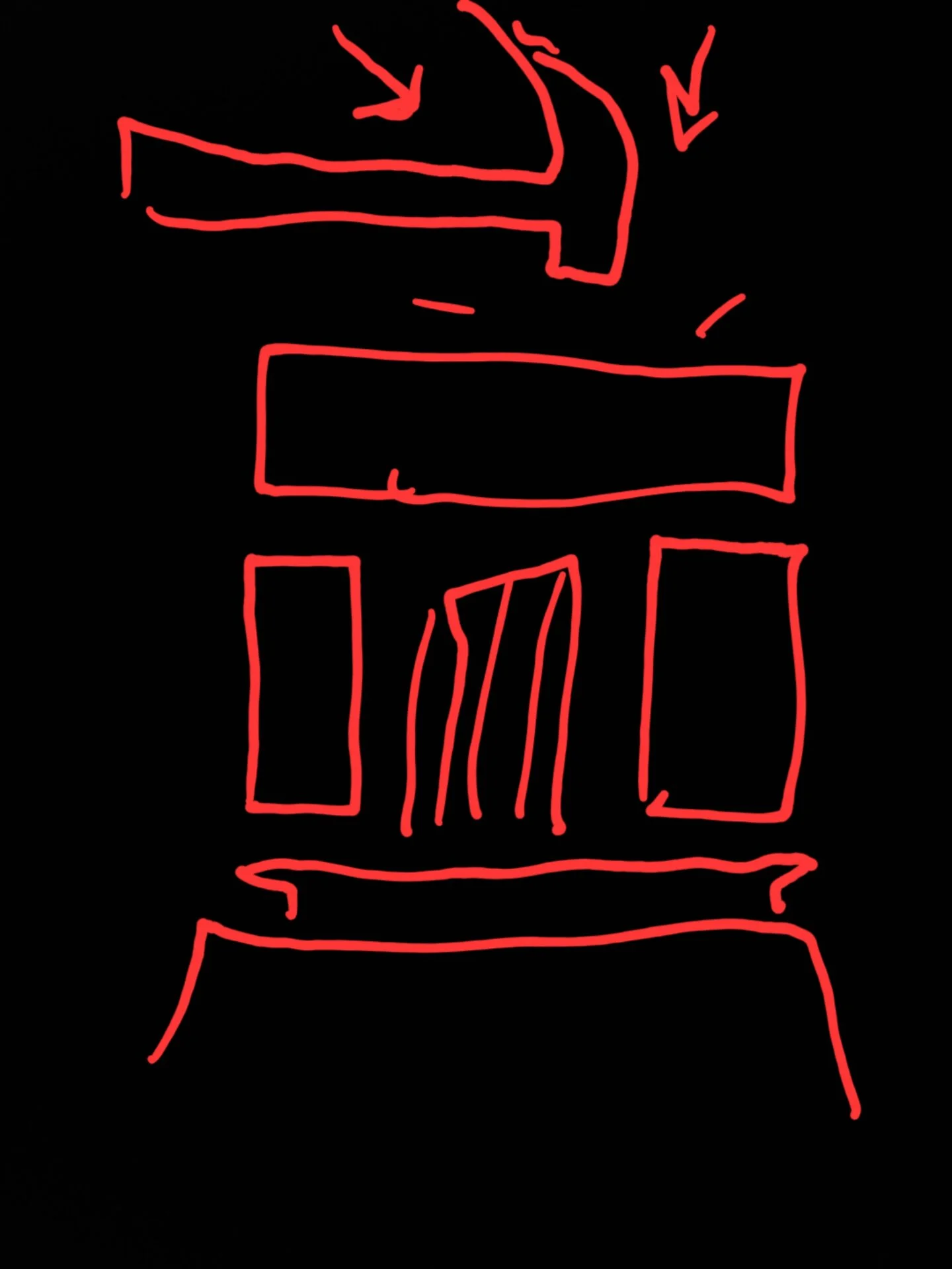

If you have wood...like two 2 by 4s you may be able to put them beside the shaft on each side screw one across the top and tap it. Kinda make a " H " pattern. Leave enough room to seat the seal without the bar or wood hitting the end of the shaft. You nay have to think outside the box.
Those seals cam be one of the most frustrating things to do.
