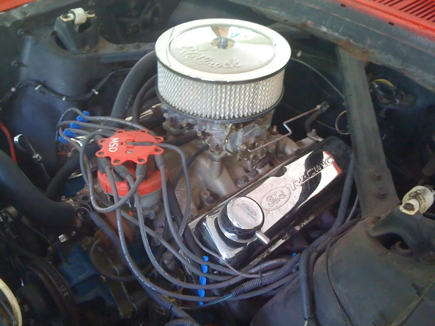

I have a 95 HO from an Explorer in mine running a 600 Edelbrock. Check my avatar. That is a stock 86 Mustang distributor and spark box. I don't know if you can tell from that pic or even an enlarged one, but maybe it will help.
Here is a larger pic. Click for full size.

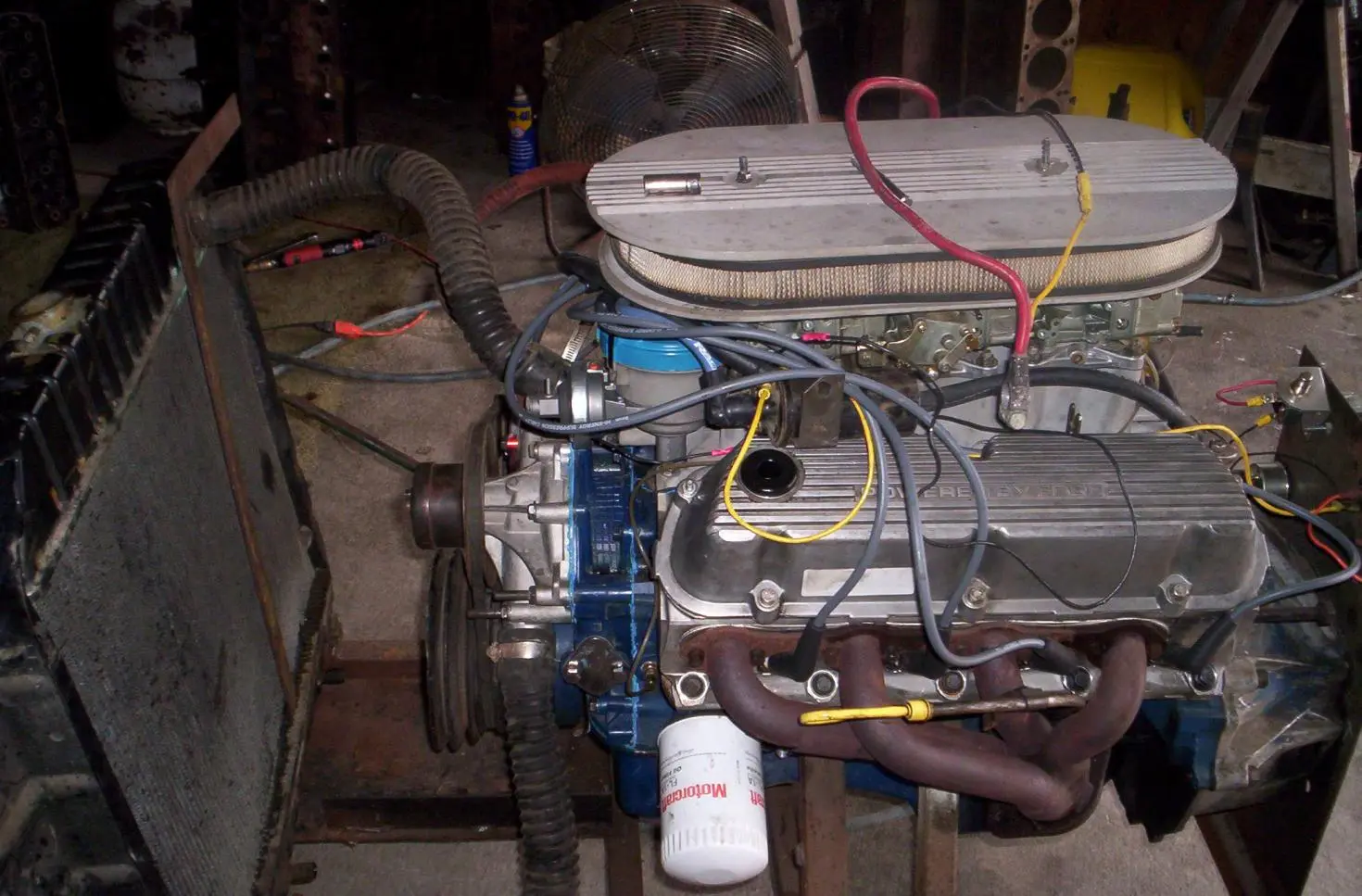

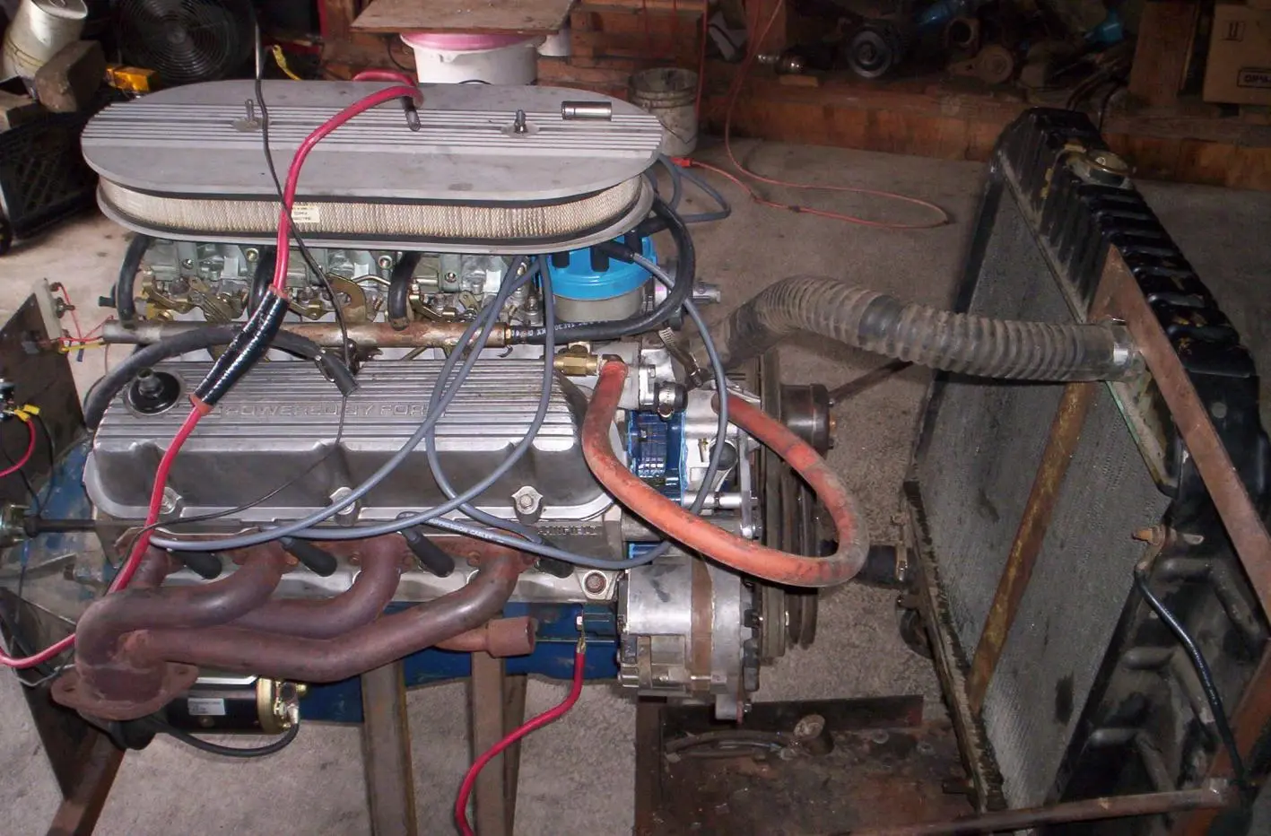

I'm running a repop 3x2 intake with the factory oval aircleaner assembly. It fits fine over a factory Duraspark distributor with the large EFI post type cap. I've even made a new base plate to reverse the top to gain clearance in the rear for both my 77 Comet now and before when the motor was in my 89 Ranger. K&N makes filters for it too, I've got both the stock height (1.75") and a 3" filter for it.

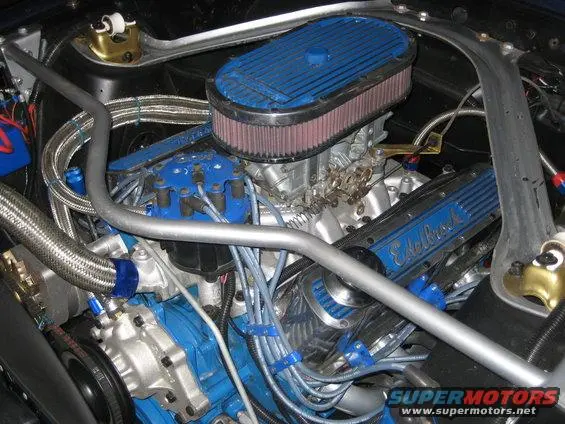

I run an oval Edelbrock air cleaner w/ an HEI distributor. I use a 1/2" phenalic (sp?) spacer and 1/2" air cleaner spacer to clear it but also have an open hood scoop to give me extra under hood clearance. The air cleaner just clears the dist so I don't think it would work unless you have additional hood clearance or a thinner air cleaner. Mines about 2 1/2" tall.
