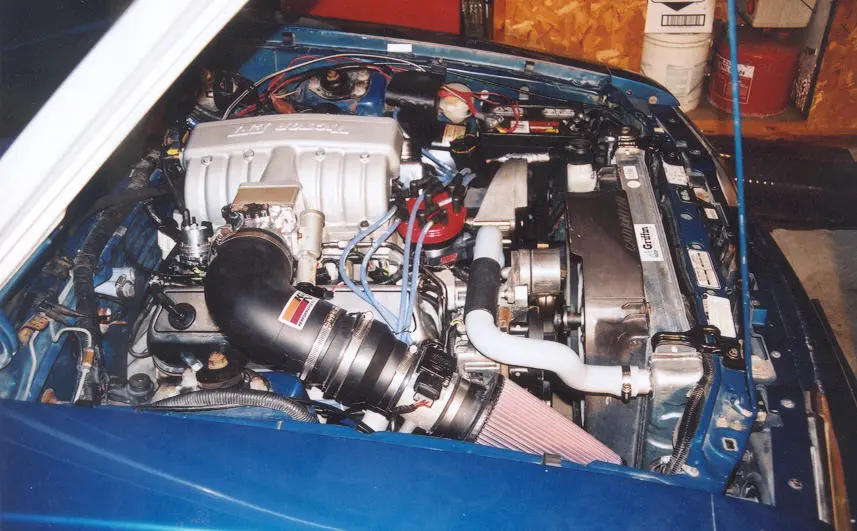

yea..i see what your saying about 200 not being to hot..thats good..i really didnt know what was to hot...if what you say about the fan/shroud is true..then mine is in way to far...but i guess the temps arnt to bad considering the cubes i have..here is a pic and you can see how far in the fan is..but when the motor is running it seems to produce alot of air flow

Ah, that is pretty close, at least closer than my stock set up. It's funny, but I did a search on Yahoo and all I got was PC processor coolers! Water cooled, fan, shroud, everything. If you are bored one day you go hunting for a fan to water pump spacer to see if bringing out the fan does anything for you. If would be interesting to see.
