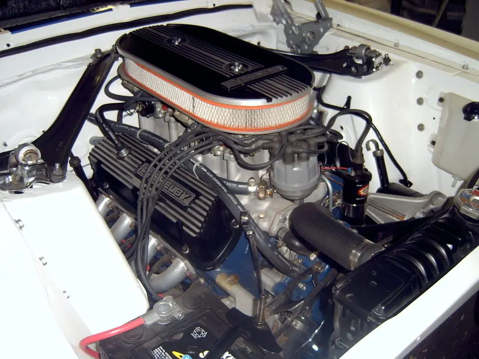

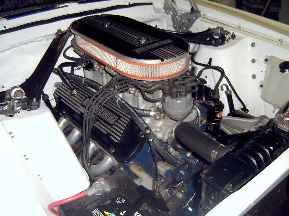

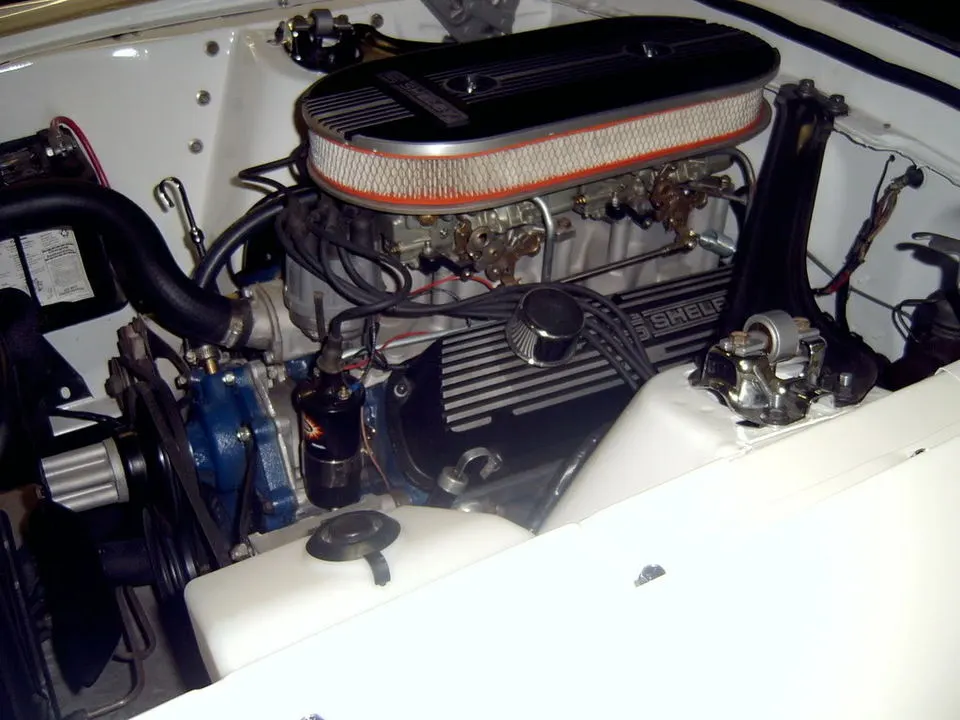

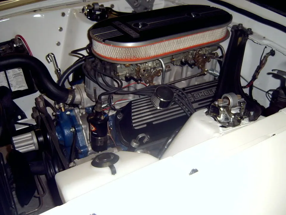

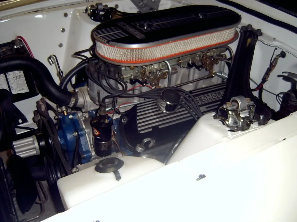

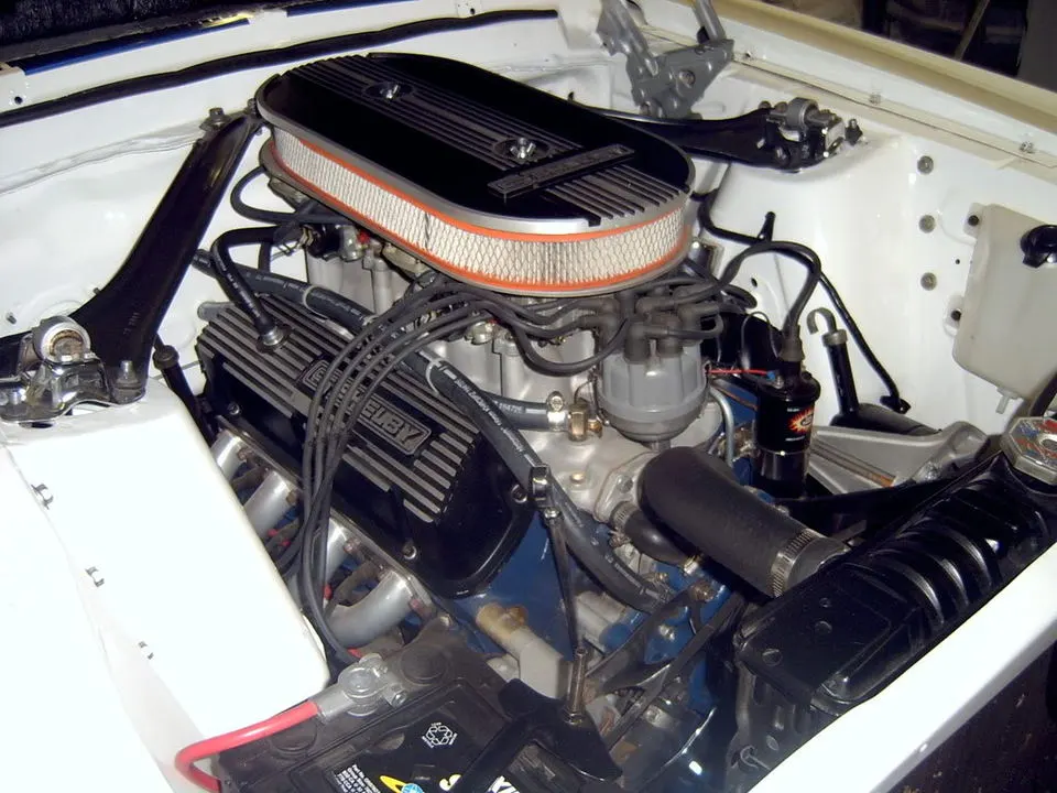

I have a decent collection of '60's car magazines, and from the Ford/Shelby ads in all of them, I can tell you that LOTS of engine parts were available over the counter at Ford dealers. Solid lifter cams, tri-y headers, Cobra valve covers, single four barrel, dual four barrel and three-two's manifolds were ALL sold over the counter at pretty much any Ford dealer. The dual-four manifolds shown in the ads were equipped with a pair of Carters (same as edelbrocks) carbs, but my car is equipped with a Shelby two fours intake made for Holleys. I also wanted my engine to look like it could have been done in the late '60's and as such, I had to resist the impusle to buy chrome or billet stuff. My car also has an early, non-vacuum advance dual point distributer that is equipped with Pertronix innards as well as Pertronix's 7mm black plug wires that look factory original. It's important to stick with a theme to get the right "look" and the only place I strayed was with ceramic-coated try-y headers, and a dry-cell battery.

and the body colored engine bay. you could have had the Tri-Y's done in a black ceramic coating and i believe they even have white now as well for that total 60's look....LOL.
other things you could have gotten over the Ford counter were rearend gears, limited slip and locking diffs, factory correct Hurst shifters, factory correct Holley carbs, shift kits for auto trannies, HD clutch kits for manual trannies, transistroized electronic ignitions, wheels, suspension and brake goodies, steering wheels, tach and other gauges, as well as the already mentioned single and multi carb intakes and carbs and headers.

Beleive it or not, I actually got the idea of a white engine bay from a '67 Mustang coupe Trans Am racer I saw at Laguna Seca a few years ago. The car was blue, but the engine compartment was white, according to the owner lots of racers did that to make visibilty easier when working on the motor. I just thought it looked better than the flat black cave that my engine bay used to be!
