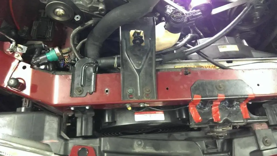

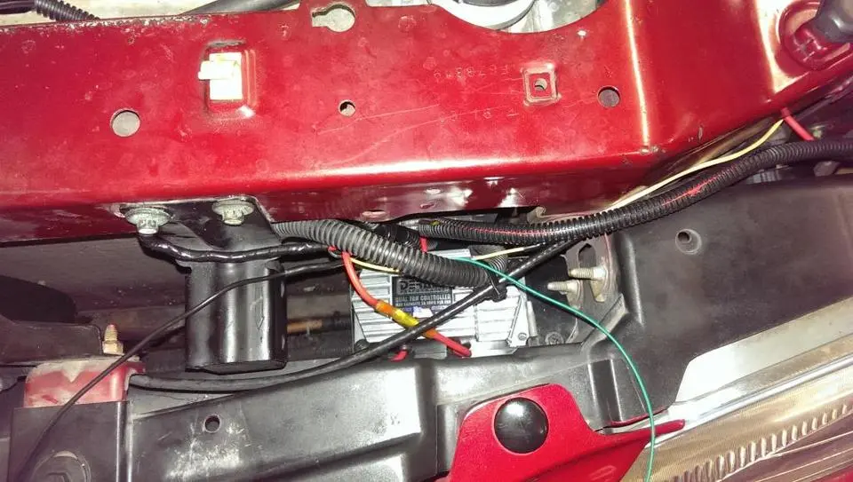

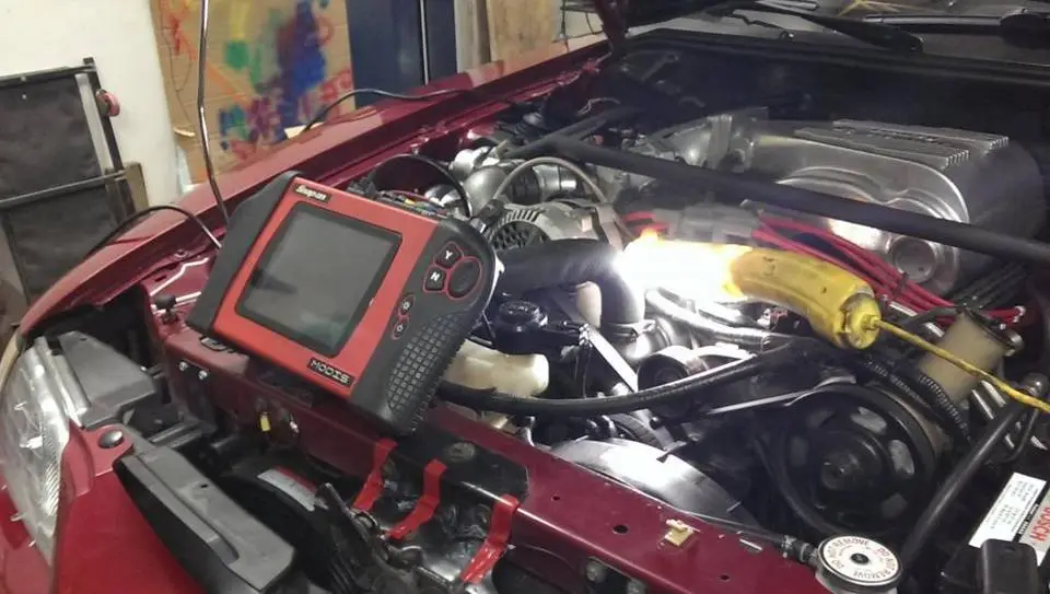

Installed pusher fan and controller last night. Worked about 3.5 hrs. to 10:30 and quit, still need to run power wire from fan and hook up a couple controller wires.
