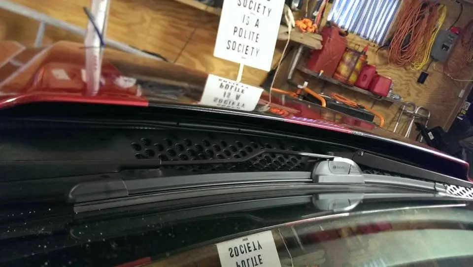

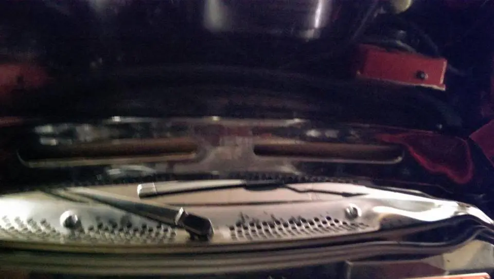

There are vents near the front of the hood on the GT500 models that are designed to allow hot underhood air to escape. They also allow the electric fans on the radiator to work more efficiently by venting the hot air that the fans have pulled through. If you position the vents right above the space between the radiator and the engine, any water from rain or carwashing will just drip onto the ground and not harm any underhood components.

Thanks for the input.. Have vents in the fiberglass Cervinis hood up by the cowl, it is also raised an inch or so.
I would think that would help??
