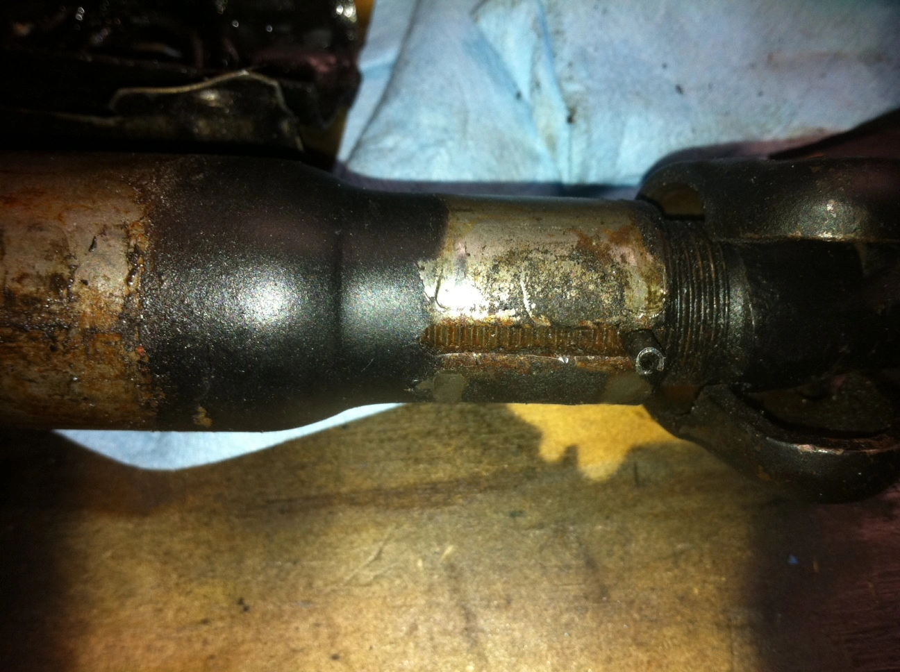

Falcon79 Active Member Apr 6, 2009 214 8 29 Dallas, TX Apr 3, 2012 #1 Apr 3, 2012 #1 I'm trying to remove a busted up Bendix control valve from my center link, the only thing stopping me from unscrewing it is this little stop pin. Does anyone know how to take it out without damaging it or the centerlink? Attachments pin.webp 355.8 KB · Views: 183
robbz28 10 Year Member Sep 23, 2009 775 5 39 Epps, LA Apr 3, 2012 #2 Apr 3, 2012 #2 Take some vice grips and give it hell....mine popped right out with a little wiggling, I had to get a new pin to replace it afterwards.
Falcon79 Active Member Apr 6, 2009 214 8 29 Dallas, TX Apr 4, 2012 #3 Apr 4, 2012 #3 I came, I saw, I conquered.
