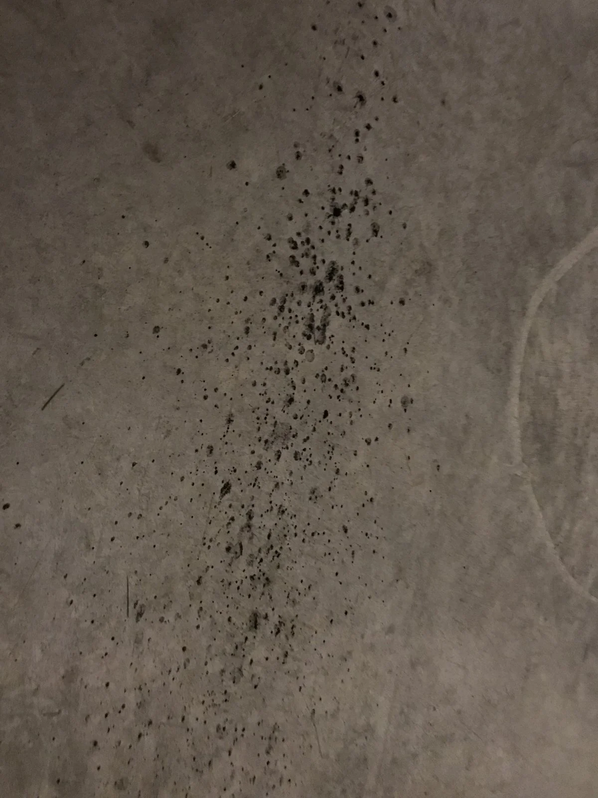

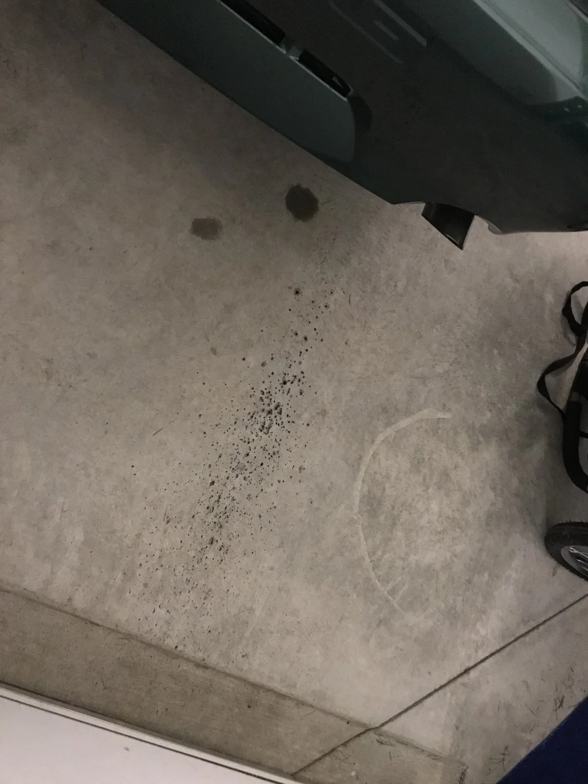

I was thinking that maybe it is gummed up with carbon and so I ran some Seafoam through it and while it didn’t fix the problem as of yet, that side of the motor is really dirty. After I pulled back in the garage it left speckles of carbon on my garage floor(attached pictures) just from idling but only on the side I’m having issues... my question now is do you think it is carbon buildup that is causing my problem? Should I run Seafoam a few more times to try to fix or should I pop the valve cover and take a peak? Any advice?

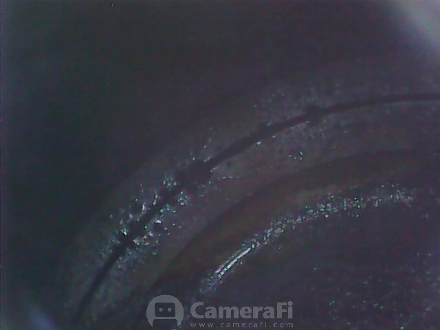

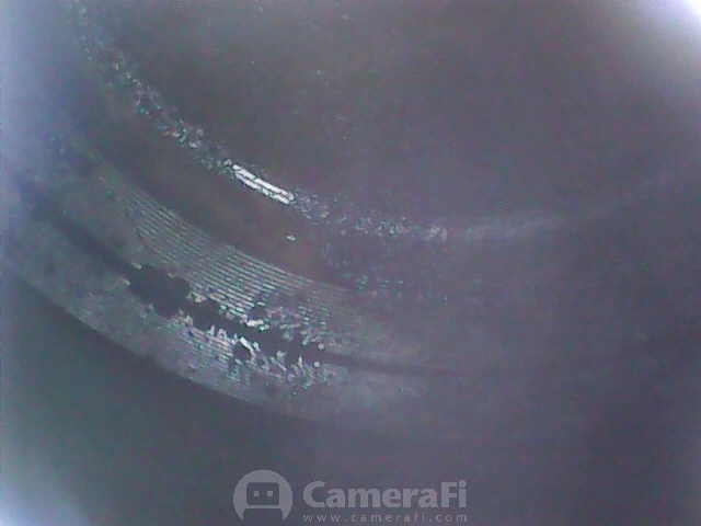

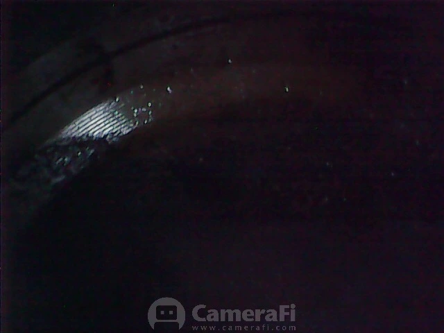

I have a borescope and there is a decent amount of carbon buildup on the piston heads... is there a good way to see the valves with the camera? I thought about taping it to its own wire so I could look up there but I’m just afraid of getting it stuck.. suppose I could try. I would just need to make sure the intake valve is open... I’ll attach some pics of the piston heads pre Seafoam

IMO there's a real possibility that your low compression is from carbon build up.
I work with a guy who used to be an aircraft engine mechanic, he said that I could pull the valve cover and lightly tap the valve with a hammer with a piece of wood or something in between so you don’t damage the top of the valve and that may break the carbon free. I may try to treat with Seafoam a few more times to try to break it loose without taking anything apart. If I can’t get it loose I’ll pull the valve cover..
In the meantime I may try to get the camera in there to see if I can confirm that carbon is my problem, but I’m fairly certain that is the cause of my issue.

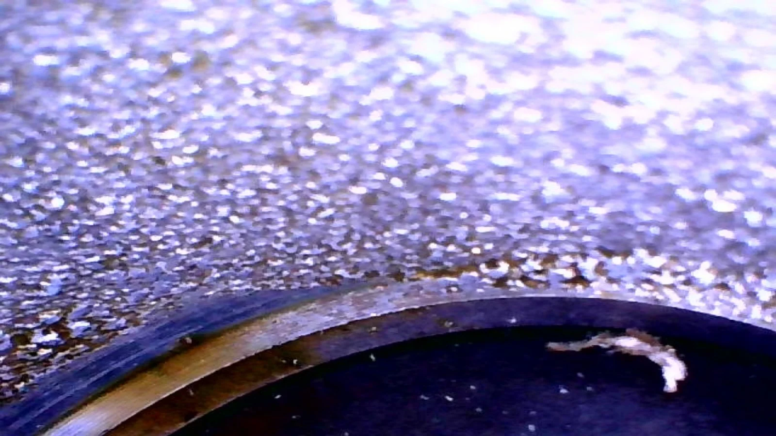

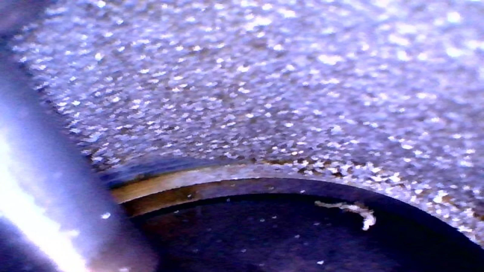

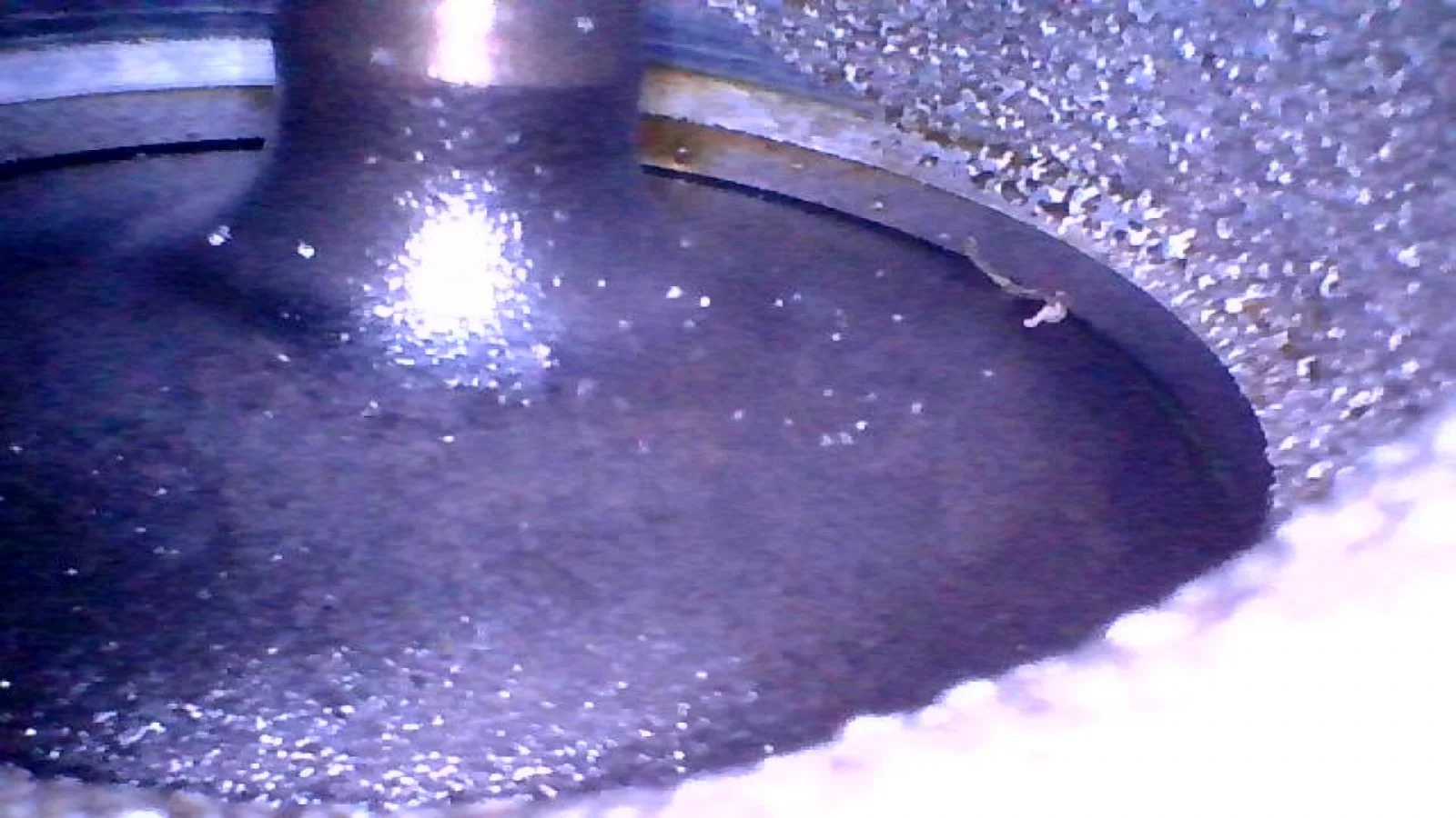

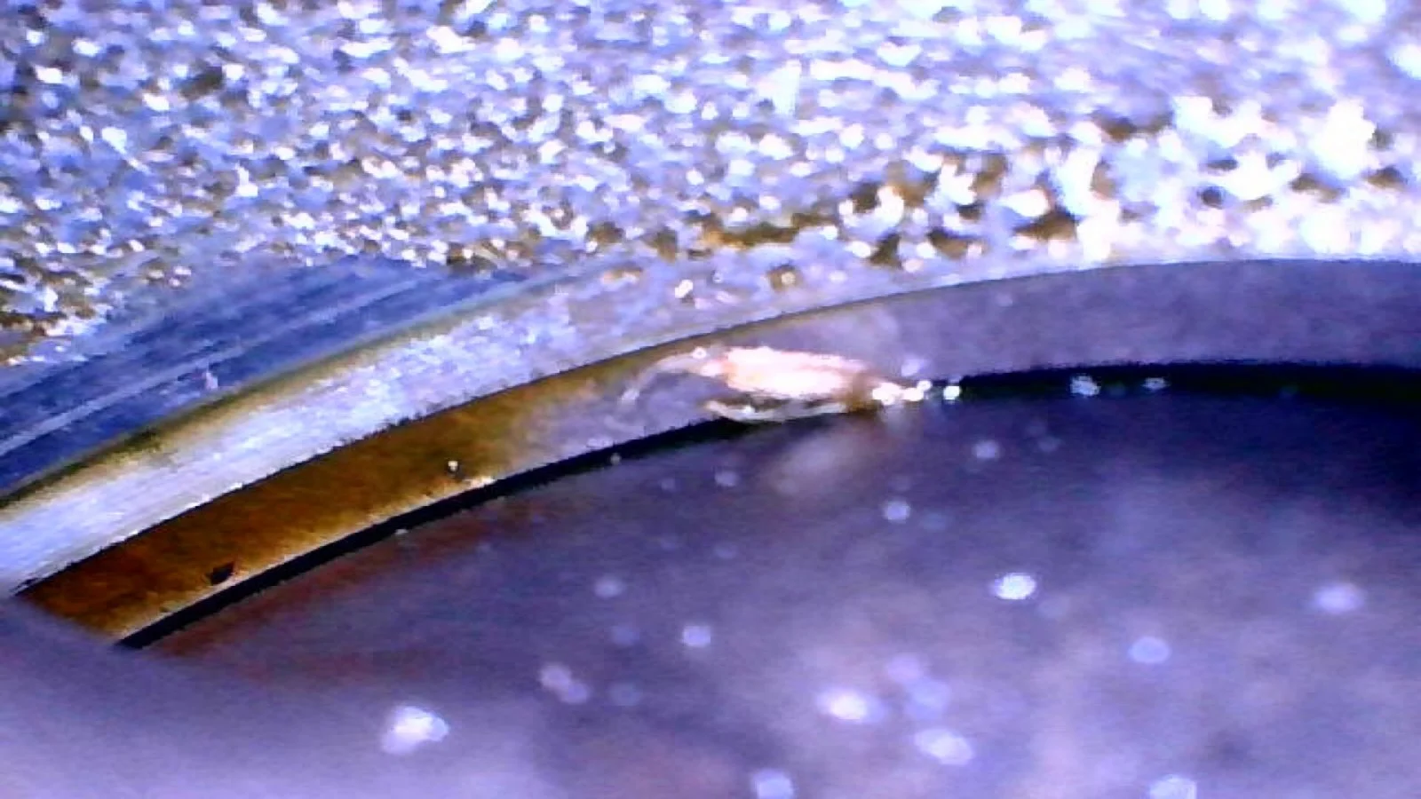

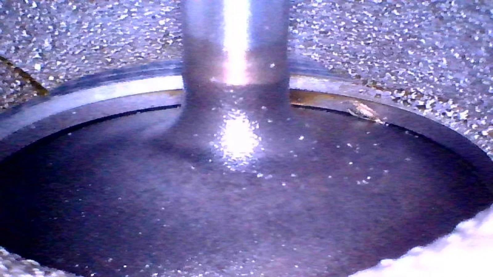

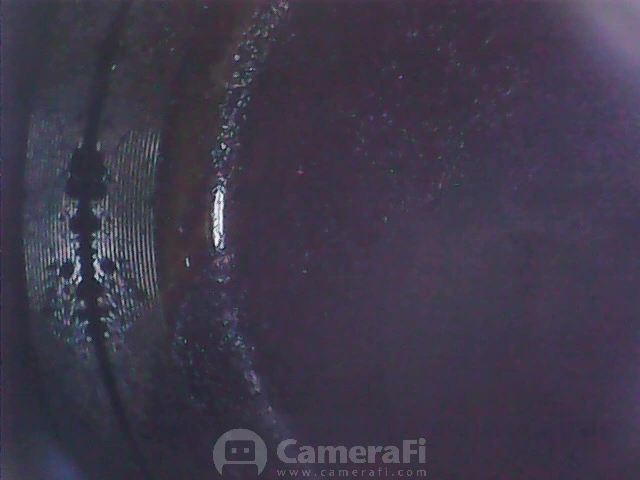

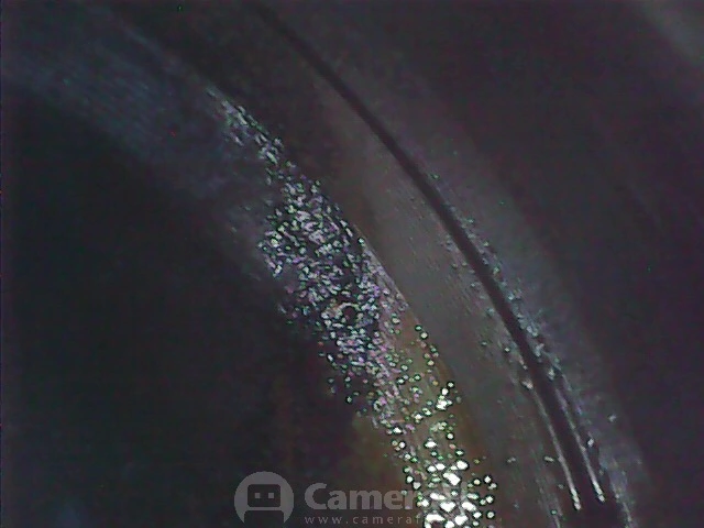

Injectors pulled and got some pictures with the borescope. Looks like there is some debris on cyl 3 intake valve, see pictures. Is it possible that this is causing the issue? Not sure how to get it out either, tried using the hook attachment on the borescope and I dislodged it but don’t know how I’m going to get it out... any ideas?
