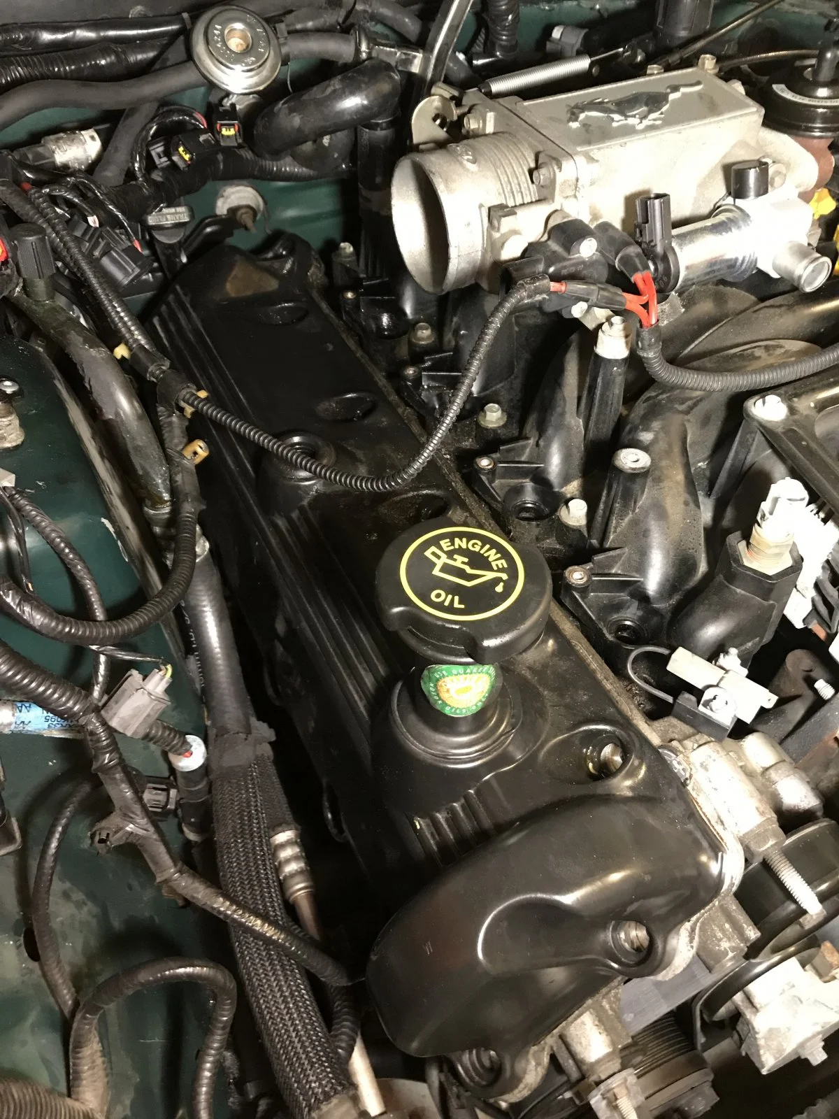

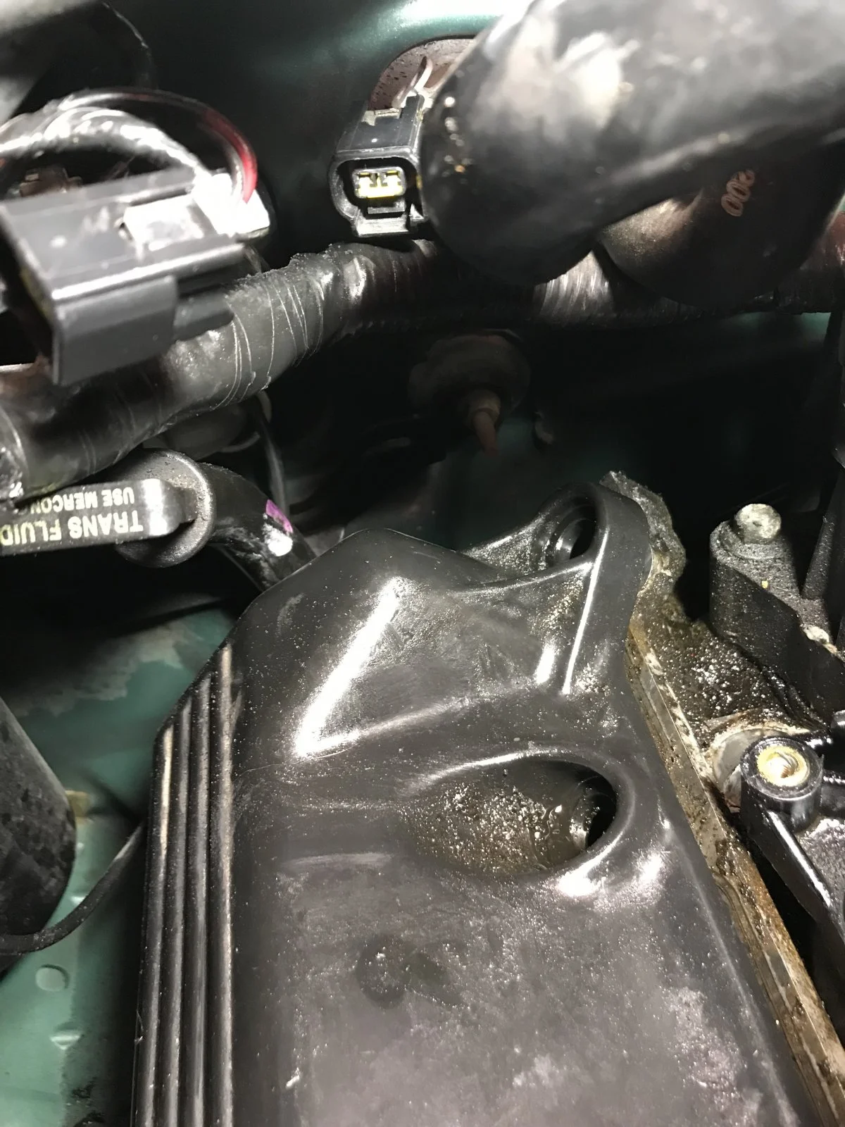

Ok so I got all the valve cover bolts off but I can’t seem to get the cover off all the way... the dipstick for the trans fluid is in the way. Not sure how to get it off, any advice?
wmburns
SN Certified Technician
Aug 14, 2009
5,892
514
204
Houston Texas
May 21, 2019
#24
  • May 21, 2019
  • #24
It is possible to remove the transmission fill tube. However the bolt that holds the tube is kinda hard to get to.

#25
  • May 21, 2019
  • #25
Comes out on a 5 speed car! As far as ease of going back on I can’t tell you. I ended up pulling the engine and figured ill just put it back on before the engine goes back in.
Oh and I believe you have to like roll the top toward the strut tower to get it over the cams caps or something. From what I remember seemed like it could only come and go one particular way.

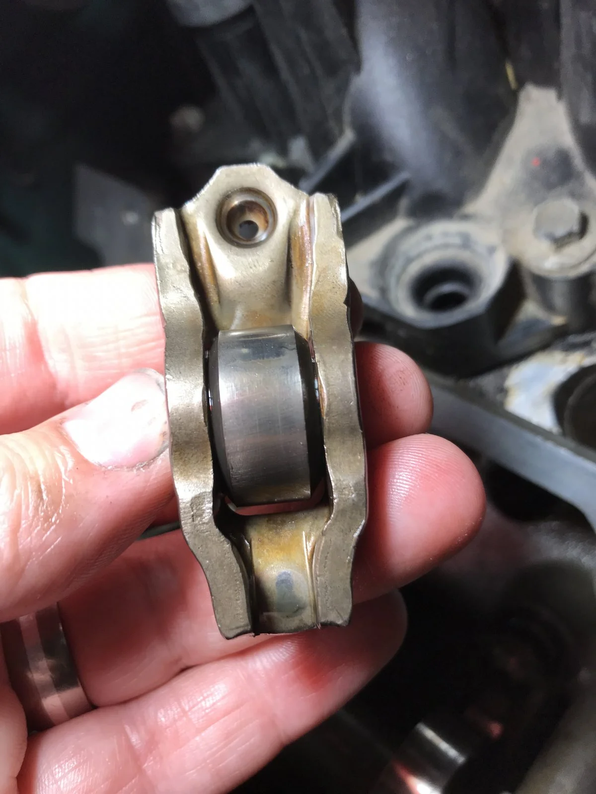

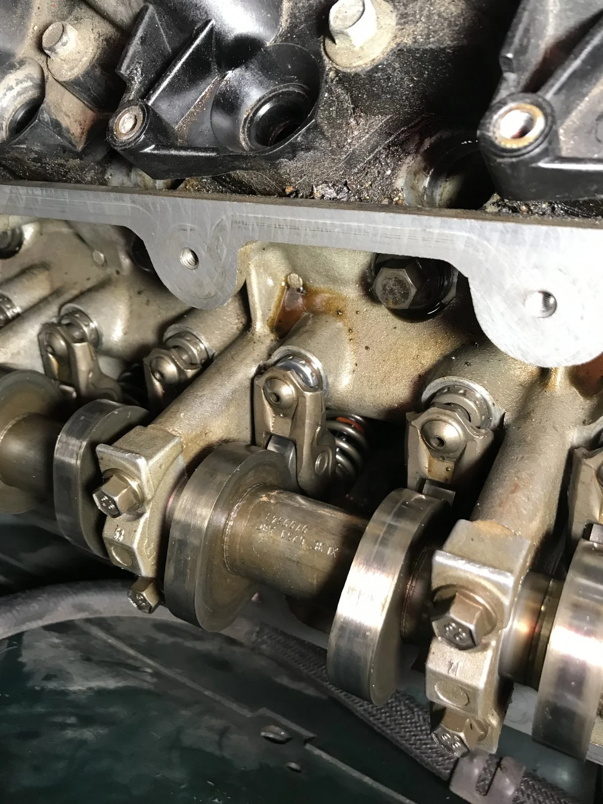

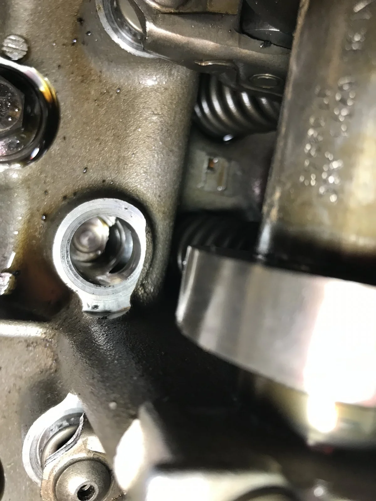

OK I have more info and I did find an issue. Got the valve cover off and pulled the rocker arm and lifter out. Put air on the cylinder and IT SEALED!! So that gave me hope that the valve is OK. I noticed when putting it back in, that my valve lifter was higher than all the others. Pulled it out again and it is stuck up all the way and will not collapse(its seized). So at least I found that I have a bad lifter and I thought that was the problem. I put a new lifter in and reinstalled the rocker/roller. Compression test again, and it is still leaking through the intake valve. Take the rocker/roller off and it seals and I have compression. I tried swapping rocker/roller with another position that is working and same result. What else can I try. I may have a weak valve spring? Do i need to get the motor running for the lifter to work properly and get the proper oil pressure on it to work? Any other ideas or tips would be appreciated!

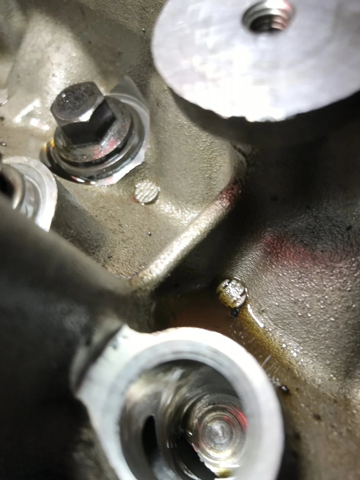

Suggestion. Look down inside the valve lifter bore to see if there's any debris or sludge that might be preventing the lifter from seating all the way down inside the head. Also look for any burrs or other metal defects around the edge of the lifter bore.
Your motor has metal shavings inside that came from somewhere.
Some pictures might help as well.

I think the valve lifter bore looks ok I’ll post pictures... I can’t see anything bad but I’ll post pictures and get your opinion

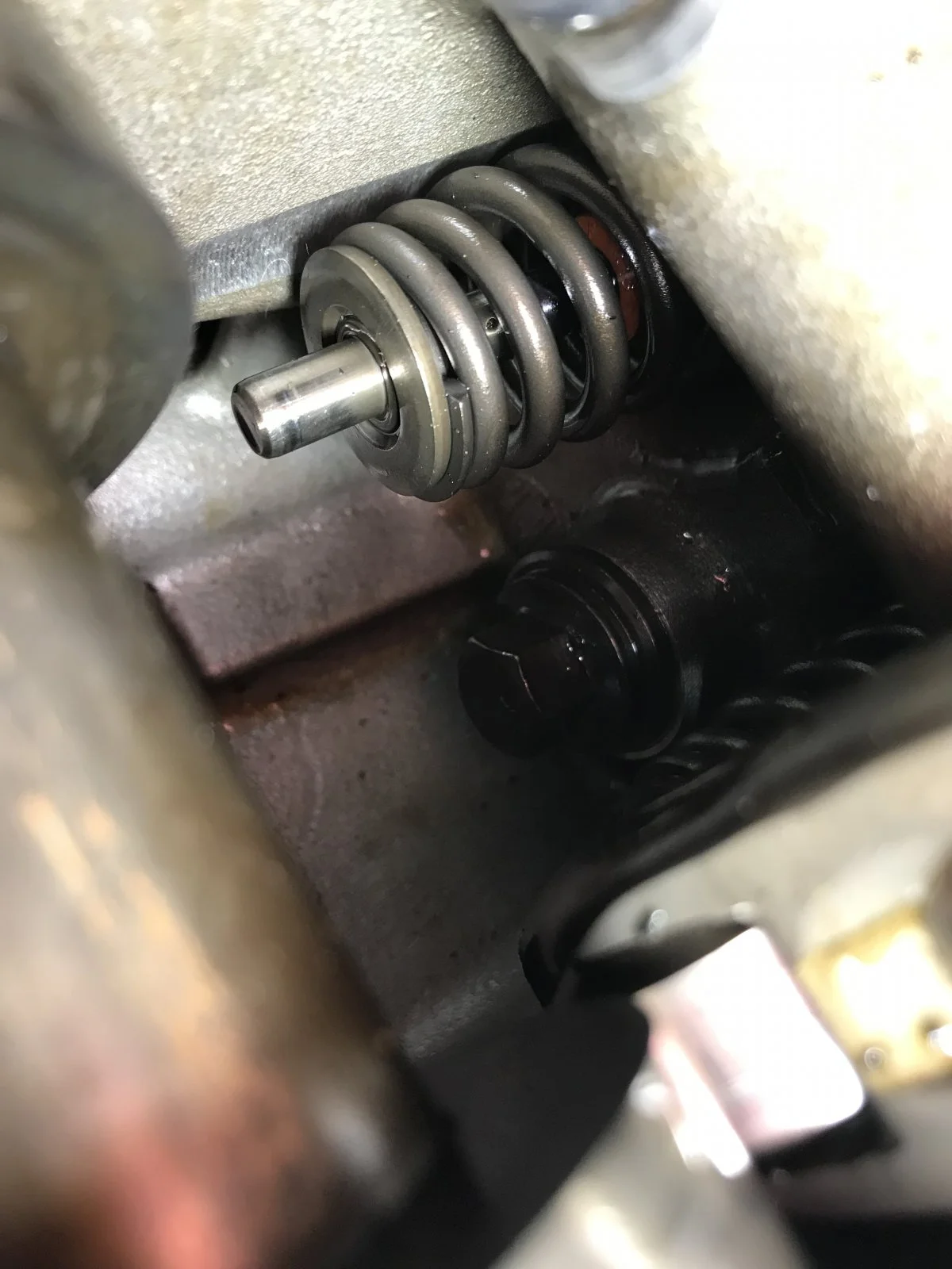

So I thought replacing the valve components would lead to a fix... replaced the spring and retainer, the lifter/lash adjuster. Also replaced the rocker roller. Replacing all this made it worse. Now instead of 30-40 psi compression, it’s now 0. Still boggles my mind that when I remove the rocker roller the valve seals. Don’t know what else to do now other than new heads or possibly cam shaft... any ideas?

So I wanted to give an update. I ordered a new cylinder head and installed. Fixed the issue and it runs great now. I looked at the old head but nothing was obvious so I may have a crack somewhere that I cannot see. Thanks to all who gave me advice!
