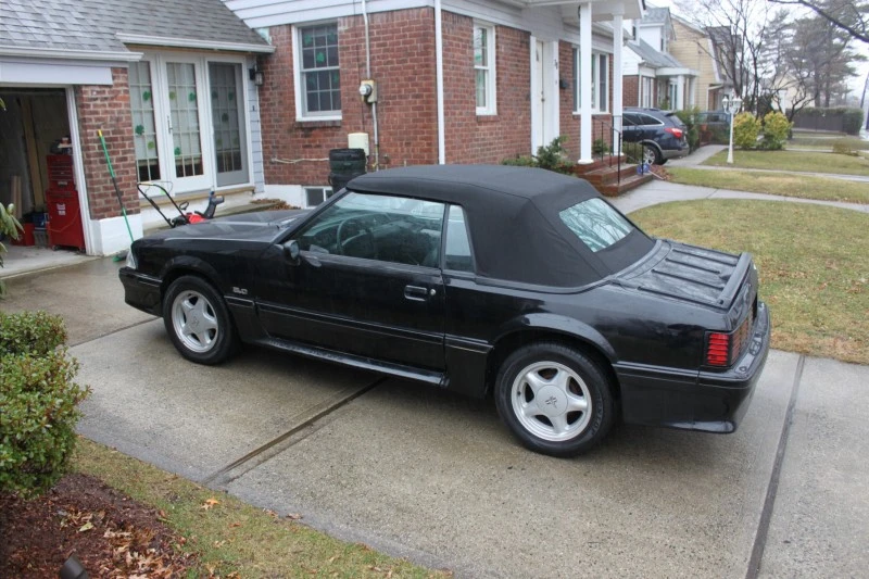

The paint on my 92gt pictured is mostly original. The bumpers and fenders were repainted at one point by a previous owner and the quality was not good. The fenders have tiny hairline cracks in paint and the bumpers are a tad darker then the rest of the car. I did alot of clay bar, buffing and polishing. The rest of the car looks very good. I am toying with the idea of having just the fenders, bumper covers and ground effects resprayed. Some may say get the whole thing painted...but a good portion of the original paint is very nice. Am I crazy? I think 1500 from a good shop for respraying the bumpers, fenders and ground effects would be fair. Maybe even have them pop a couple small dents and paint the mirror covers and windshield trim while they are at it.

Yeah, I would have the whole thing re-painted but that would cost over 3k I assume. I am definitely not dumping another 3k into a car i spent 3k for last year and put 3k into already (alot of that was for a new top). The car just wouldnt be worth 9k. Except for the plastic and fenders...the paint is in good shape. I have a day off coming up and will go around and get some prices. Will let you know what I find. Talking to body shops is always entertaining in my neck of the woods (staten island NY)

It now looks brand new, in my opinion if you wanna save your money paint the bumpers, they're black I assume from the picture, how bad could it look? When your ready to spend the money on the whole car you'll be able to do it right.
