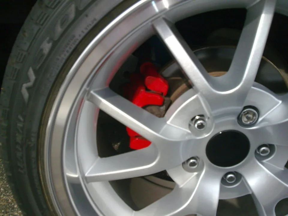

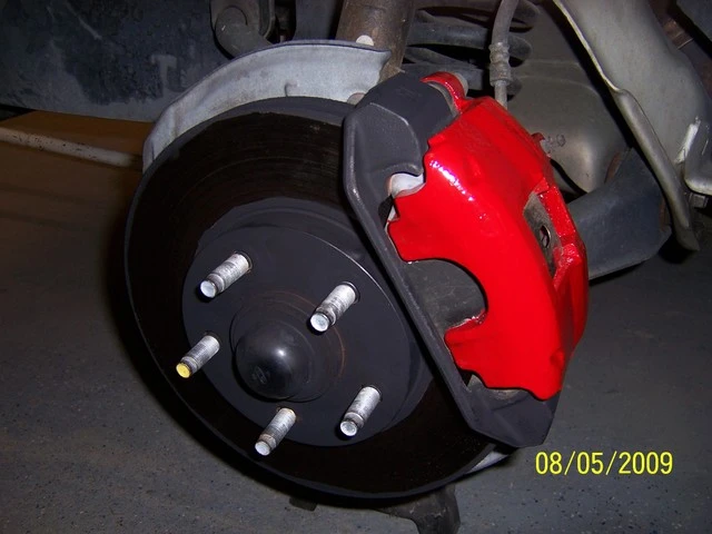

All in all, I thought it was worth it. I've included a few pics and you can decide for yourselves.

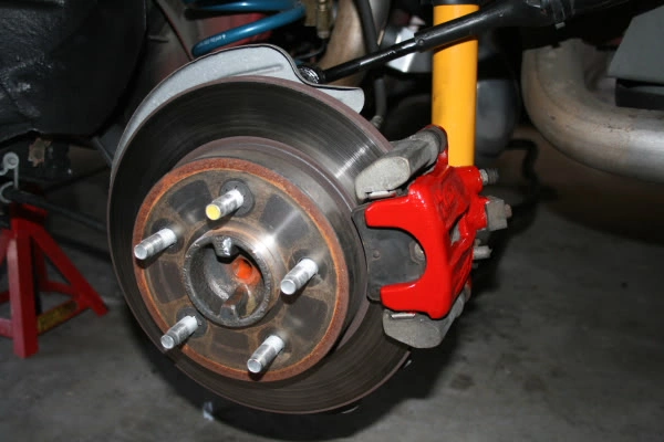

Rear Caliper

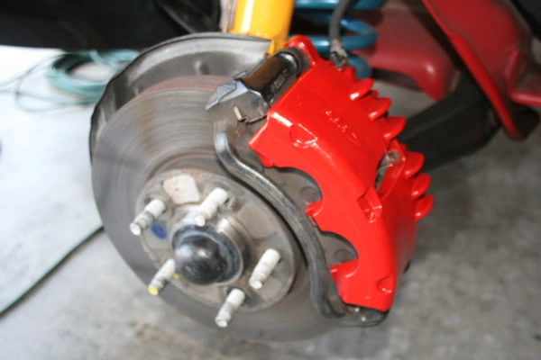

Front Caliper

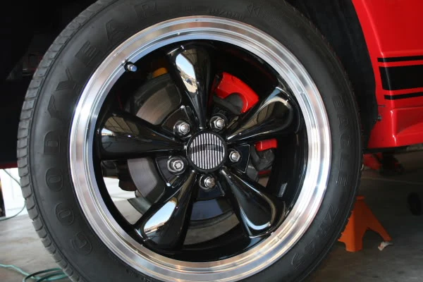

Front with the wheel on...
As it sits...
