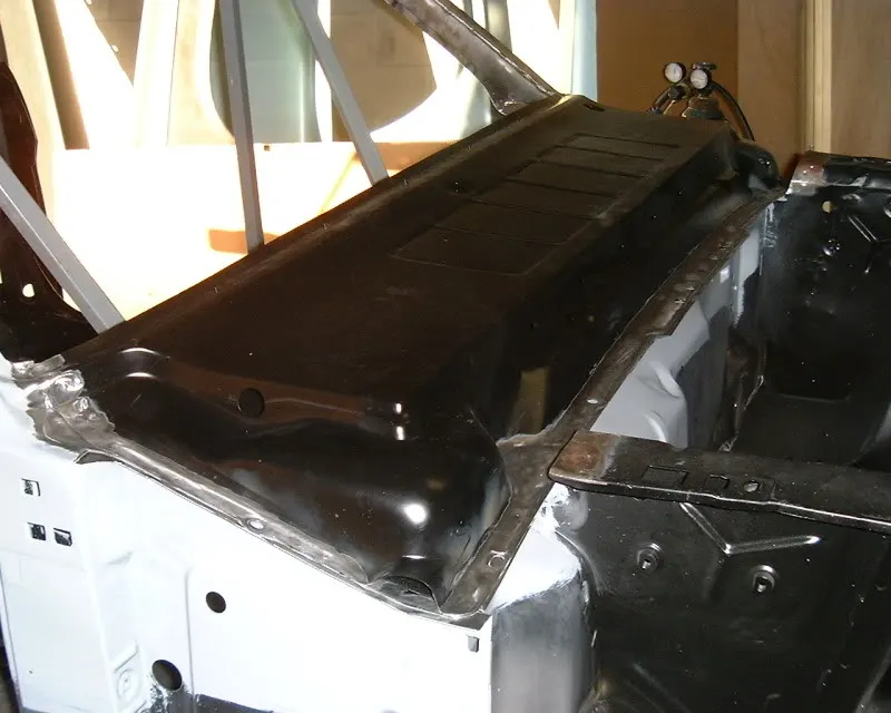

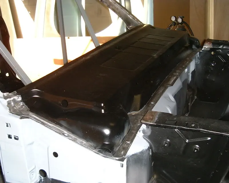

I agree, the car looks great and I also love stripes below the doors. With the cowl closed in does it affect the heater in any way? Did you have to cut out all the vents in the cowl and weld in a piece of metal? I need to do something with my 65 and not sure how I want to go.

To fill in the cowl on a 65 make a patch for each panel and use panel adhesive to attach no chance of warping.

Thanks everyone....im seriously considering no stripes....it looks better and better to me without them all the time...plust now that the a$$ of the car is up, the front nosed down a little, car actually sits like its supposed to! Anyway as far as the heater, no problems. The heater will just pull air from your cabin and recirculate it....it will suck air from your fresh air vent and blow it out the heater.....plus you also have those water vents that can draw a little "fresh" air too. I put a Vintage Air gen V system in mine, it blocks off the cowl completely and just uses cabin air.
