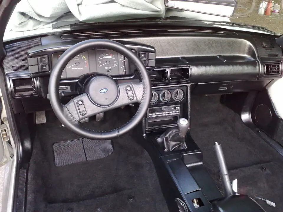

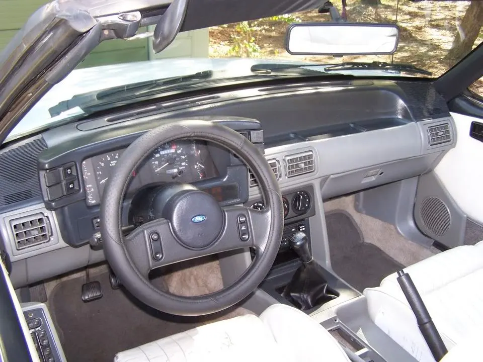

duplicolor and sem both make quality and durable interior paints. The duplicolor can be used on vinyl and hard plastic. Don't forget that when you use any of these products to use the adhesion promoter. SEM and duplicolor makes this product.
Here is my car with duplicolor. BTW I have done other cars with duplicolor and the paint has not faded or chipped off after years of use. Another note, don't try to reassemble the parts until a couple of days after painting or the paint will chip because it hasn't cured yet.
After:
Before:

man that after pic is awesome. the before pic is what my interior look like right now.
