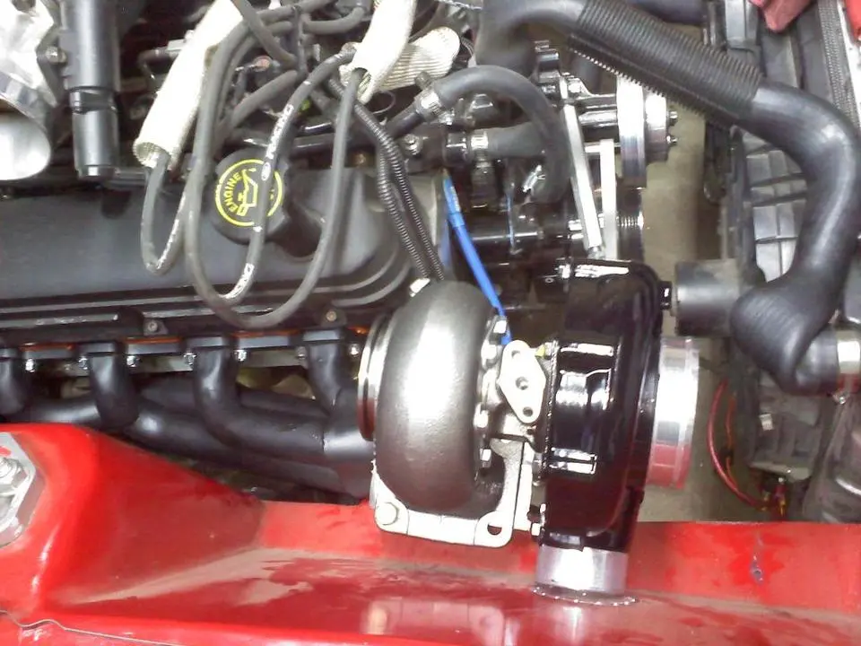

Looks good. If On3 would have had a twin setup at the time we might have went that way. One suggestion, we could not get away without ceramic coating the hotside, as we started to see paint failure, even with header wrap.we ended up loosing about 100 degrees from the painted to the ceramic.

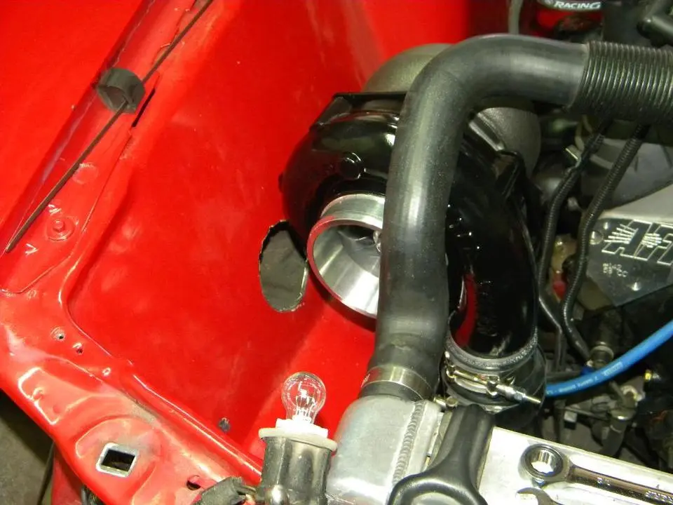

As for tonight didnt get really nothing done,i need to get a 3" hole saw to drill the panel for the coldside.Went to dinner with a buddy and my daughter and missed sears by 10 minutes of closing time.peace
