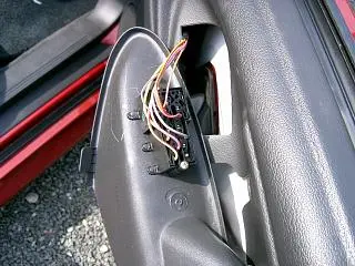

Took about 1 minute to install the new Switch
WORKS PERFECT :nice:
Switch Panel pops off (no tools needed)
Remove Switch assy (by removing 2 philip screws)
Pull Old Switch out (no tools needed)
Pop New Switch in (no tools needed)
Re-Install the Switch Assy (2 screws)
Pop the Panel back on
