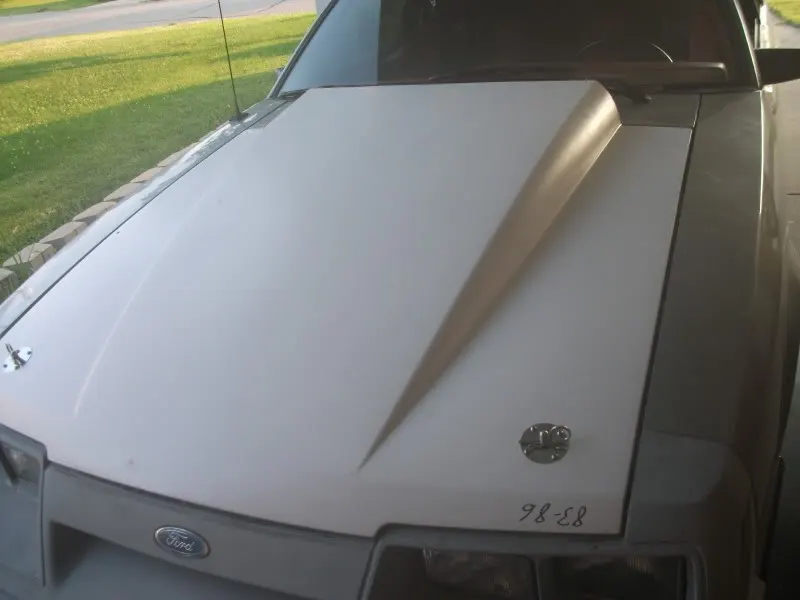

I had to go to the junk yard and buy two hinges since whoever put the pin on hood on the car removed the hinges. I bolted the two hinges on, bolted the hinges to the hood...had to slide the hood forward a little on the hinges and it was lined up nice. This hood is VERY well made, it has an outer skin and an inner skin so its just a little bit heavier than the thin pin on hood that I took off.
But everything lined right up, the hood latch and safety latch lined right up, in fact, I dropped the hood down to check the lines..and it latched.. then when I went to pull the hood release...found that the hood release cable is rotted and broken somewhere. I had to go in through the grill and unbolt the latch to get the hood back open...lol. Instead of going back to the junk yard for a latch..I decided I was just going to pin the front and for go the latch. I planned on pinning the hood as well anyway for safety reasons.
The hood its self is gel coated and is smooth as silk, probably too smooth to paint it would probably need scuffed up a little, just a wet sand. It has a little bigger gap on the passenger side than the driver's side, but that is due to my fender , and not the hood. My passenger side door hinges are sprung slightly and it makes the front of the door stick out a little...and instead of replacing the hinges...somebody adjusted the fender out to meet the door which increased the gap...the pin on hood looked the same way..
But all in all it was a very easy install...and the fit looks pretty dead on.
