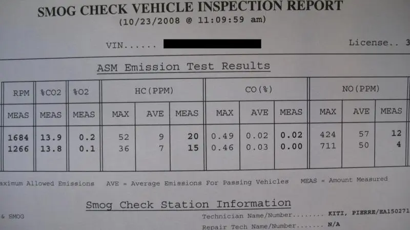

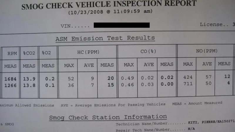

This is for people using search to figure out if they can pass smog with cams. Basically - yes. I'd suppose even stage II cams could be viable with these results (:mad: for not knowing).
Using stock 6 cat mid-pipe.
Mods:
MMR stage II heads (231/200cfm)
VT (CMS) stage 1 NA cams
Comp cam beehive valve springs
PI intake
Every bolt on besides LT headers which are illegal here.
3.73's
i also use Soltron every time I smog my car, it helps with CO emissions.

Nice job on passing, running cleaner than a Civic is doing pretty damn good...:nice:
