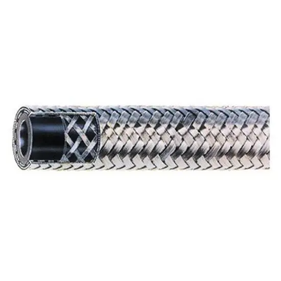

- Part# 2 - 8 AN Braided Stainless Steel Fuel Line Hose 3ft (I wont use it all) $12.66 Ebay

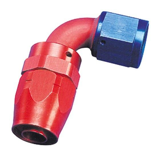

- Part# 3 - 2x 8 AN Hose End 90 Degree (from Russell) (Part# 610170) $20.98 total on Ebay
