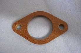

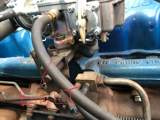

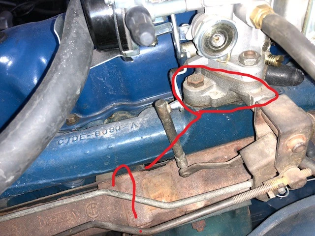

Question #2: I am having some vapor lock issues so I purchased a phenolic spacer on ebay. Looking at my carb set up I see the connection from the car to the intake manifold but there is some bracket or connector between the intake and the carb. What is that connector piece? Will I be ok installing my spacer with the current set up?

Looks good! #1...nothing should be hurt...running with pcv preferred...hook it up. #2...the spacer/linkage mount is exactly that, and allows an additional vacuum port...looks like the spacer goes between the carb and mount...as long as there is no bind in the linkage or air cleaner clearance issues, you are good to go. Additionally, trace your fuel line back and ensure it is not close to or contacting a heat source as that may contribute to your vapor lock.

My spacer came in so I wanted to see how it would fit really quick after work. The hood clearance was good, I tested with silly putty.
However, the bolts on the intake are not long enough. Can I just get any bolts from a hardware store or auto parts store to replace these? Also how do I go about removing them? I am guessing I have to take space/linkage mount off to access the bolts.

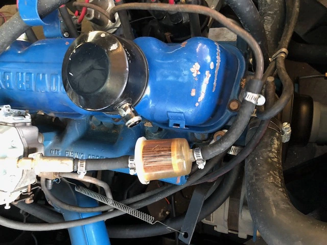

Secondly, when digging into it I did notice that the fuel filter is located a little close to the cover. See the attached photo. What could I do about this?
Again all the help is appreciated.
