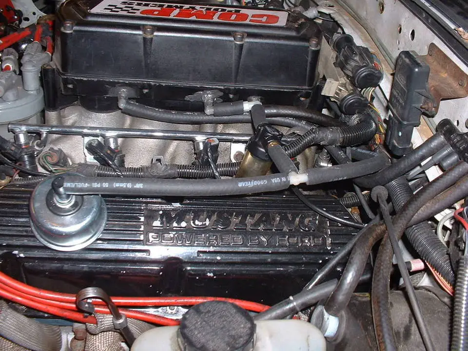

Below is my second pcv setup...
Keep in mind that even if you had perfect ring sealing, there would still be pressure buildup in the crankcase. This is simply due to the reciprocating action of the pistons.
