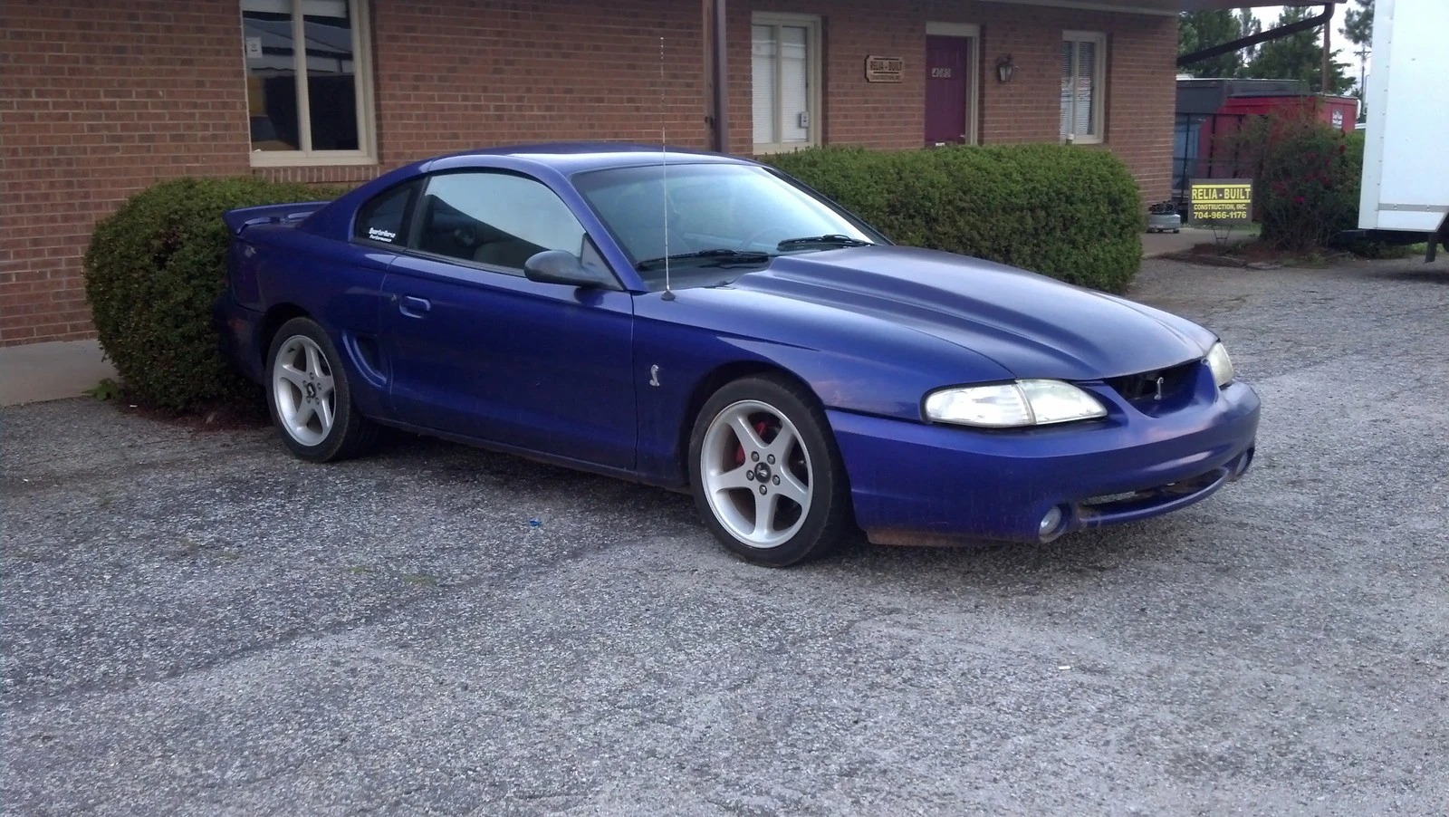

So...I've been out of the mustang game for about 4 yes now. I used to be part of the 4.6 side of stangnet. I picked up a95gt the other day with 161k miles on the car and 30k on the new crate motor installed by ford. I got it for $2300, and so far I put a new 5spd in it, and decided to add some extras, I installed a edelbrock upper and lower, 70mm elbow adapt, 70mm professional products TB, comp cams xe282hr cam, alum heads 190cc intake runners, 2.02/160 valves, scorpion 1.6 roller rockers, o/r h-pipe, and plan to have it tuned this weekend. My question is, is what type of numbers should I expect. A lot more then stock id hope. Thanks in advancce
