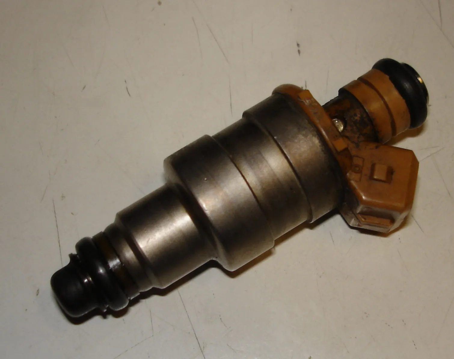

Here's the offending injector. I'm gonna clean it up a bit more and put it on my desk at work. The coil was gone inside. Checked resistance and it was completely open.

did the car have a idle issue like it had a vacuum leak?
Not really. It has a minor shake at idle and up to 1500 RPM. I had just done the 5-spd swap..so i thought i had something out of balance. It didn't even have idle surge. Up until the ECT **** the bed, it idled fine. Once the ECT died...i had issues with idle and starting it...which got me digging into codes and stuff and lead to the dead injector.
