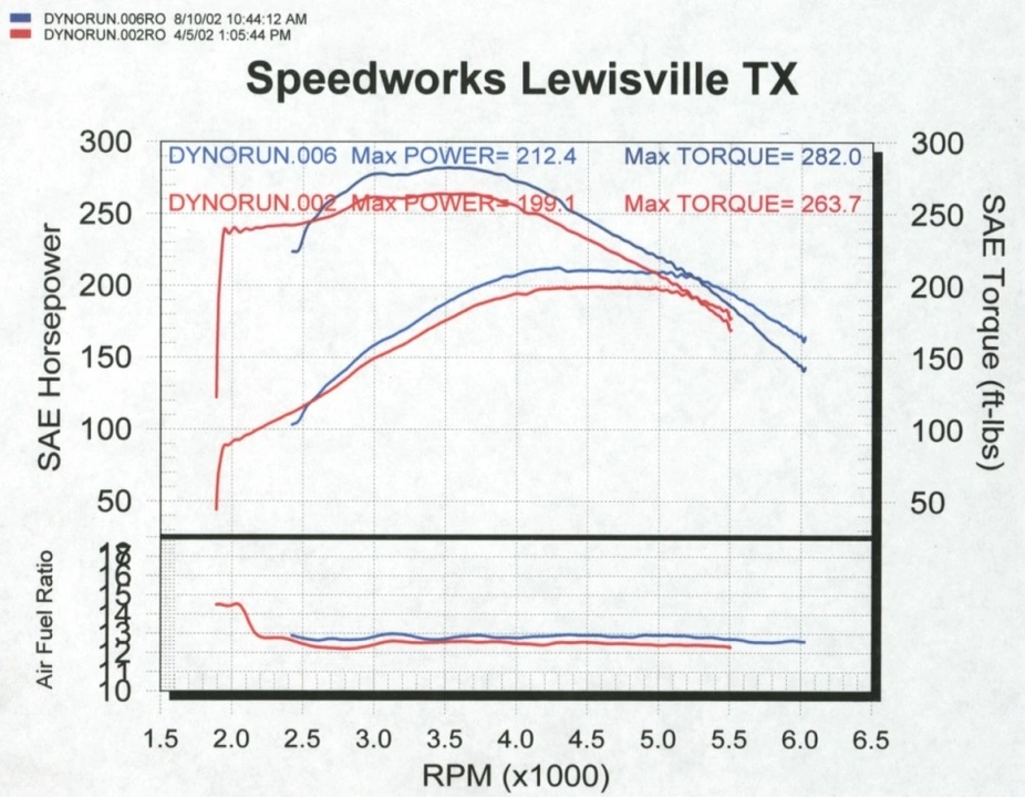

I'm the first person that did the camswap,and I did it at 175K miles using cams that had 20K on them.
This was the result-red is before,blue is after:

prsrizdgt said:
Hey Johnny, what kind os supercharger are you running with those cams?
None.That dyno sheet was after the camswap with the old stock engine @ 175K miles.
At that time I had the following done to the car:
Underdrive pulleys
Stock manifolds with compression bent 2.25" dual exhaust
Original NPI intake
75mm BBK TB
80mm L-MAF
SCT/InjectTech tune
I've got a set of Comps in the new engine...and as soon as I get the trans back together..it goes to the track.
