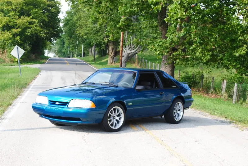

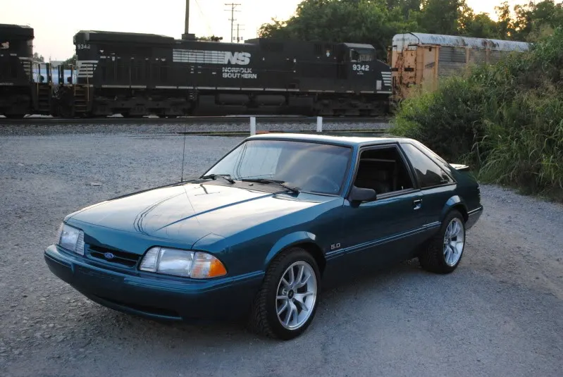

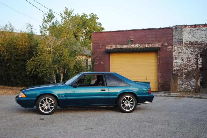

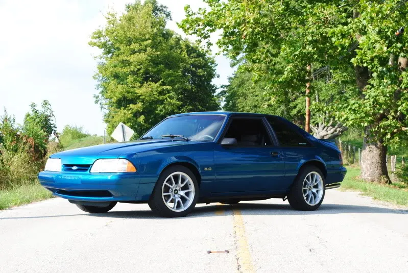

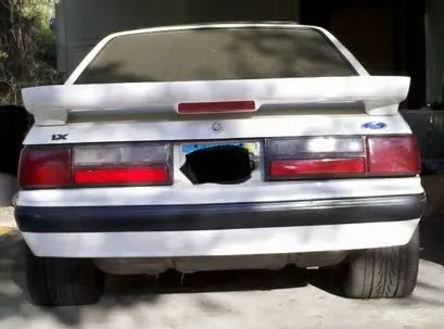

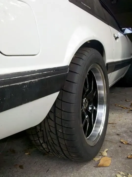

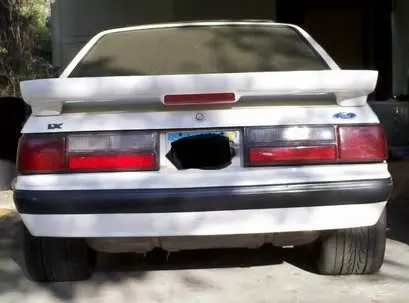

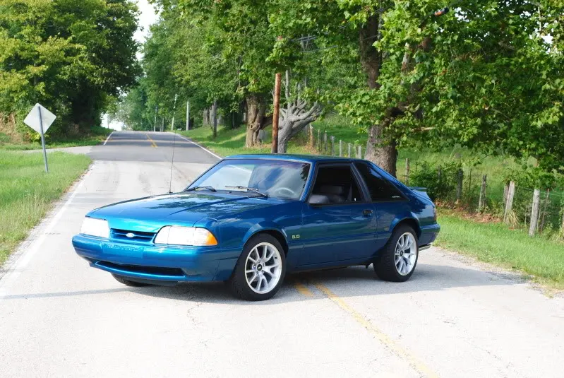

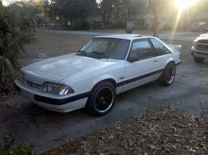

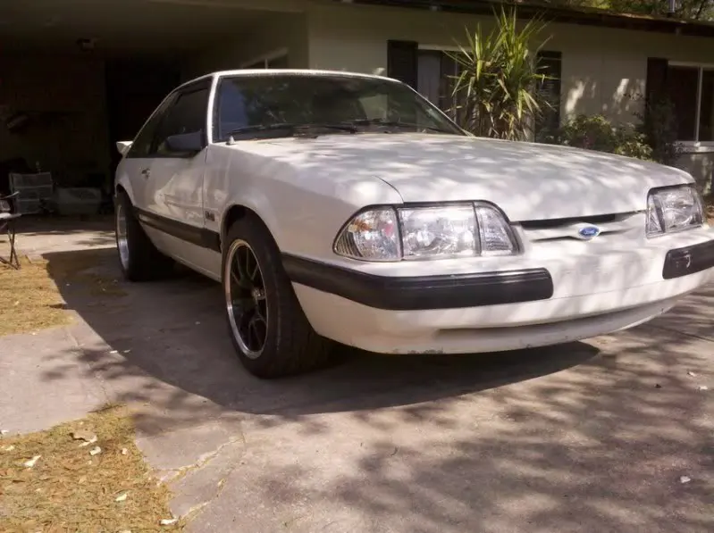

My car. 17x9 up front, 17x10.5 out back
what a pile :D

Yes, 315/35/17, a lot of pounding and rolling. It wasn't easy and I will never do it again. For a straight line or show car this set up is fine. I rub in the back if I take a corner too fast. Speed bumps are fine, but the bottom of steep inclines also cause me to rub. I could possibly roll/flair the fender a tad more but its going to take more than a baseball bat to do it.
You think with a smaller tire this would work out? like a 285? or would that look bad on a 10.5? And would a fender roll and minimal beating with the stock length axles and proper spacer if needed work? Sorry for all the questions, just been eying those exact wheels for awhile and haven't seen anyone running them. Nice car btw.
285 is really too small of a tire for a 10.5" wheel. I went with a nitto tire as they tend to actually run a bit smaller. My 315 is actually closer to a 295 in say a Michelin or BFG. I run a 1/4" spacer on the rear, fenders are rolled and the tubs have been beaten as far as they will go. Thanks for the compliment. The car is really super rough. Pics make it look 100x's better than it actually is.
