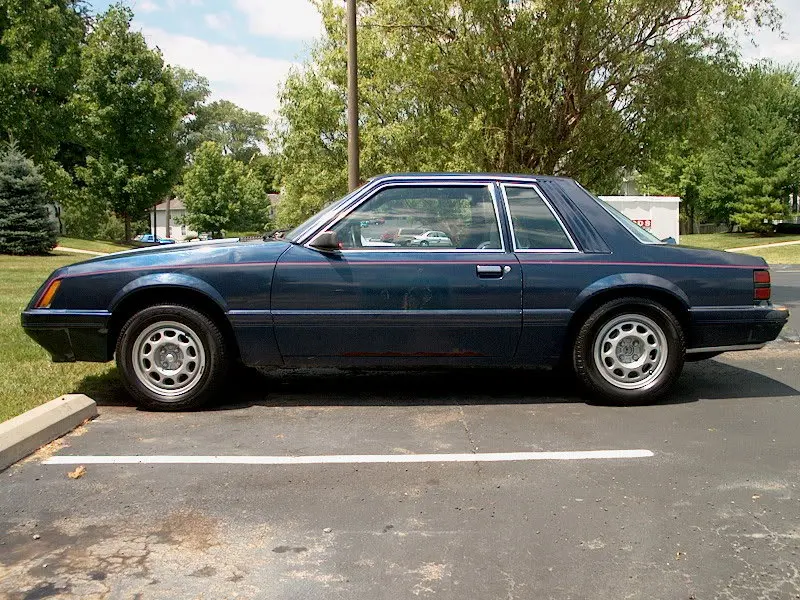

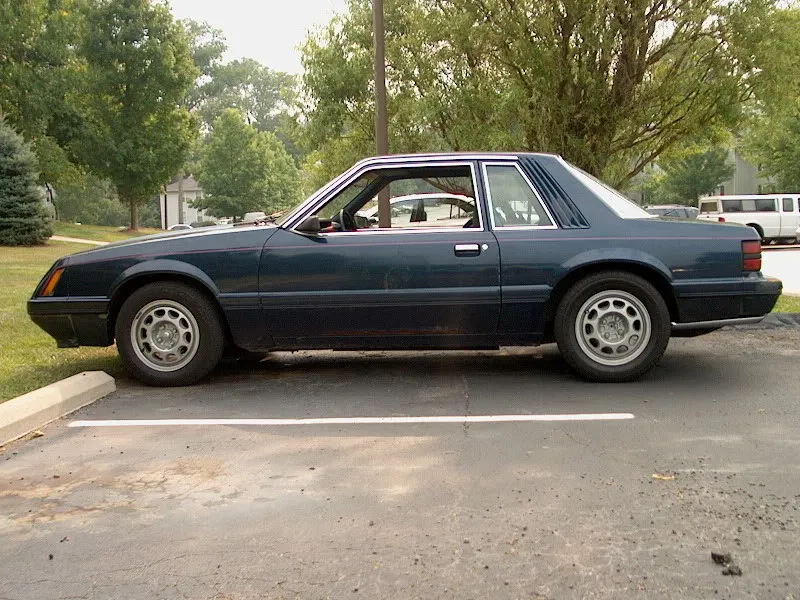

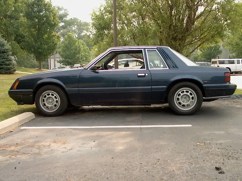

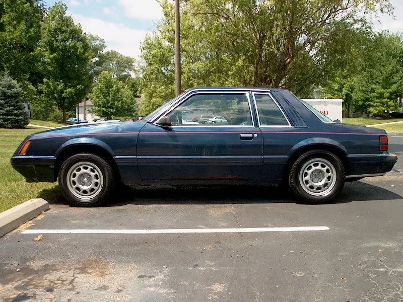

I don't mean to pic-hijack your thread but here's some old old old pics of my car with stock springs and then with the Eibach Pro Kit springs. This was taken right after they went on and it did settle down a little bit but not a whole lot. You can see that it's still far from slammed...i make it over speed bumps and such just fine and i've got full length headers hanging down now.
Before:
Notice how high and stupid the nose looks and how bad the back is sagging.
After:
