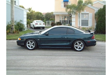

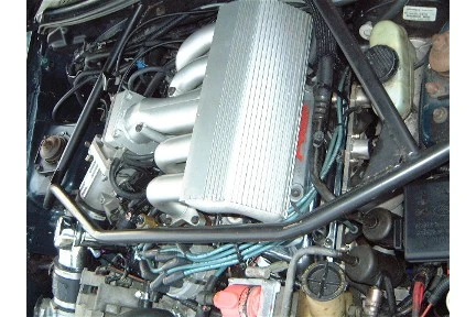

heres 2 pics. I go on a Mustang Dyno tomarrow AM. I'll post my numbers. shooting for 265-270 rwhp. which should be close to 290-295 on a Dynojet.
