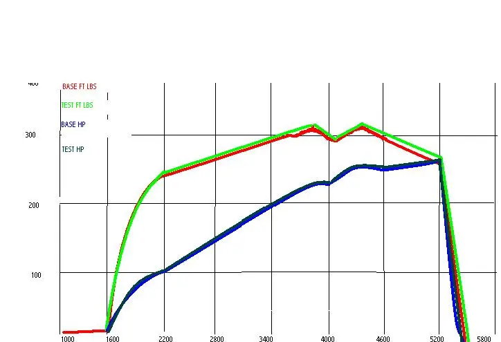

Things went great and not so great. Found out my WB was not reading correctly because of a shortcut in instalation I took.
Lesson 1: Solder dont use cheap splice connectors for electronics.
On a Mustang Dyno it put down
260 at 5200rpm
with 311 lbft torque
Air Fuel a 11.1-11.7 yes you read that correctly. on the graph you could see 2 missfires because of how rich it was.
I spent all day trouble shooting my WB. Because it was reading 13.4 at WOT. Fixded the conection and bam 11.8 at WOT just like the Dyno. Played with the tweecer Fuel Tables and got it to an accurate 13.5 again. For real this time.
So Yes Im sure my goal was reached now that AFR is correct. Im sure it would have layed down 280-290hp which should actualy be a lil over 300 on a dynojet.
so in a nut shell 260hp 311tq running an AFR of low 11's I am very pleased.

I can't believe you laid down 311TQ on a Mustang dyno. I made 312TQ with those heads on a dynojet. Your numbers would have been around 300HP/330TQ on a dynojet.

DRAWN DYNO CHART. Dont laugh at my art skills. Note misfire (s)
