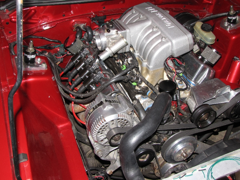

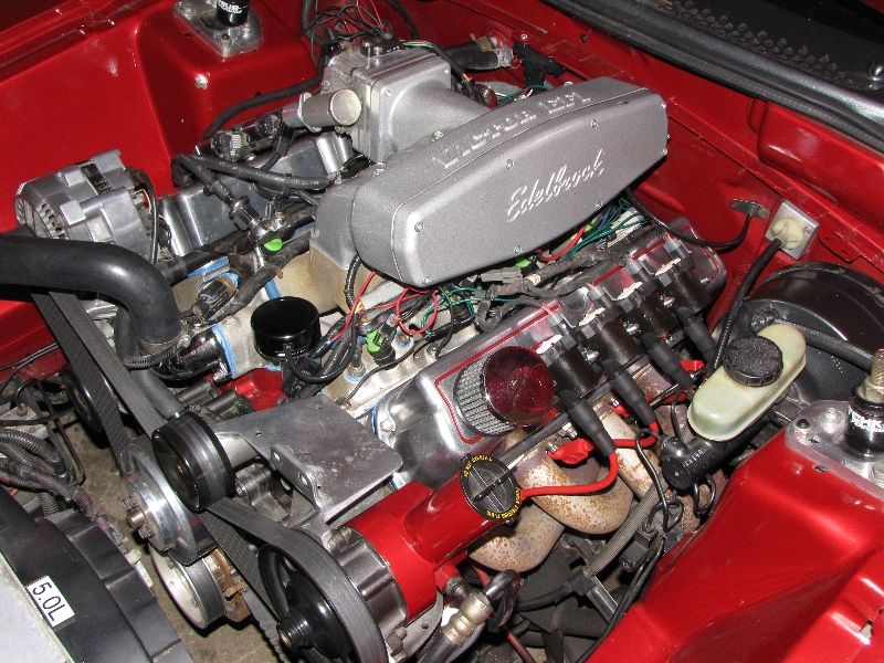

Pics of my current project. Going DIS

Quick update, got all the coils wired in and tested. :) Had to add $100 for some spark plug wires. :( I'm hoping they'll be here tomorrow so I can try to fire it up.
One more thing, it looks like the factory tach will not work with this setup. Sooo, looks like I need a new tach...Any recommendations? Something inexpensive would be nice ;)
Got it fired up tonight! :D The only issue I had was that I left the vac line off the brake booster...Couldn't figure out why it was idling fast, until I backed out of the garage and hit the brakes. :lol:
I got lucky on installing the EPM, the timing wasn't off far. I got it started after about three tries, and it was sitting at about 5*. :) Two sparks per revolution make setting the timing incredibly easy. It looks like the balancer isn't even moving.
I only drove it around the block once, but it's definitely a nice improvement. Throttle response feels better, and it's much smoother. It doesn't shake the car at idle like it used to, but my idle wasn't steady for some reason...need to work on that this weekend...I don't know if it fixed my high rpm problem yet, I only took it up to 5300. It's kinda scary running with no tach...

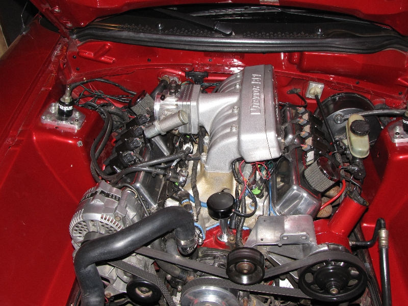

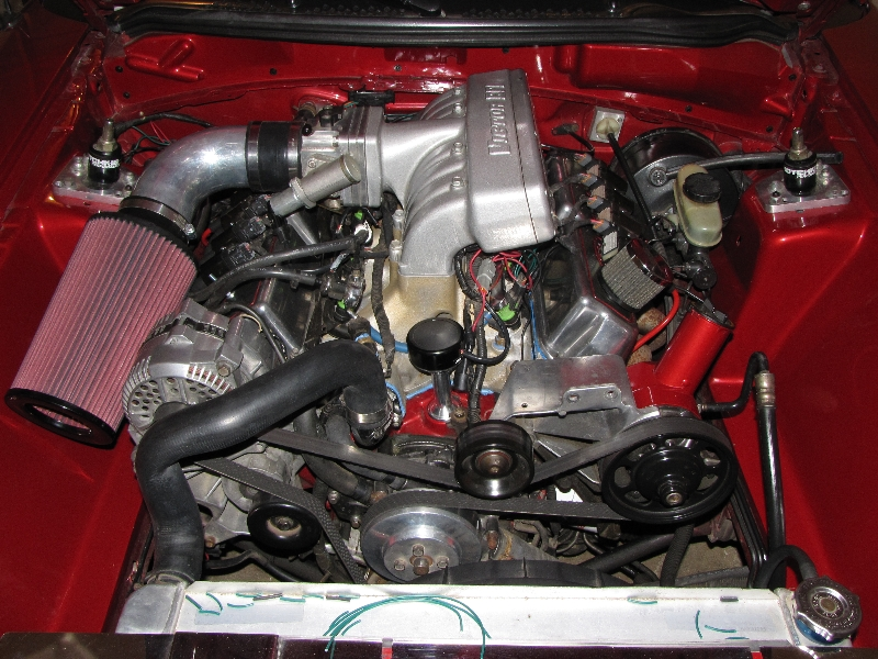

Here's some pics of the finished product. One of these days I'll try to clean up the wiring.
