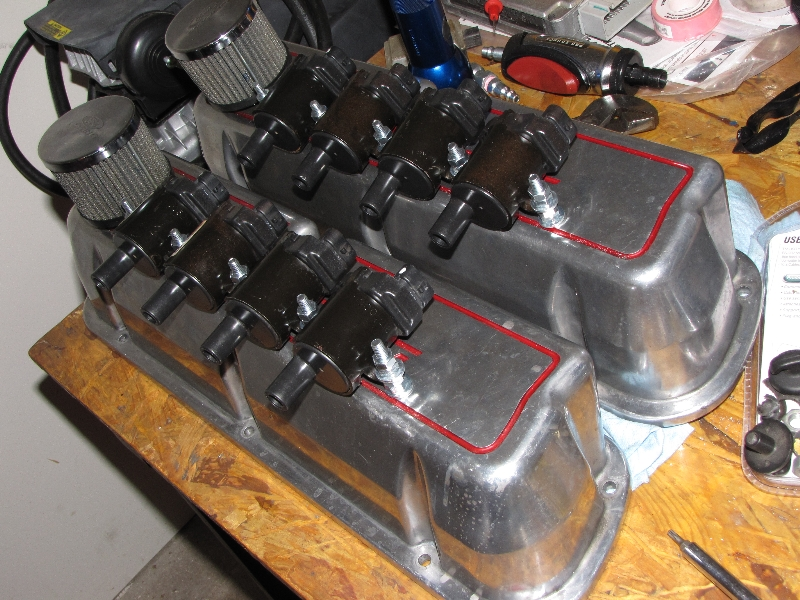

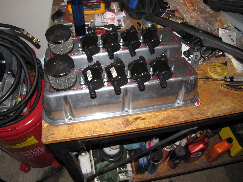

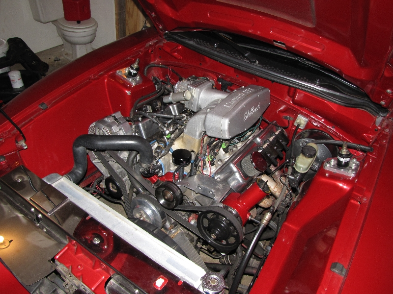

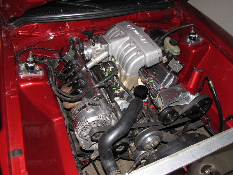

Got a set of 8 LS2 coils and an AEM EPM cam/crank sensor. I've got the EPM wired in, and I just got the coils mounted last night. I should get the valve covers reinstalled and start wiring the coils tonight. Going to try to have it running tomorrow. :)
This will be a wasted-spark setup, so it fires two coils at once. The AEM fires them in order, 1,2,3,4, so you pair them like this:
coil 1 = 1/6
coil 2 = 3/5
coil 3 = 7/4
coil 4 = 2/8

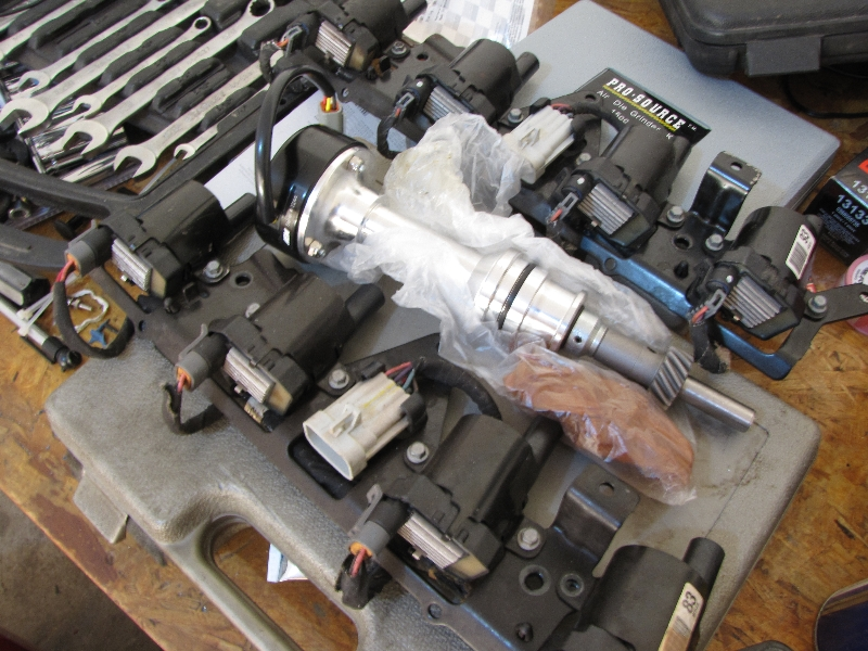

MY main reason for doing this is my MSD dizzy doesn't get along with the AEM...I get timing and sync errors at 4500+ rpm. Aside from fixing that, this setup should run smoother, and the timing will be more accurate. I can also remove my Crane Hi-6 box and TFI module(which I already did). :)
