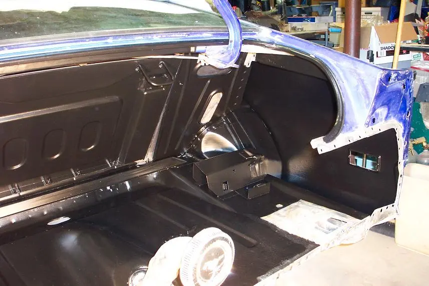

Here's a pic of my trunk with 2 coats of POR-15 and a final coat of Chassis-Coat Semi-Gloss Black.

candy-a-Mach1 said:
REAL, REEAAALLL nice !!!! :nice: :nice:
You da man.
After seeing that, I think that I might go with black in the trunk instead of the exterior color (red). I like it a lot !
What's you exterior color going to be?
Thanks. I'm sticking with the exterior color that the car came with (1999 Honda racing blue) so I don't have to repaint the doorjambs and other hidden stuff. I really like the color. Though if I had painted it originally I would have chosen a Ford blue.
I also decided to use a quality brush, rather than those cheap $#!+ ones. I did a mild cleaning of the brush (using the POR-15 solvent), left it dripping wet and stuck it in the corner of a plastic storage bag and wrapped it so there is no air. Twisted the bag around the handle and twist tied the bag to the handle. Painting with a quality brush is much quicker, easier and gives better results (next best thing to spraying).
I also bought a turkey baster at the grocery store to transfer POR-15 from the can to the container I'm painting from (super cheapo sandwich Tupperware thingies). Helps keep the rim of the POR-15 can clean.
the tupperware sandwich containers rock.
they cost something like $2 for 5 and you can put the lid on then and toss the unused POR-15 in the fridge to use later.
they will only keep for about 6 hours though.
I still really like that color anyways :) When i first saw those POR-15 picts i could've swore you sprayed it on. Those quality brushes are definitely better than the cheapos. It's looking really great there man and thanks for taking all the pictures!

That looks beautiful!
Just out of curiosity, what was your cleaning procedure?
I Por-15'd my trunk months ago, and I'm really happy with the results, but cleaning all that crud off before painting was a real PITA.

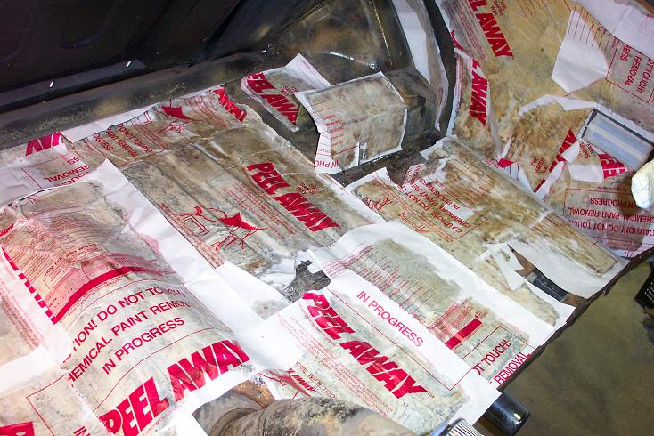

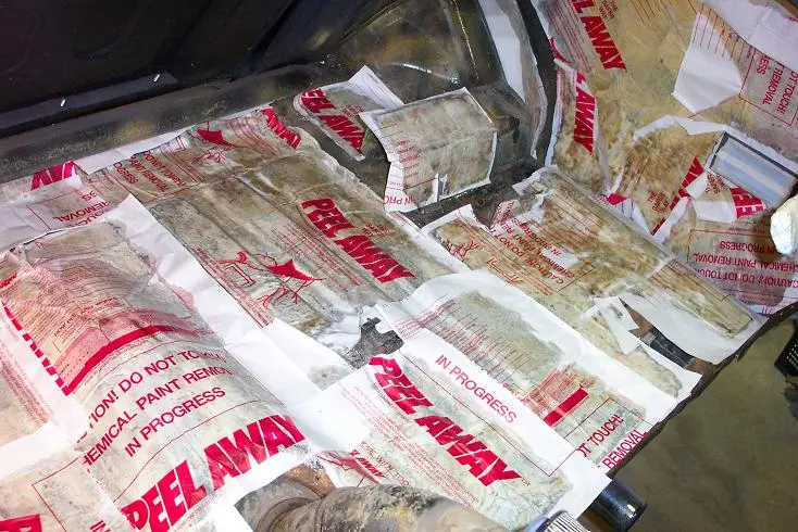

I followed the exact same proceedure as previously detailed on my wheel wells.
I only put the peelaway in places that I knew I could get it back out of. Don't want any of that stuff stuck in the seam between the fender and outer wheel well. After scraping the peelaway goo off, I wiped everything down with denatured alcohol. Since there was a lot of spray on adhesive in there, I used 3M adhesive remover to remove the adhesive from areas that were not treated with peelaway (which was rather time consuming). After that I used various shapes and sizes of wire brush drill attachments followed by the whole POR-15 ritual.

Very very nice finished look.
Question tho. Are you going to leave yours uncarpted? Just wondering since it looks like you went through alot of trouble to get it looking pretty (which it does).

Haven't really decided about the carpeting. That’s quite a ways off anyway. I know I’d like to trunk mount the battery.
