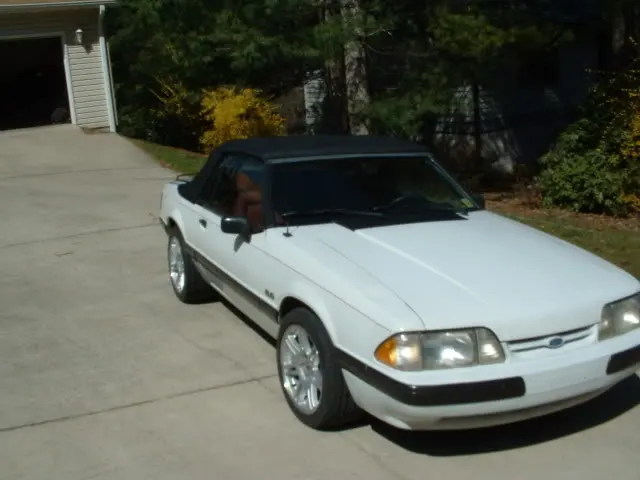

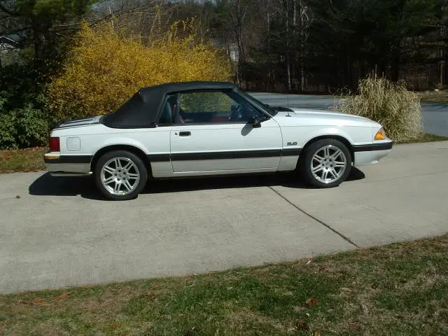

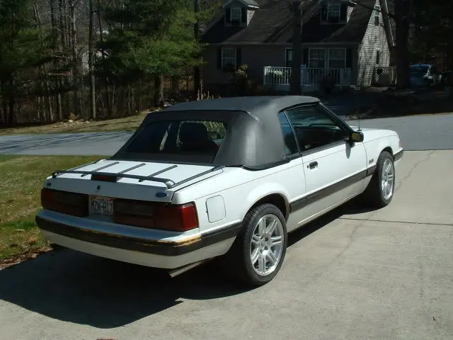

Finally got a nice day so I could take pics of the new wheels...

Wheels look good. The only thing I don't like when i see fox body Stangs with factory 17x9s or 18x9s is that they usually stick out too far in the front, too jeep like. Too bad they didn't have a .5" deeper backspace.

Im not real happy with the front either... I have 98 spindles and with the 98 Gt wheels I was not as bad...Im going to look for a set of 94/95 spindles. Do you have the 94/95 spindles,if you do could you post some pics. Id like to see the difference..

the 94/94 spindles will narrow your stance 8mm on each side. if you still have some room to work between the calipers and the wheels you could have some of the wheel grinded off (where the lugs pass through the wheel) to create more back spacing?
