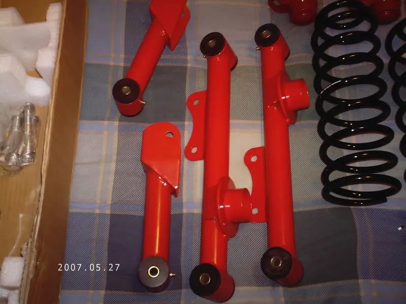

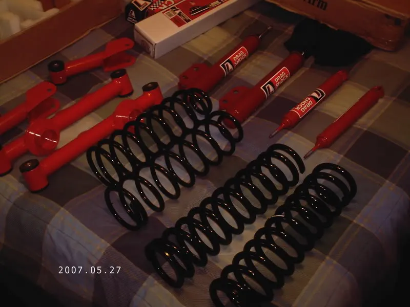

upper and lower control arms for the rear.
got them pretty cheap, like 170$ shipped on corral from a small dealer called muscle motors performance. i am pretty sure they are granatelli, i've heard stories about how these are supposedly junk and will break but they look and feel pretty tough, so i will see how they work out.

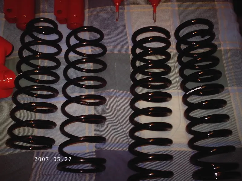

moroso trick drag springs, front and rear.
got these on summit, had a great price, little over 100$ for the fronts and like 80 for the rears, the eibachs were 280. and with these moroso springs i wont have to deal with the airbag like the eibach kits, the moroso rear springs are different. the passenger side spring is shorter with a higher lbs per inch rate than the left, so it will keep the rearend more even and help out launches, it pretty much does the same thing the eibach air bag does without having to mess with it

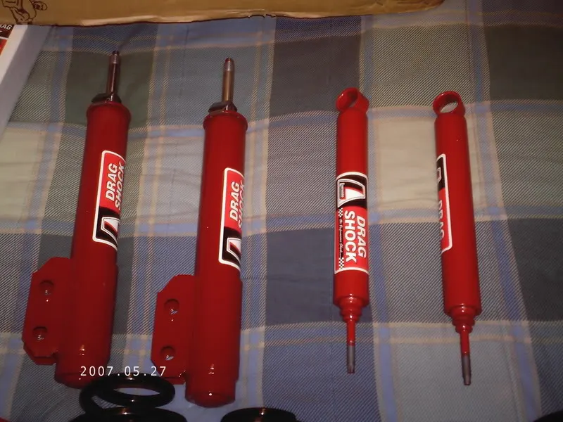

lakewood 90/10 front drag struts and 50/50 rear drag shocks
payed about 100$ for each strut and 50$ for each shock.
the struts should really help my front end come up high, the rears are 50/50 which is about the same as stock IIRC, but they were only 50 bucks and match good with ther fronts lol. plus my current shocks probably arent 100$ anyways

and today i got to putting my suspension on, i didnt get it all done but i got all of the rearend components in, the arms, springs and shocks. took a while but wasnt near as bad as i thought it was going to be, hardest part was probably getting the LCA to line up with the axle mount, and it wasnt that bad either.
with just the rear stuff it seemed to hook real good, didnt spin them nearly as much as before, i can punch at 3k in first and it pretty much hooks, might be spinning them a tad bit but it really puts you in the seat alot better than it did lol
when you shift to second, it doesnt want to spin them there either, it just barks and hooks you can really feel it good.
i have some new quad shocks coming in the next few days, at the moment i am without quads, i wanted to get them spinning to see how the new suspension setup felt under tire sping but it just wheel hopped BAD, the rearend felt like it was running over a bunch of speed bumps at 40 mph gona have to wait for the quads lol
and with the control arms, where the rear sway bar mounts is just a flat piece, the rear sway bar wont go on the correct way, it will fit upside down but to get on the right way it needs to be shorted or heated and bent a little bit, i currently have it on upside down, i duno if that its causing some problems so someone chime in on that.
overall the rear components rock, the car feels alot mroe stable, at highway speed the rearend feels more stable and planted to the road.
and the rear springs also made the car sit up a bit higher in the back, the springs are taller than stock. its not that much of a difference, i think once the springs settle in the next few days it will look better.
