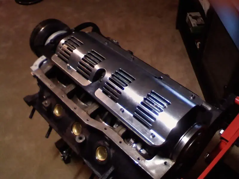

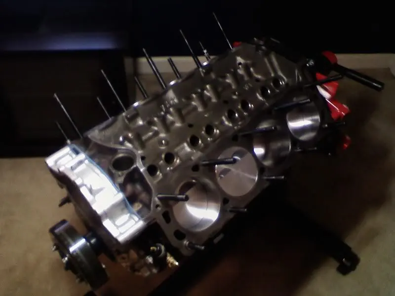

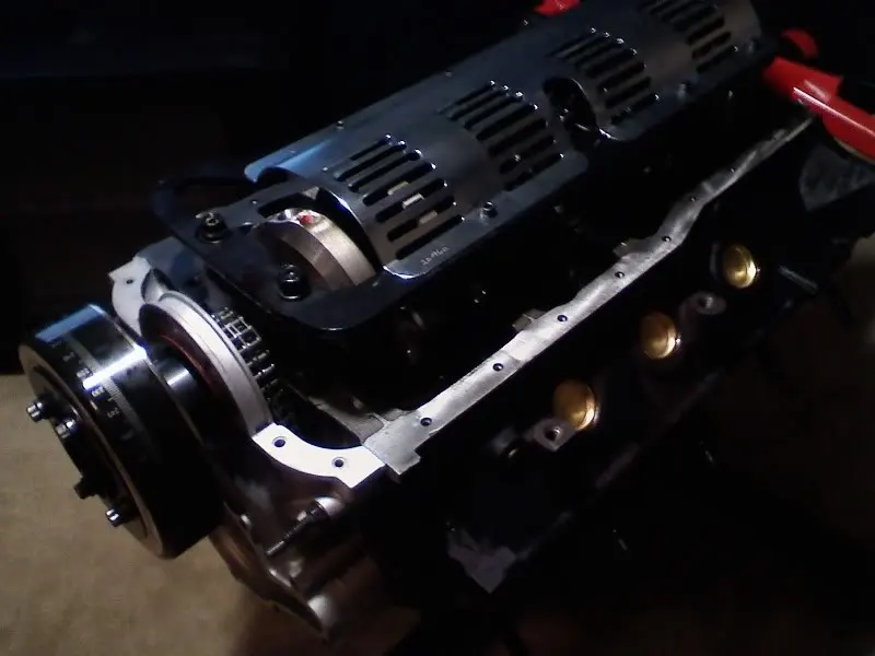

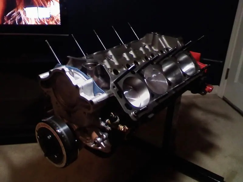

Slowly but surely this motor is coming together. Its a royal pain in the ass modding two cars at once but here is whats so far...
Shortblock:

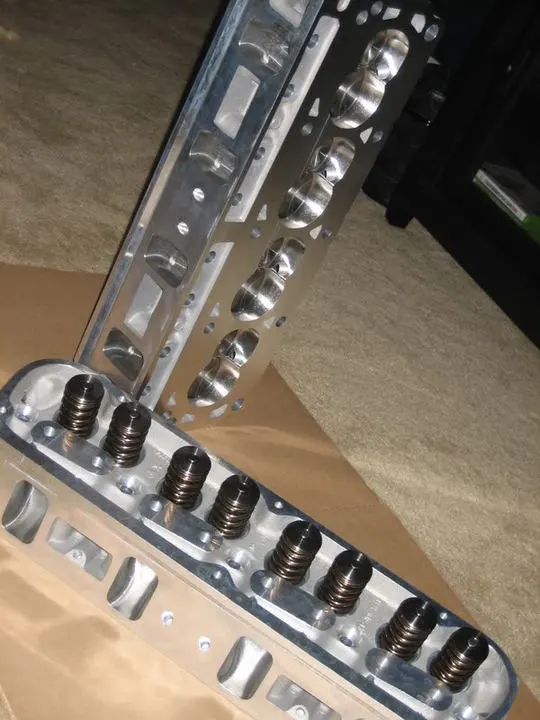

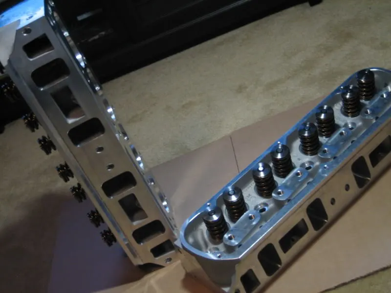

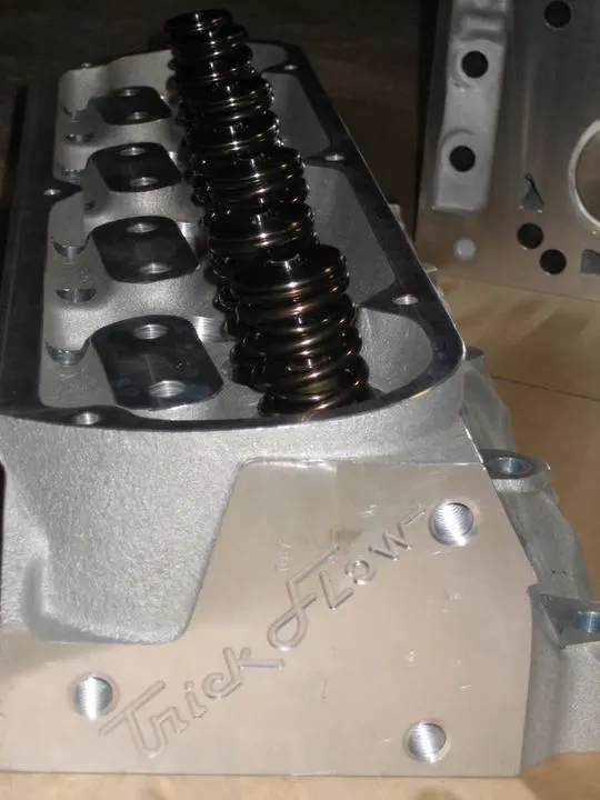

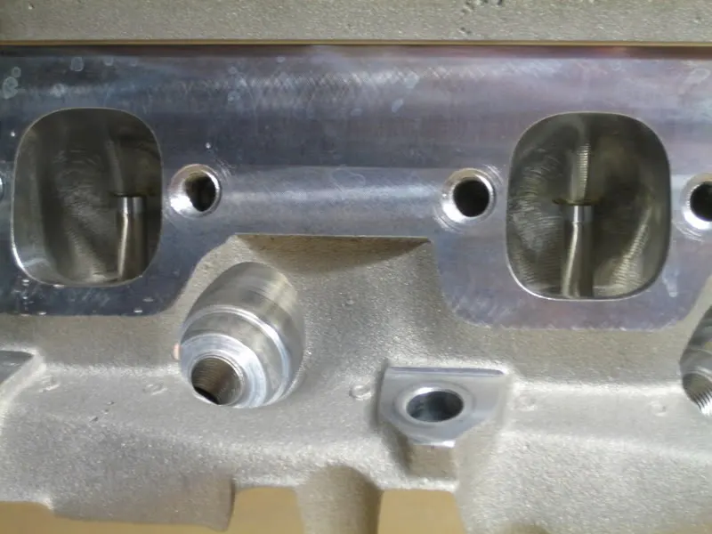

Heads:
Next will be the Precision "race" standard volume oil pump, ARP oil pump studs, CHP hardened shaft, and Canton 7qt oil pan. I will keep updating this thread as the project goes forward. :flag:

I'm spinning this 331 between 7,000rpms and 7,400rpms. Shift point will be 7,200rpms unless my transmission can't keep up in which it will be 7,000rpms. The car will have 4.30 gears in it. The intake will be Trickflow Box EFI intake, 90mm TB, and some 1 3/4" headers with a 3" DR Gas X pipe with 3" Bassani custom mufflers. If it makes less than 400rwhp I'm pulling it back out and putting in the 410W with a 200 shot.
