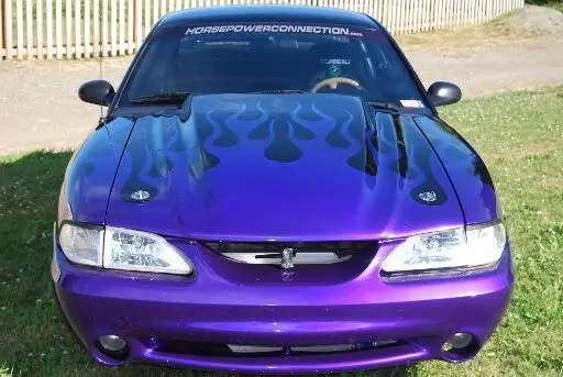

What hood do you have? I have this one below. $500 hood and I did think about trimming it some :nonono: but I'm not sure how much room is between the inner fiberglass and the outer. I would like this to be the last resort. Also what kind of motor mounts do you have? I have poly ones and I know they raise the motor some but they also are allowing my headers to clear my steering shaft so I'm afraid if I change them that will cause another problem. :mad:

Yes I too am running the Poly mounts. As far as what kind of hood I have, Honestly I cannot remember what brand it was. I purchased it over 6 years ago from a shop that went out of buisness.
It was the back of my intake that was touching the back edge of the hood, not towards the front.
This is a 3.5" cowl also.

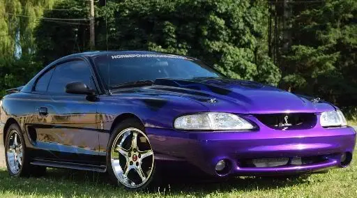

Pics of my hood from last summer:
William
