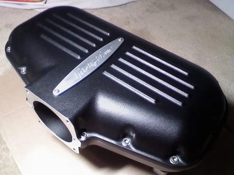

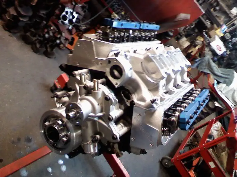

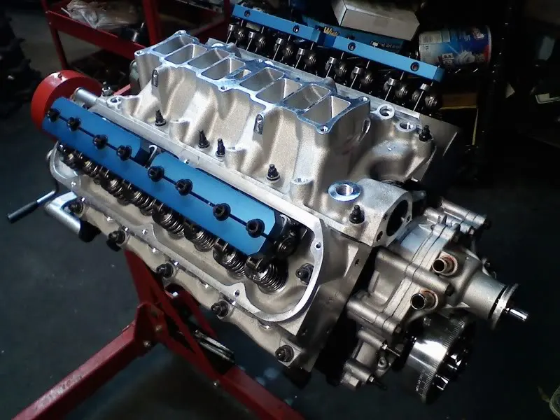

Here are some updated pics...

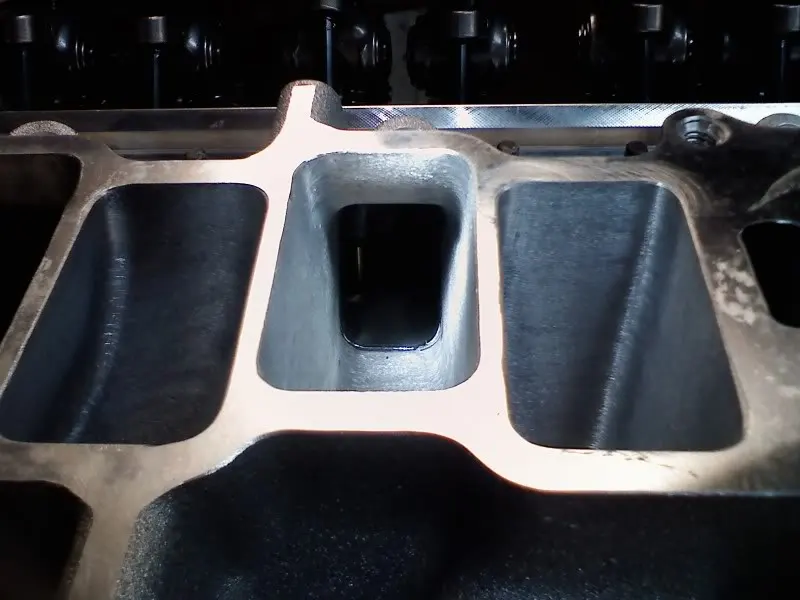

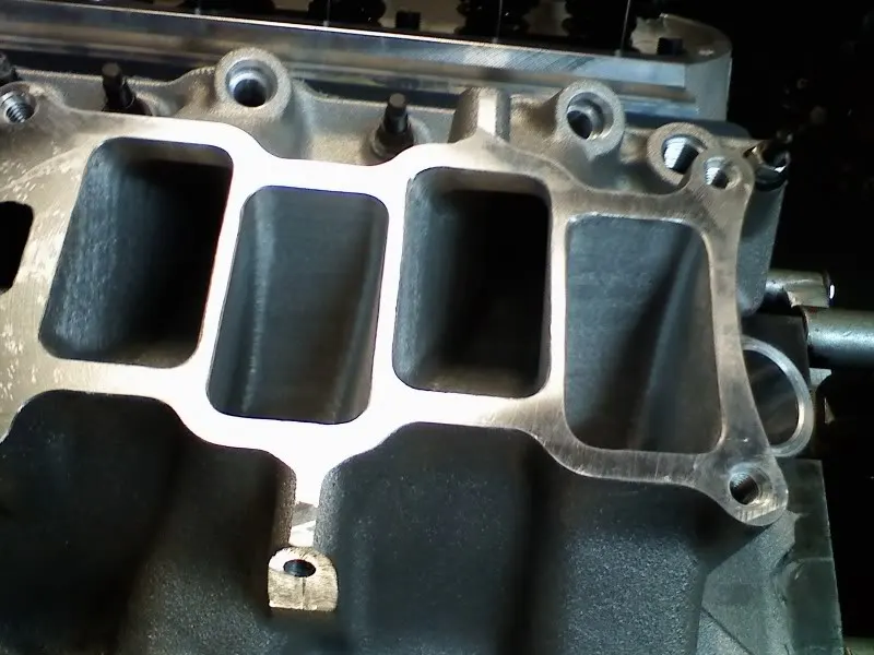

Intake gaskets trimmed and intake perfectly port matched to heads. :nice:

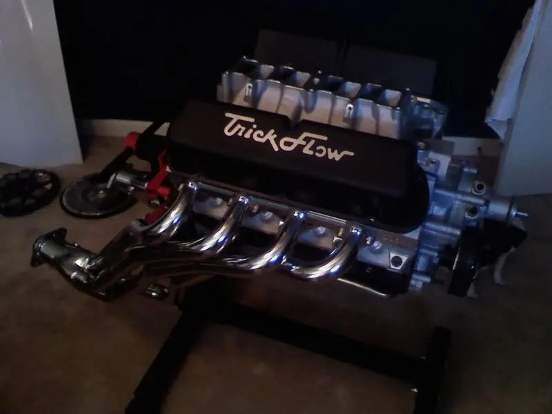

(cowl hood in the background for the intake to clear along with the Spec stage 3 clutch and Spec Al flywheel :) )
Still have to cut the 2.5" ball collector off the headers so I can run my true 3" exhaust.
