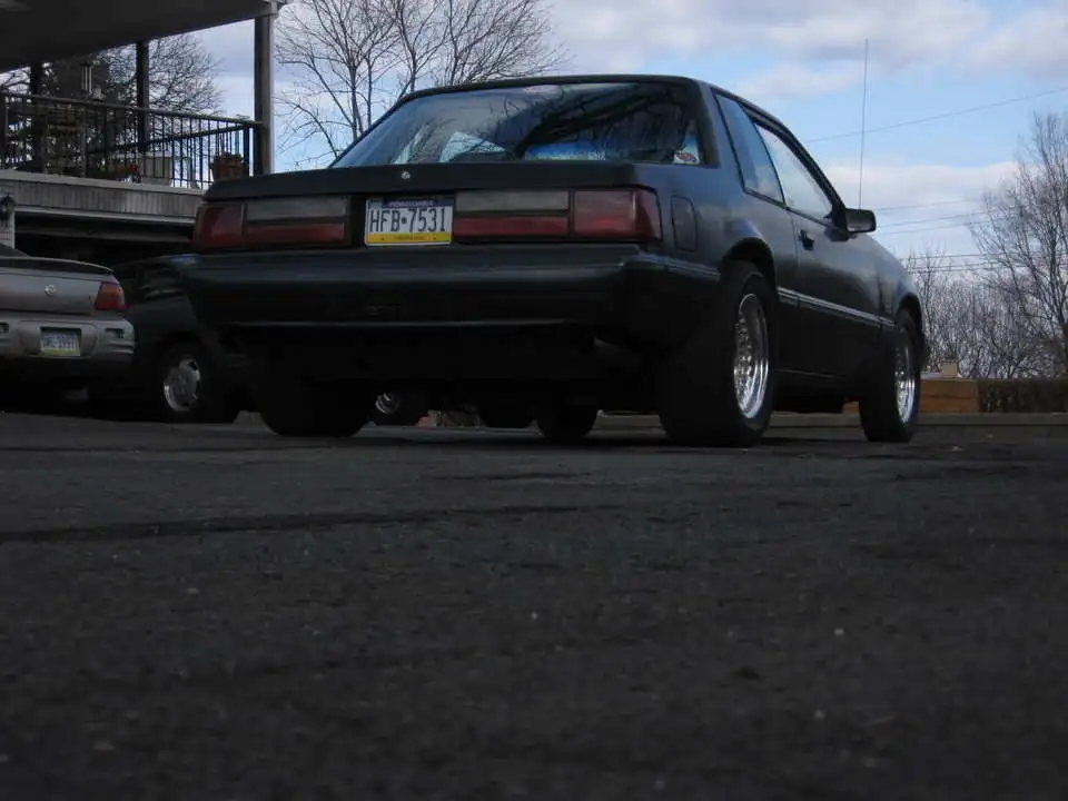

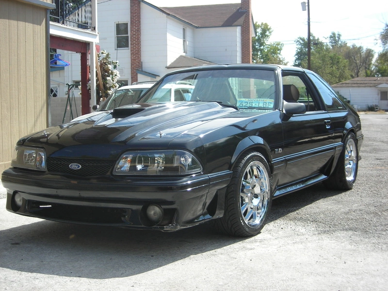

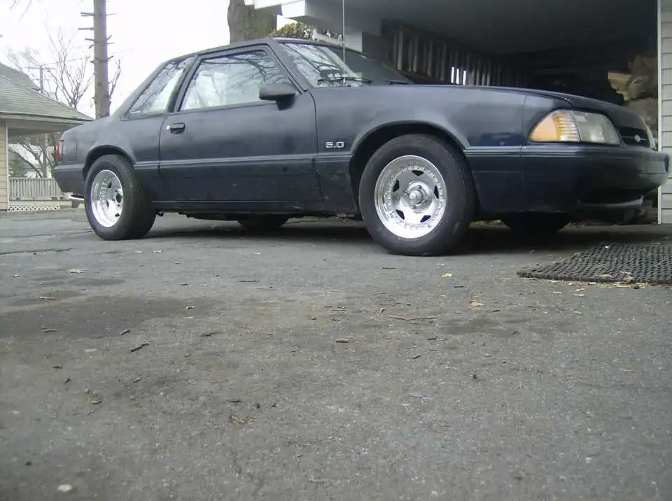

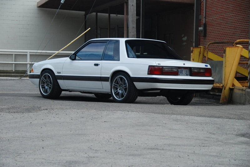

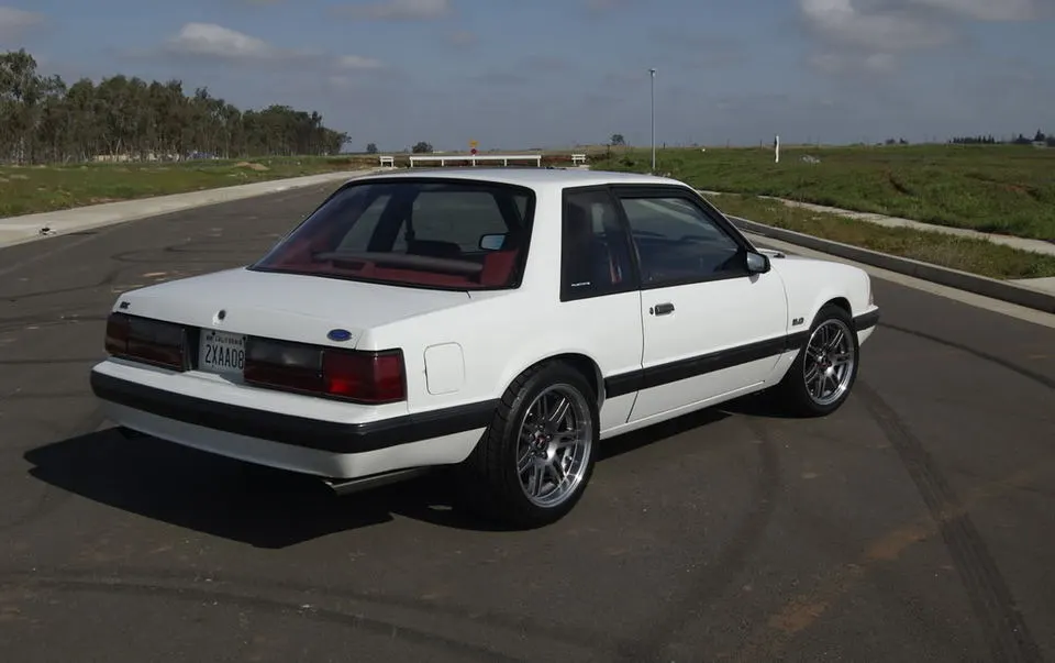

Here's my 91 notch with 17X9 & 17X10 OE wheels 10th anniversary rep's... tires are 255/40/17 BFG KDW2's & 275/40/17 KDW's...
I`m down in Norwalk Marc......but I am sure we will bump into each other this summer. Will you be going to the EFI dyno day?

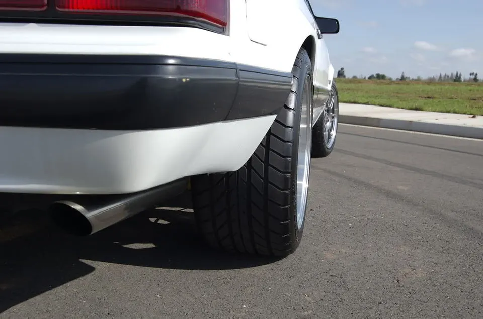

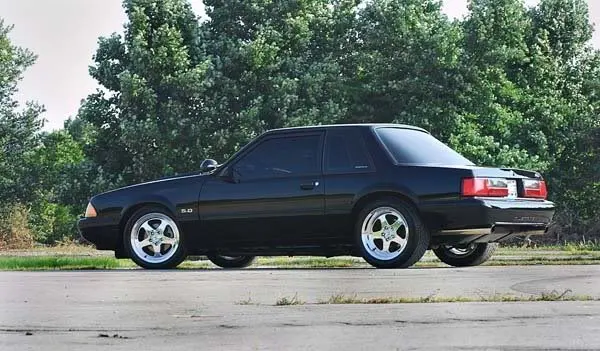

My contribution.
My suspension mods. Bold is the stuff I would change or ####ed up.
Front:
-94-04 13" cobra disc brakes
-94/95 spindles
-Stock control arms w/poly bushings and 94/95 napa brand ball joints I would like to have a control arm that the wheel doesn't rub.
-MM C/C plates
-MM solid steering shaft
-Billstein HD struts
-H&R sport lowering springs
-17"X9" FRPP 03/04 machined Cobras I am not crazy about a 17" x 9" with a stock control arm.
-245/45/17 Firestone wide oval tires This was the wrong tire width for a 17" width. It looks stupid. An 8" rim would work so much better with the stock control arm.
-Poly Sway bars bushings/end links
You can see I am not happy the front wheel and tire combo and the stock control arms. I have 2 rack limiters per side and the wheel still rubs the control arm.
Rear
-MM ED LCA’s
-FRPP UCA’s with new axle side bushings
-Sway bars bushings/end links
-94-04 11.65" cobra disc brakes
-Billstein HD shocks
-275/40/17 Firestone wide oval tires
The rear tire would not fit even with the quads flipped. I hope I don't have wheel hop.
18" bullits
What would you change about the rear tire? Just a smaller width tire? The wheel size is fine right? Whats your offset?My contribution.
