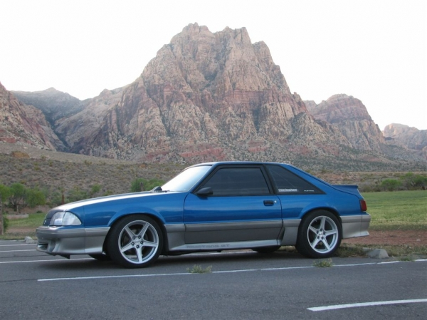

My 89.. Saleen springs, KB Trackit brackets in the rear (lowers additional .5")
Thats about exactly how i want my car to sit.... Could you explain a little more about the trackit brackets as in, where do they attach, is modding anything needed... the reason i ask is i have mega bite jr LCA's, and boxed uppers, is that going to allow me to use something like that, or is it designed for stock LCA's?
Also, are there different types of the saleen springs, or do they only make 1 for the fox body?
The brackets relocate where the lower control arm mounts and yes you have to redrill the rear mounting point. They should work with any lower control arm and are supposed to help with traction, but I just wanted to lower the rear about 1/2" without cutting the spring. KB is (was) local to Indy, so I got them along with their lower control arms. I have pictures somewhere, or I can take some this weekend.
