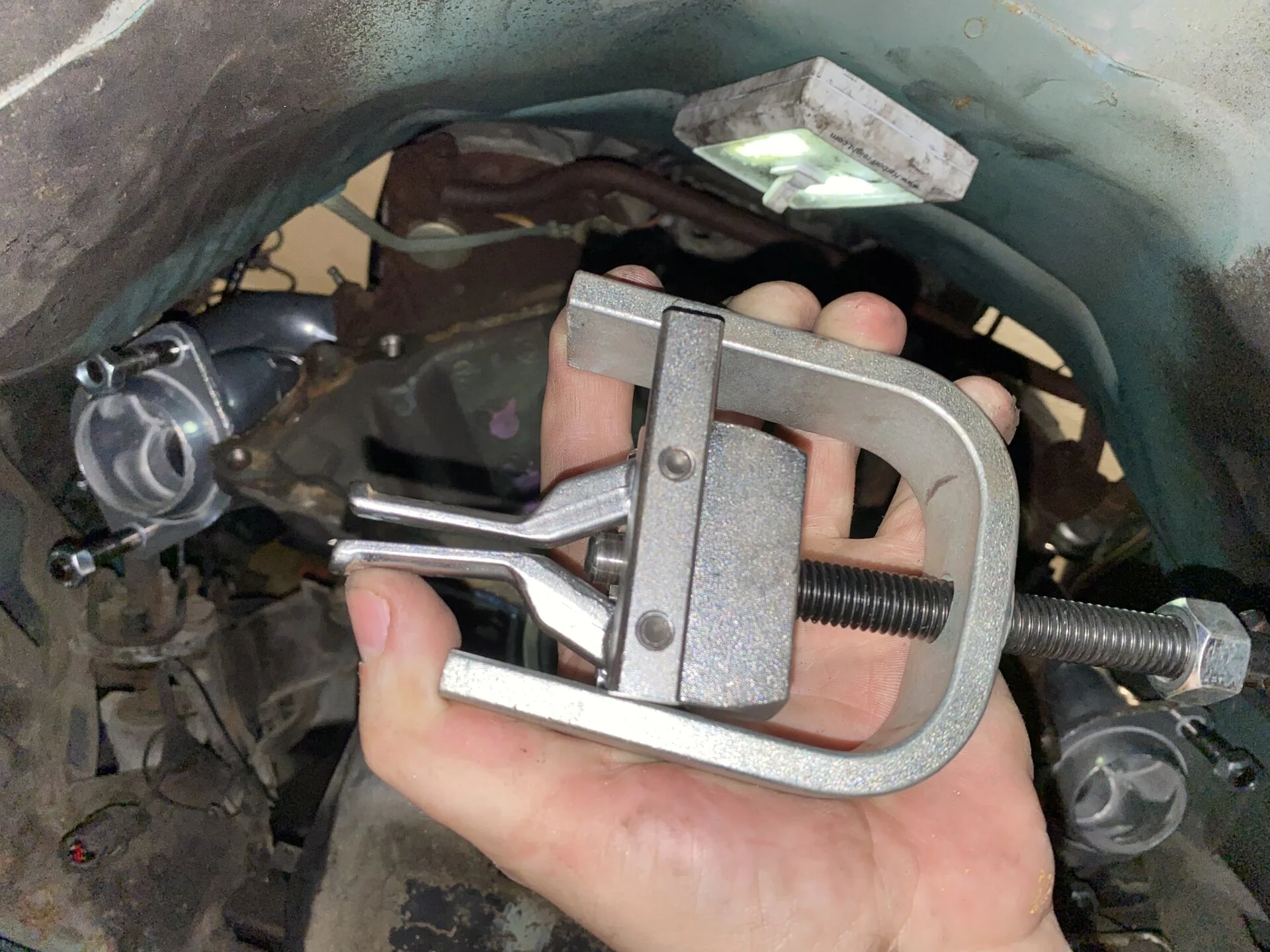

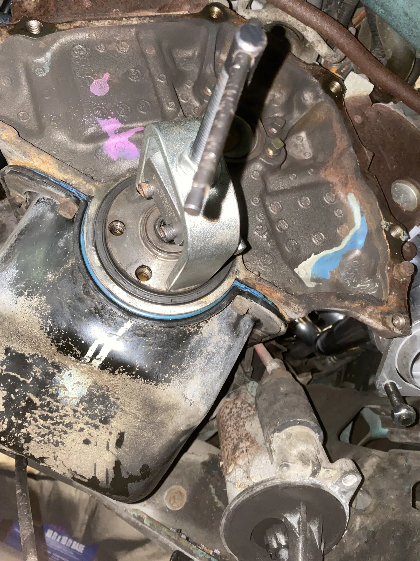

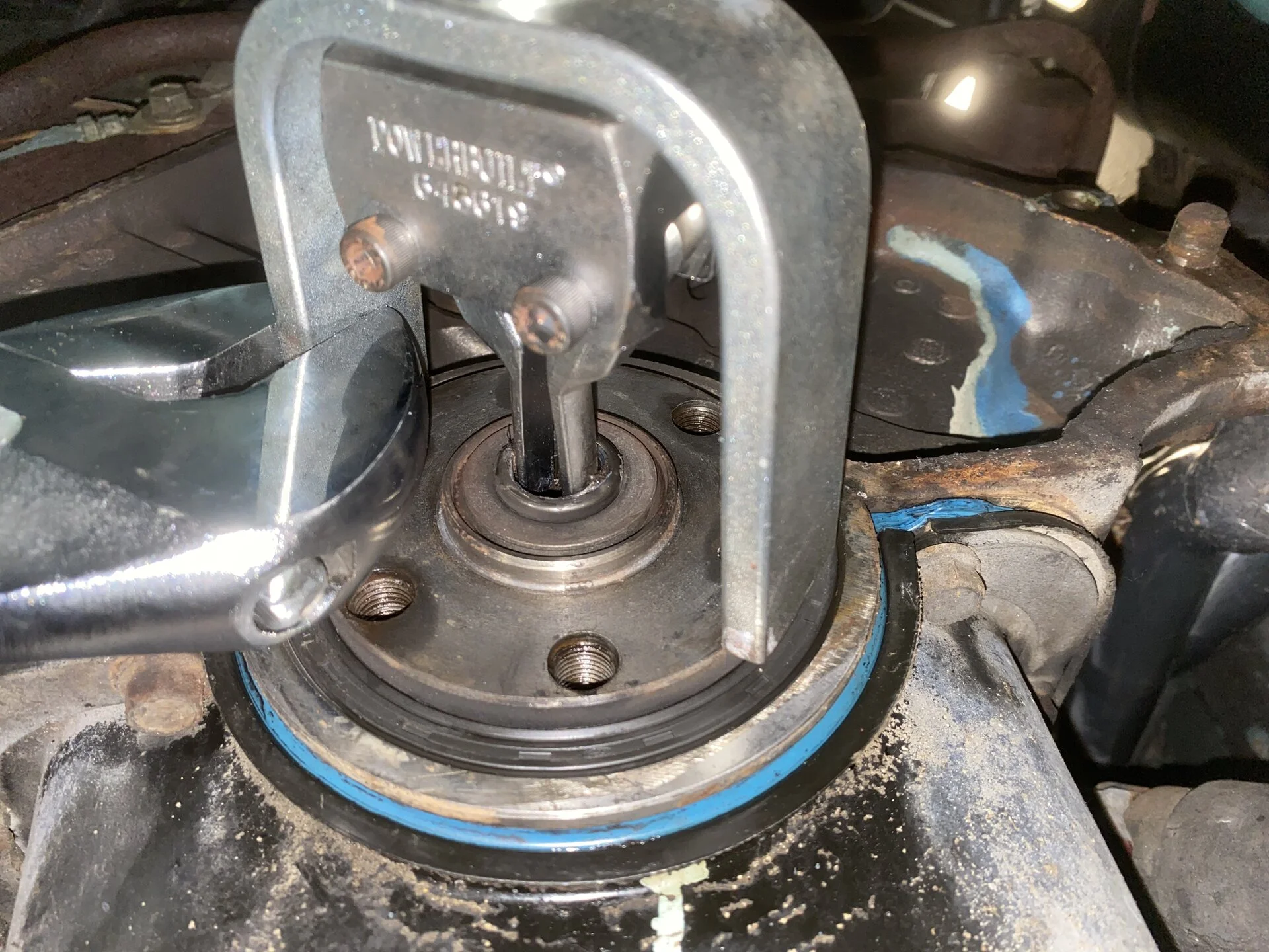

However, typically I use the rent a tools from parts stores, but the slide hammer puller were out.
So I tried the U puller and no luck as it started to walk/flex.

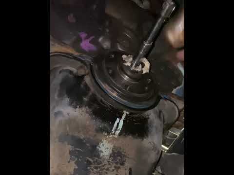

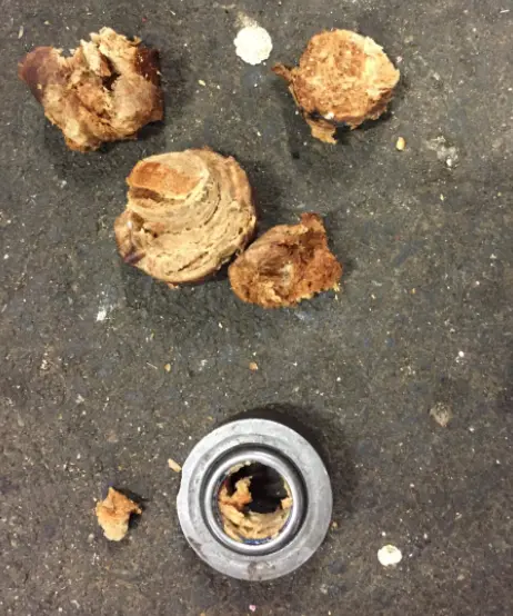

This worked for me.
Three pieces of bread,
3/8 drive 7/16 chrome socket
(packed inside with bread)
3/8 an extension
hammer.
