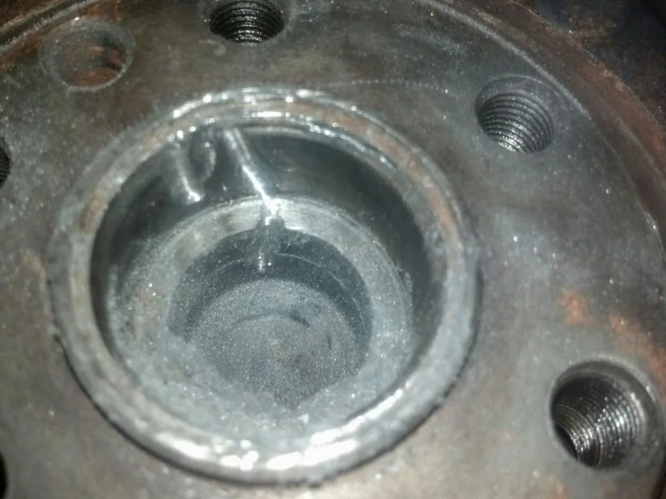

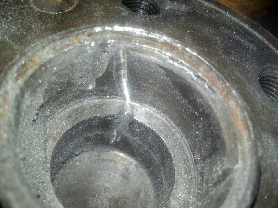

So ive changed 3 clutches throughout the time ive had my mustang and every single time i have to grind the pilot bearing out with a dremel tool. Ive tried the puller and it snaps every single one of them. ive also tried a bunch of other tricks and it will not budge. Well after getting it out this time i realized i accidentally grinded into the crankshaft a little bit. Is this going to cause a problem?

Can you take a picture of the damage so we can see how much material was removed?
Yeah ive tried that trick it didnt work. Heres some pictures of the damage

i wonder if maybe some JB weld could fill it in and then you could CAREFULLY smooth it out so the pilot bearing can securely fit back in. You might get some vibration on the higher rpm's if you don't.

Alright, i swear i was grinding into the bearing. i even stopped several times to whack at it to see if it would budge so that i wouldnt grind into the crankshaft. sitting under a car with one light isnt the best way to do it i guess. Ill give it a try. Would you guys know why the bearing would be so hard to get out? Last time I also had some troubles getting the transmission to slide all the way through. i had it about 3/4 in and then it just stops. I had to push the fork in with my foot while i pushed the transmission and then it slid it.

Be very careful with the JB weld as you do not want to decrease the diameter of the opening. Wondering if maybe some right stuff would work.

The problem with the crank is that if it is subject to a lot of shock loading, like dumping the clutch on launch or full throttle, never lift to shift driving, that the place you ground into the crank is the first place the crank will start to fail.
If you don't replace the crank, you better invest an a scatter shield bellhousing before you ever consider racing the car.

The [USERGROUP=77]@SN Certified Technician[/USERGROUP] jury is still out, but this is my call:
The grinds will focus the crankshaft stress along their length. I would expect a crack starting at the outermost grind point and radiating outward into the crankshaft flange Then the crack would propagate towards one or more of the flywheel mount bolts.
Without the scatter shield bellhousing, a few drag strip full throttle runs will result in the crank letting go of the flywheel/clutch assembly. That does not discount the possible loss of the right foot or maybe just some toes if you are lucky.
