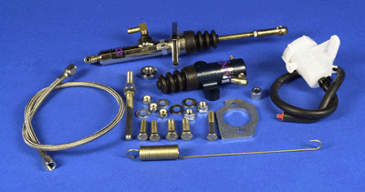

I am putting a hyrdaulic clutch in my kids' '65 289 manual transmission car. Front discs are the basic Stainless Steel Brakes Company's 4-piston factory-like kit. Rear drums are stock.
I am running into an interference problem between the hydraulic clutch master cylinder and the 7" booster of the Trans Am Racing dual reservoir MC pdb kit that I had put in. Here's a pic of the clutch MC:
I need to raise the booster to clear this clutch MC. I saw this pic of a bell-crank booster that mdjay was considering cannibalizing:
I also saw that PM 65 says he has a similar-looking bellcrank booster that he got from NPD, pn 2005-20FB, for his 4-wheel discs. I see that NPD has one for "MT, disc, with dual res. master cyl" pn 2005-20EB.
Well, to cut to the chase, I am thinking that I need a bell crank booster. I can't use a unit with a straight-in pushrod, because that requires the centerlines of the booster and the brake MC to sit too low.
