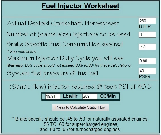

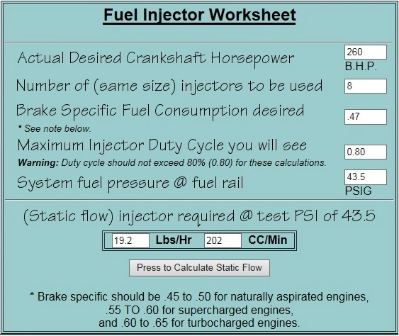

Um, are you using the picture that this Paladin put up as your reference? All I can say is LOL.
I asked for proof that is not something that some yahoo wrote an put up.
But, I'll play your game anyway. I will make this even more basic.....
1) Bosch Pink top injectors were NEVER rated at Ford's pressure standards. That is 40 psi. Bosch tests with lower specific gravity heptane for testing.
2) The Orange Ford injectors, made by Bosch, were NEVER tested at Bosch or Chevrolet's standard pressures of 3-bar (43.5 psi) and 4-bar (58 psi). Ford also tests with gasoline, not heptane like Bosch.
What does that mean? It means that unless you convert them to equal pressures and equal specific gravityies, YOU CANNOT COMPARE THEM! So, lets put them at the same pressure and gravity. I did that, and you did not accept it. I put them at the Ford rating of 40 psi, showing that the Pink injectors still flow 19 lb/hr at 40 psi. Now, to make you happy, I will say this. The Pink top injectors flow 21 lb/hr at 43.5 psi of Heptane. If you increase the pressure on the 19 lb/hr injectors and switch them to Heptane, I bet you can't guess what they are going to flow? Nope, 21 lb/hr. That is really irrelevant anyway since Ford uses 40 psi anyway.

Call ford, Give them the part number on the pink injector, see what they tell you. If they say it's a 21lb injector, then i'm going to call it a 21lb injector. Agree to disagree. I understand that it doesn't FLOW 21lbs because of the pressure difference but it doesn't alter the fact that it is rated 21lbs @43.5psi. When you call a parts store and need a 24lb injector, do you say, "i need a 24lb injector but it's on a ford that only uses 40psi fuel pressure so I really need a 21lb injector? No. I am just calling it by how it's sold. I am sorry to have made you mad about this.
You have not made me mad, this is something that I know a LOT about. I am not going to disagree that the Pink injectors are "labeled" as 21 lb/hr injectors. I am saying that you CANNOT COMPARE THEM without balancing the pressure one way or another. When you do, you realize that they are EXACTLY the same.
The bottom line.... YES, the Pink injectors are LABELED as 21 lb/hr injectors, and Orange injectors are LABELED as 19 lb/hr. But for use on a Ford Mustang GT, when they are installed, they perform EXACTLY the same. They flow the same, support the same amount of power.
